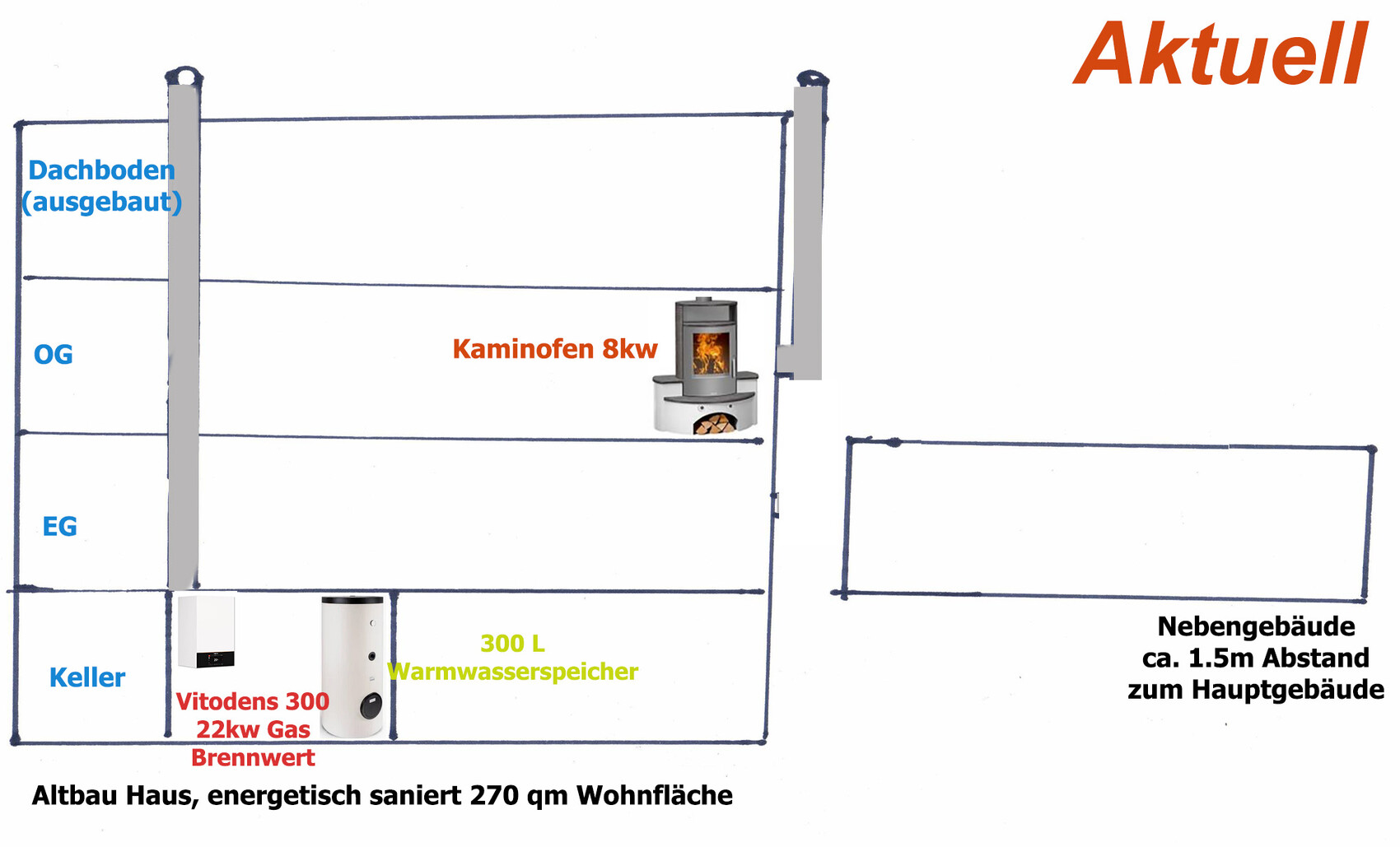

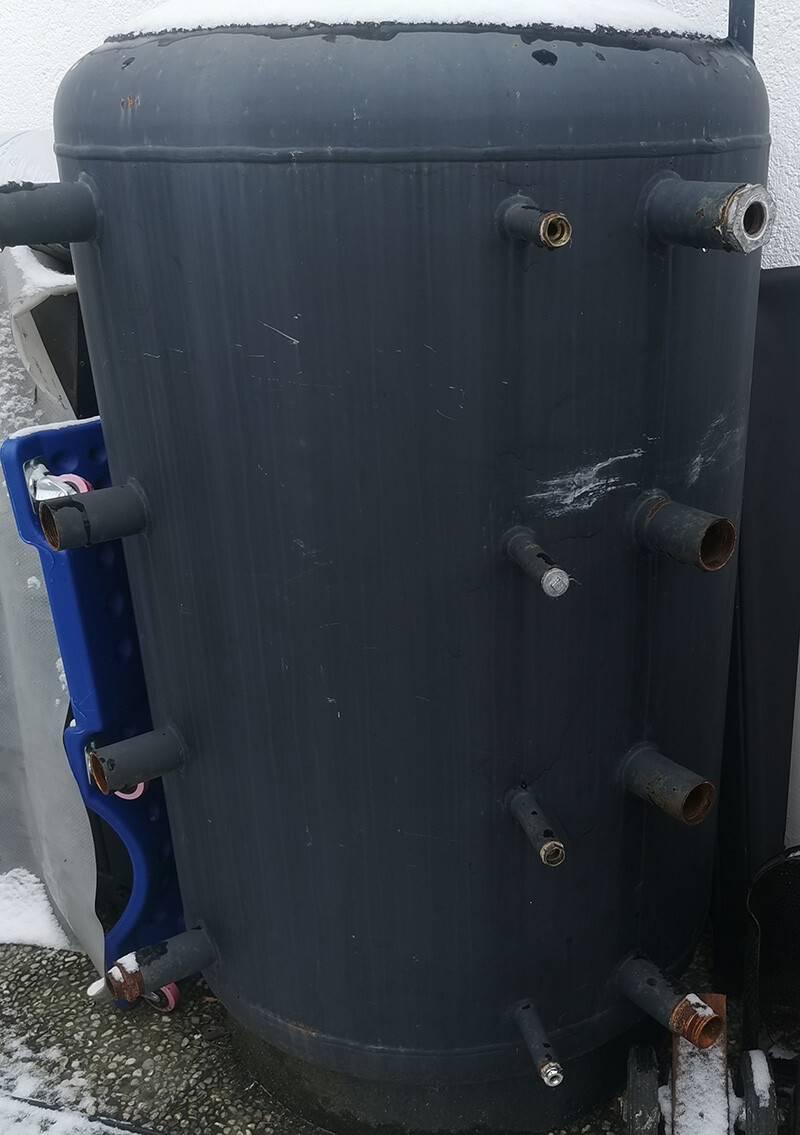

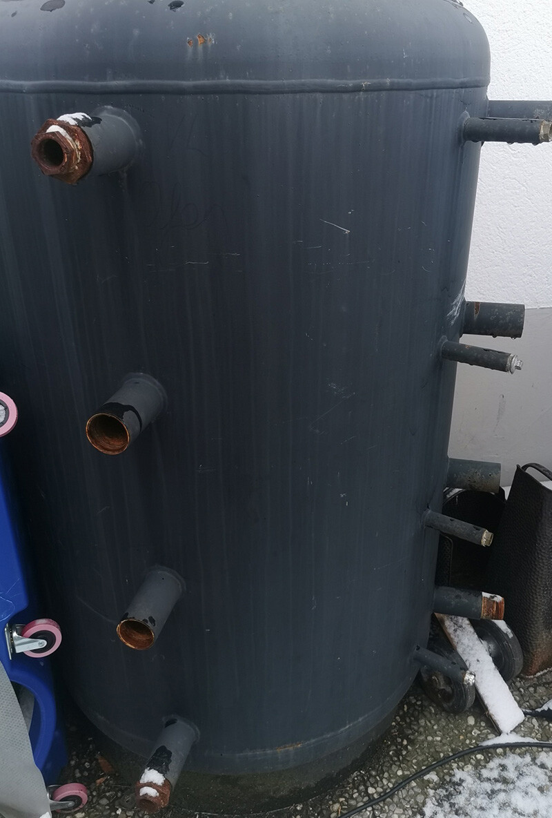

I am attaching sketches of the current and planned setups, as well as pictures of the buffer storage tank.
Currently, we heat our house (an old building from 1930 with an extension from the 1970s) with a Viessmann Vitodens 300 condensing boiler connected to a simple 300 L (79 gallons) domestic hot water tank. Additionally, there is a wood stove with an external chimney.

- I would like not to have to reload the wood gasifier constantly but rather bring the buffer tank up to temperature once a day. Are 550 L buffer tanks sufficient for 270 m² (2,906 sq ft) of living space? If not, how many liters would be recommended?
- Is the buffer tank suitable for this setup in terms of connections? Unfortunately, I have no data on this. It came together with one of the water-jacketed stoves. The flange still has three inlets and outlets. For example, I do not know if it is suitable for domestic hot water production (it of course has insulation, which is not shown in the photos). I would also appreciate alternative purchase recommendations.
- I assume that the current 300 L (79 gallons) tank can be removed completely, as it will no longer be needed? Or will I need a tank for domestic hot water in the future, with the buffer tank only used for heating water?
- Is it advisable to place the buffer tank in the outbuilding or would it be better located in the basement next to the gas boiler? Or does the location not matter?
- How / by which device (controller?) can the system be set up so that the gas boiler starts automatically when the temperature in the buffer tank drops too low? The gas boiler should remain as a backup in case the stoves, wood gasifier, and solar thermal system fail to provide sufficient heat for any reason.
- What share of the energy supply can the solar thermal system roughly be expected to contribute?
- Now a difficult question: approximately how high might the costs be for the connection work / piping?
Thank you very much and best regards,
Josef
