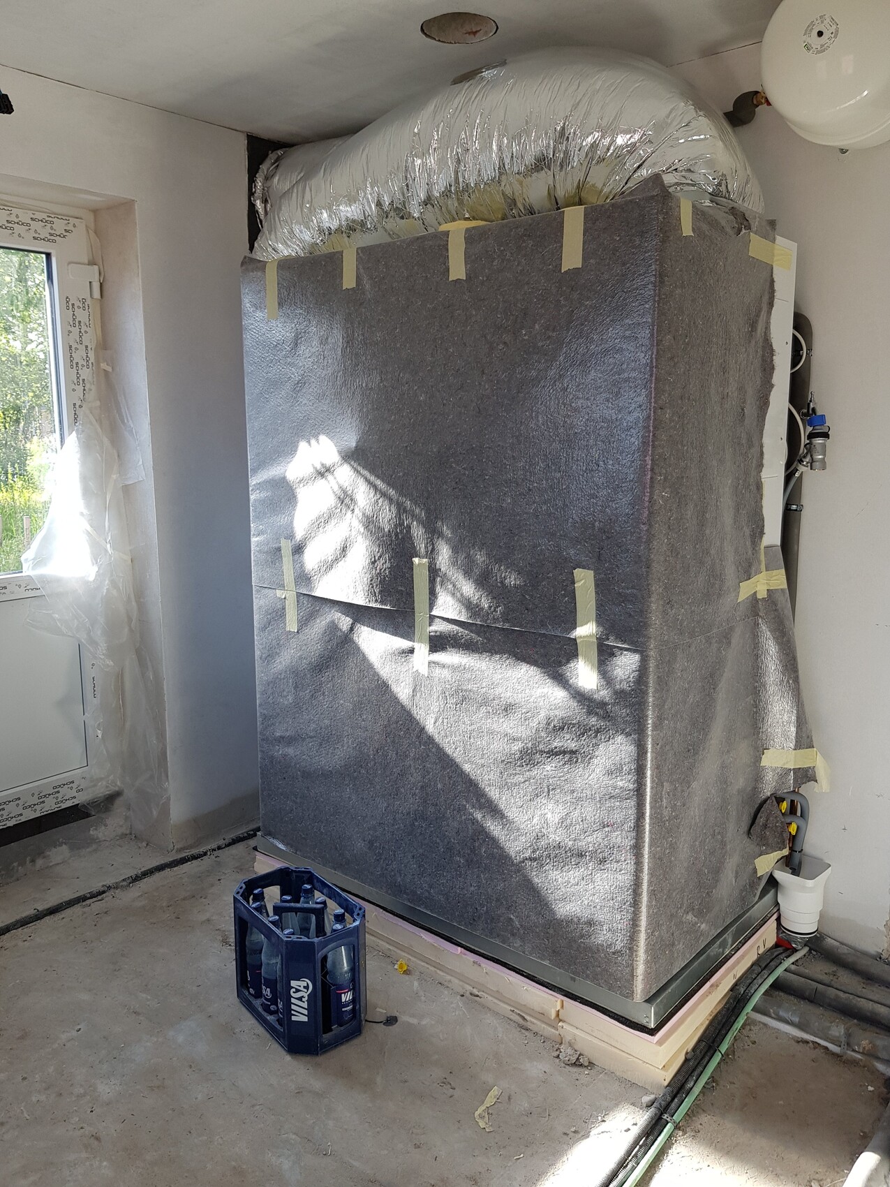

There are all-in-one units designed for indoor installation, but they are quite bulky. However, if you have enough space, they could work. I believe noise shouldn’t be an issue with proper decoupling.
