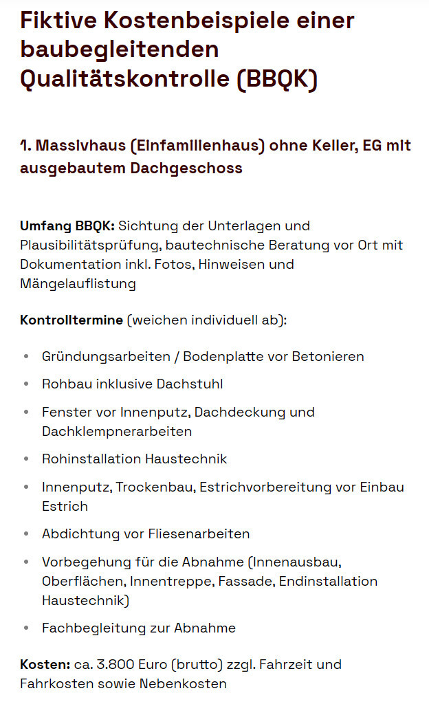

nordanney24 Jul 2024 14:20Fabian3000 schrieb:
But I would have to pay for that separately again... You will pay for it anyway – it’s part of phase 8 services with the architect or an expert during construction with the general contractor (although the expert’s fees are only a fraction of the architect’s – the architect accounts for about one third of the total invoice, since many trades need to be coordinated and supervised).

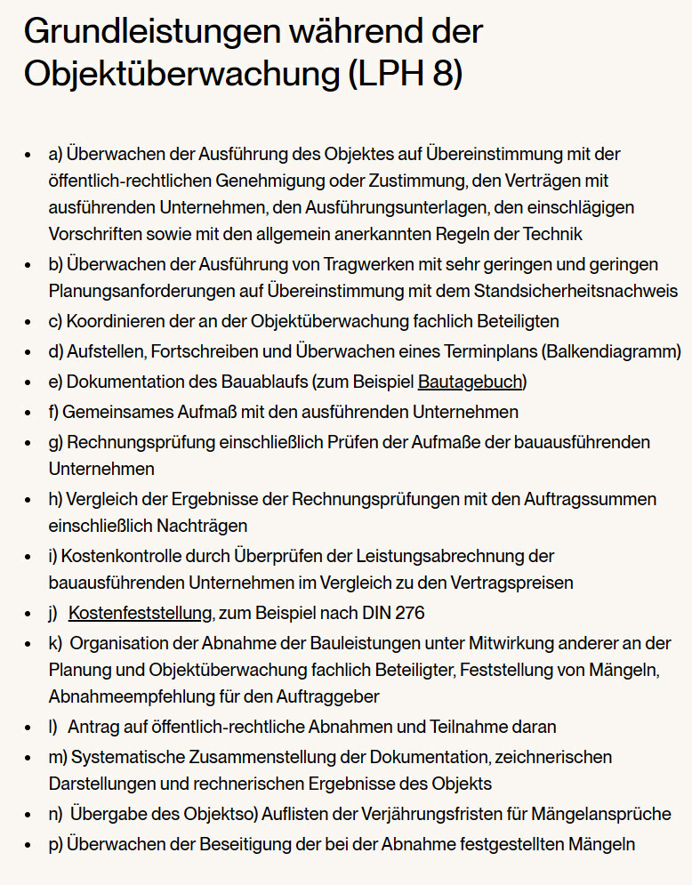

Comprehensive package from the Homeowners’ Protection Association (just as an example):
F
Fabian300024 Jul 2024 14:31So the cheapest option would be to do phases 1-7 and then have an expert inspection, right? However, the inspection might not be as effective because the expert would need to spend a lot of time familiarizing themselves with the detailed construction plans. Would that be acceptable?
nordanney24 Jul 2024 14:40Fabian3000 schrieb:
So the cheapest option would be to cover phases 1-7 and then hire an expert, right? Cheap yes, but not practical.
Phase 8 involves much more than just supervision:
If you have the professional skills and time to handle the most challenging part of an architect’s responsibilities and only need a third party to check quality, then you can do it that way—for example, site management, invoice verification, etc.
Fabian3000 schrieb:
But the supervision wouldn’t be as effective since the expert would need to spend a lot of time familiarizing themselves with the execution planning, right? Would that be acceptable? For me, that’s a no-go—see above.
