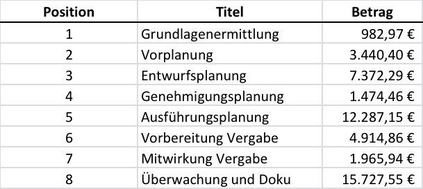

So, dear forum – the offer from the preferred architect has now arrived.
It is a calculation according to HOAI, Fee Zone III, and is structured as follows:
The billable costs amount to 380,000 euros net.
For energy consulting services (the architect provides these themselves), an additional €4,975 applies.
Additional costs amount to 3% of the contract sum = €1,594.22 (this likely covers travel, postage, etc.; is this reasonable?)
In total, this amounts to €54,734.84 net. After deducting a 15% discount, the net total is €46,524.61, resulting in a gross final sum of €55,364.29.
What do you think? What stands out to me is that work phase 9 (LPH 9) is not included – what could be the reason for this?
Best regards and have a nice weekend!
askforafriend schrieb:
So dear forum – the offer from the preferred architect has now arrived.
It is a calculation based on HOAI, fee zone III, and is structured as follows:
The eligible costs amount to 380,000 euros net.
For energy consulting services (the architect does this personally), an additional 4,975€ applies.
Additional costs are calculated as 3% of the contract sum = 1,594.22€ (this likely covers travel, postage, etc.; is that reasonable?)
In total, this amounts to 54,734.84€ net. After applying a 15% discount, the net total is 46,524.61€, which corresponds to a gross final amount of 55,364.29€.
What do you think? One thing I notice is that service phase 9 is not included – what could be the reason for that?
Best regards and have a nice weekend! Since HOAI has been only a guideline since January, negotiation is possible here.
Overall, the fee is not cheap compared to the construction costs but not excessive either.
Service phase 9 is usually never carried out.
Research the topic of architect/contractor warranty.
You will find the reason, which is related to the balance between compensation and liability.
If the architect appeals to you both instinctively and in terms of philosophy, why not 🙂
PS: There are HOAI calculators online. Just calculate it yourself.
Malunga schrieb:
Since the HOAI has been only a guideline since January, negotiations are possible here.
Overall, the fee is not cheap compared to the construction costs, but also not excessive. The values correspond exactly to the HOAI rates according to the calculator – but with a 15% discount. Are other architects cheaper than HOAI minus 15%? If yes, we would still build with him (but not with discounts of 40% or more).
Malunga schrieb:
Phase 9 (completion phase) is usually never done.
Read up on the topic of architect/contractor warranty.
Then you will find the reason. It is related to the earnings/liability ratio.
Understood!
