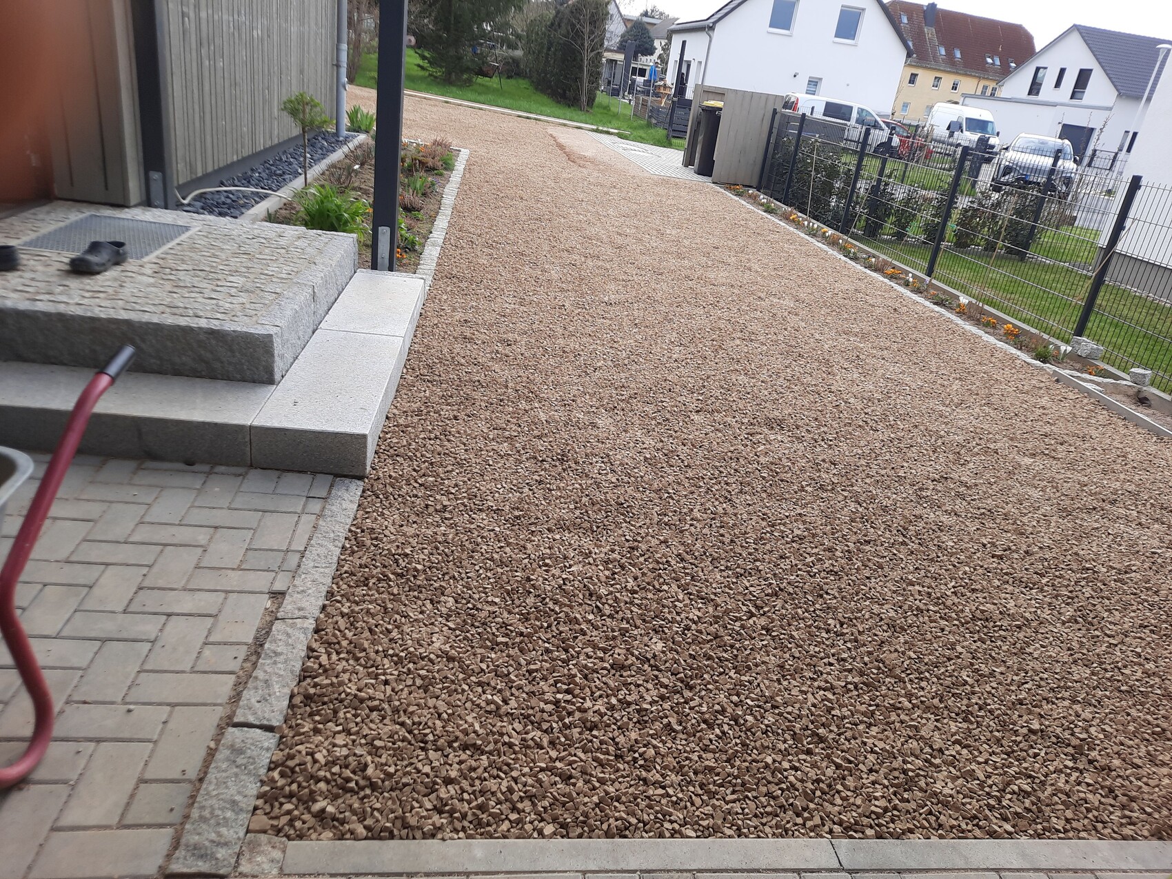

I believe your example photo shows a water-bound surface, which is constructed quite differently compared to a gravel area with cells. It also isn’t necessarily suitable for a parking lot.That’s correct; here it’s often called a "Saxon water-bound surface." There is plenty of information online about it, including its challenging maintenance and upkeep. We had such a surface in front of our house and in the garden. First of all, our professional didn’t really know much about it because it requires a specific structure. On top of that, it was almost impermeable when it rained and the water couldn’t drain properly, which we urgently needed to fix. So we scraped out about 7cm (3 inches) of the fine material with a shovel, which was sometimes difficult, and replaced it with the same base material but with a different thickness (I would have to check exactly what it was or you can search the forum for my description). I also shared some pictures here recently.
We have two electric cars and really like the new driveway, especially since we didn’t want to use paving stones and the light brown color looks nice. The delivery truck dumped the material, and we spread it about 7cm (3 inches) thick with a wheelbarrow and then compacted it with a vibrating plate. We find it very practical to use and would definitely do it again. It also only cost a few hundred euros for a very large area.
You can see tire tracks, and occasionally a few stones on the street, but none get carried into the house since these are larger stones that don’t stick to shoe soles. The water drains very well, and the now rare weeds can easily be pulled out; the previous surface always looked unattractively mossy.
