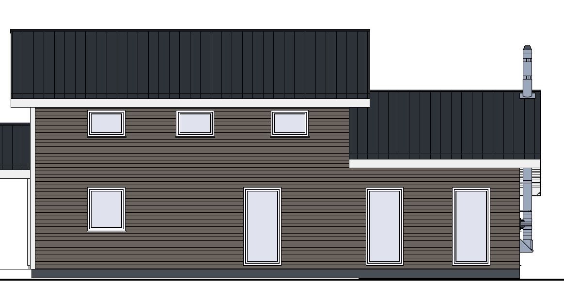

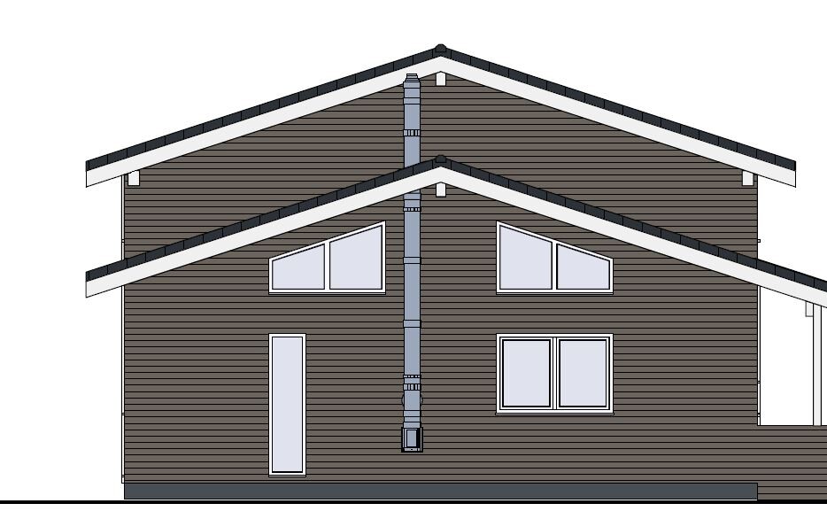

Attached are the exterior views from the west and north, showing the 6 windows in the living/dining area. On the south side, there are 2 more windows in the dining area. Is that too few?
Yes, that would be too little for me. The living space might become bright thanks to the gable windows, but from the sofa, you only see the wall except for the narrow slit window. I also think the bedroom is missing a window. Upstairs, I am concerned about dark rooms as well. The windows will also be shaded by the roof overhang.
In my opinion, the staircase doesn’t fit well with the upper floor, and the first steps overlap way too much.
Why is the office almost as large as the two children’s rooms combined?
The master bathroom is 11 m² (118 ft²) for a washbasin, toilet, and shower, but the shower itself isn’t even really that big. And why is the utility room accessed from there?

neo-sciliar24 Aug 2020 15:30kbt09 schrieb:
In my opinion, the staircase doesn’t fit well with the upper floor, especially since the first steps overlap too much.
Why is the office almost as large as the two children’s bedrooms combined?
Master bathroom... 11 sqm (118 sq ft) for a washbasin, toilet, and shower, but the shower is not even really spacious. And why is the utility room accessible from there? The issue with the staircase comes from the planner. He says two steps can be built over.
The office is a multifunctional room; the name alone doesn’t cover it (office, as well as a guest room and a TV spare room. There’s also storage space here). The children’s bedrooms are now just bedrooms, as the “children” no longer spend time there.
We had a long discussion about the door between the bathroom and utility room. The downside is the space requirement in both rooms. The advantages are that you’re no longer forced to go through the bedroom to get to the bathroom (if someone is still sleeping), and the short way from the bathroom to the washing machine.
