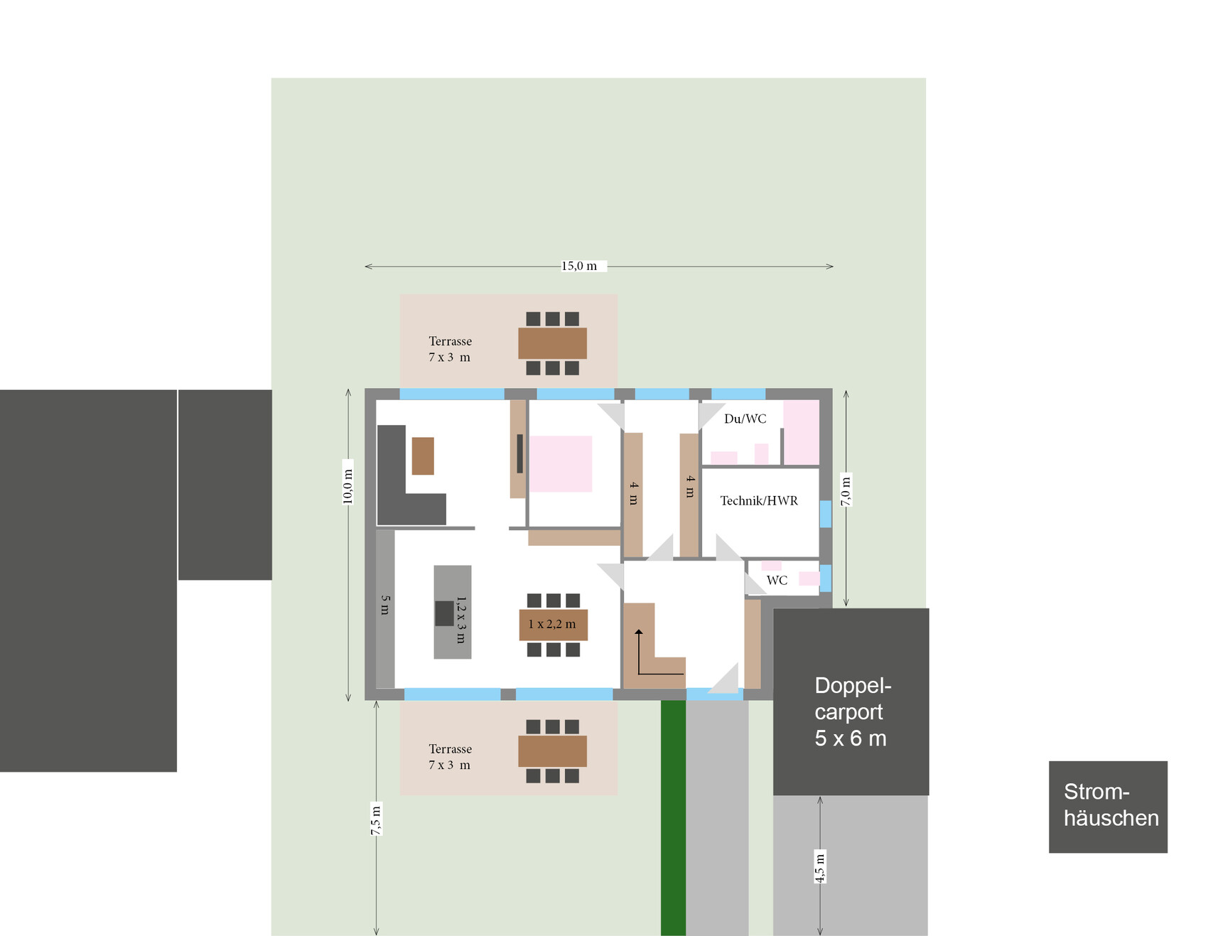

I completely redesigned your ground floor to take advantage of the south and north sides. As a result, the house now has a different shape. The staircase should now lead very conveniently to the upper floor. You can still create your gallery above the kitchen and dining area. Rooms are then located on the north side (accessed via the gallery) and rooms to the right of the staircase.
Oh, and of course, an 8 m (26 ft) wardrobe.

neo-sciliar31 Jul 2020 14:49@Würfel* I really like that, very much actually. Thank you very much for it. Regarding the 8m (26 feet) closet, it can also be spread over different floors. It also includes summer/winter or seasonal clothing. Are 5 meters (16 feet) enough for 2 cars? I have 5.5 meters (18 feet) today, and that doesn’t feel very spacious to me.
@pagoni2020 Problem, why? I can separate the terrace design from the house. Where is your underground garage, or do I need to call in Sherlock Holmes aka @11ant?

pagoni202031 Jul 2020 14:53No, that was nonsense after all.
I also like the idea from @Würfel*, and you could actually start something with it now, right? I find it clearer and smoother this way.
