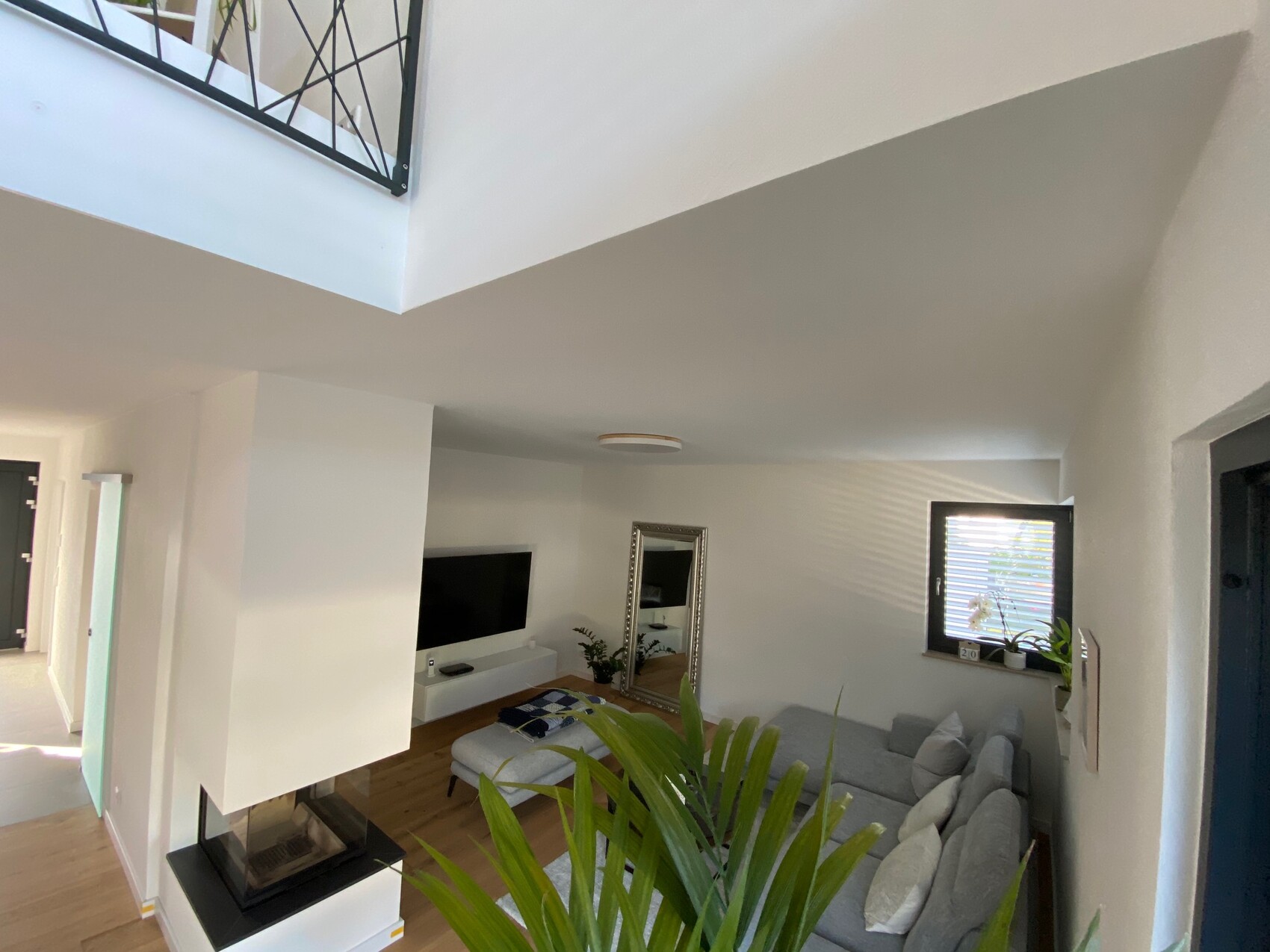

Ah, I just noticed the living room is 17 square meters (183 square feet). Still, I find the walkways tight, especially with a coffee table later on. Here’s a comparison with my 20 square meter (215 square feet) living room. As you can see, everything is already quite tight there.

Here is my 20 sqm (215 sq ft) living room for comparison. As you can see, everything is already quite tight there.
Thanks for your photo. That is really 20 sqm (215 sq ft), or 4 x 5 meters (13 x 16 feet)? Wow.
There is only one door to the living room; the other two are fixed glass panels to allow light to pass through. We have thought about this corner for a long time and are still not 100% satisfied. The brighter part has a cathedral ceiling, while the darker part has standard ceiling height. The wall between the dining area and living room is also only floor-to-ceiling height, so theoretically, you could look over it if you were taller than 245 cm (8 ft). If the wall coming from the kitchen wasn’t continuous, it would probably look strange. The corner in the hallway leading to the walk-in closet contains a built-in cabinet for everything that needs to be stored but should remain centrally accessible (vacuum cleaner, brooms, etc.). That cabinet would be lost if the entrance to the walk-in closet is moved there. We are still undecided about this.
