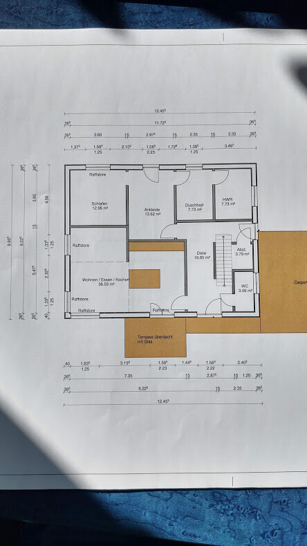

Why don’t you make the entrance to the master area through the walk-in closet? This way, there is only one door to the bathroom, and no one has to wait in front of the bathroom (for example, while someone is showering) to get to the walk-in closet or the bedroom.
Your living room corner is smaller than a small kitchen. Have you actually measured this in real life?

I actually prefer the bathroom layout in your revised plan #144, as it at least allows the toilet to be separated by a sliding door. I still find the "access to the bedroom through the bathroom" design unusual, but it’s easier to imagine. In my opinion, it’s still impractical, but I understand you’ve analyzed your routines (does ironing and putting away laundry, forgetting things in the closet, tidying up the bedroom, etc., really only make up 5% of your movements?).
I also find the TV room on the upper floor inconvenient. On the bright side, you’ll stay fit since you have to go downstairs to the kitchen for every bowl of popcorn or drink, then back upstairs, and back down again to return everything. Since you have teenagers, I can already picture a lot of dirty dishes piled up in a corner upstairs.

neo-sciliar schrieb:I really don’t understand that. The open-plan kitchen/living area is so important to you, and guests still sit right next to the kitchen anyway. So why make such a detour around the corner? The hallway ends openly in the kitchen/living area, yet the kitchen has a door... it seems a bit odd. Or do guests only go upstairs!?
Now there is more hallway space, but visitors no longer have to go through the kitchen.

I completely agree with borxx’s post. The TV room feels very uncomfortable and narrow.
I would place the kitchen differently. It somehow gets in the way, making the hallway feel like a maze. I can’t imagine anyone using the outer bypass to get to the living room.
I’m wondering if the parents’ bedrooms with different depths actually feel as chaotic in real life as they do in the top-down view. I would also choose the entrance through the walk-in closet.

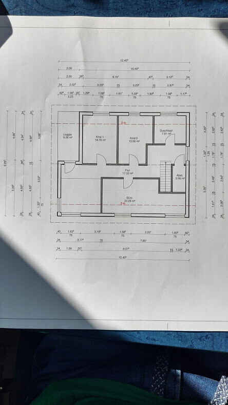

neo-sciliar22 Jul 2020 08:36Hello everyone, this is the planner’s draft from the house manufacturer. We are currently reconsidering the concept of having the bedrooms downstairs and the living room upstairs. Nevertheless, I want to share my thoughts here, as it seems to confuse many (yes, it is unusual). The standard layout has all the bedrooms upstairs, with the living room/dining area/kitchen downstairs. This means the stairs are used multiple times a day: getting up, showering in between (there might be a shower downstairs, but clothes are upstairs), changing clothes, carrying laundry up after drying, going to bed. A nap in the afternoon would be added to that. In “my” version, the criticism is about having to go upstairs to watch TV and then come back down again. All other trips are eliminated since laundry is done entirely downstairs. The living room downstairs (we call it a sitting area) is really only meant for sitting briefly, watching the daily news or something similar. That’s why it is so small. Does that make sense? As I mentioned, we are still reconsidering it… My basic principle in life: don’t accept something just because everyone else does. I question everything. It doesn’t have to be right just because it has always been done that way (if that were always true, we’d all still be riding horses across the prairie today…)
We also don’t like the flow downstairs with the kitchen. I’m looking forward to suggestions for improvement here.
We also questioned whether the bathroom door should be in the bathroom or in the walk-in closet. Ultimately, we decided on the bathroom door so there would be more space in the walk-in closet and room to place a cabinet in the hallway by the kitchen.

yes, I’m here to get ideas and to question myself.......
Attached are the plans from the Stommel Haus planner (not an architect yet, but as far as I understand, he is only responsible for structural calculations and the building permit/planning permission, not the layout). We gave a few basic requirements, and he drew the plans.
Ground floor
Upper floor
