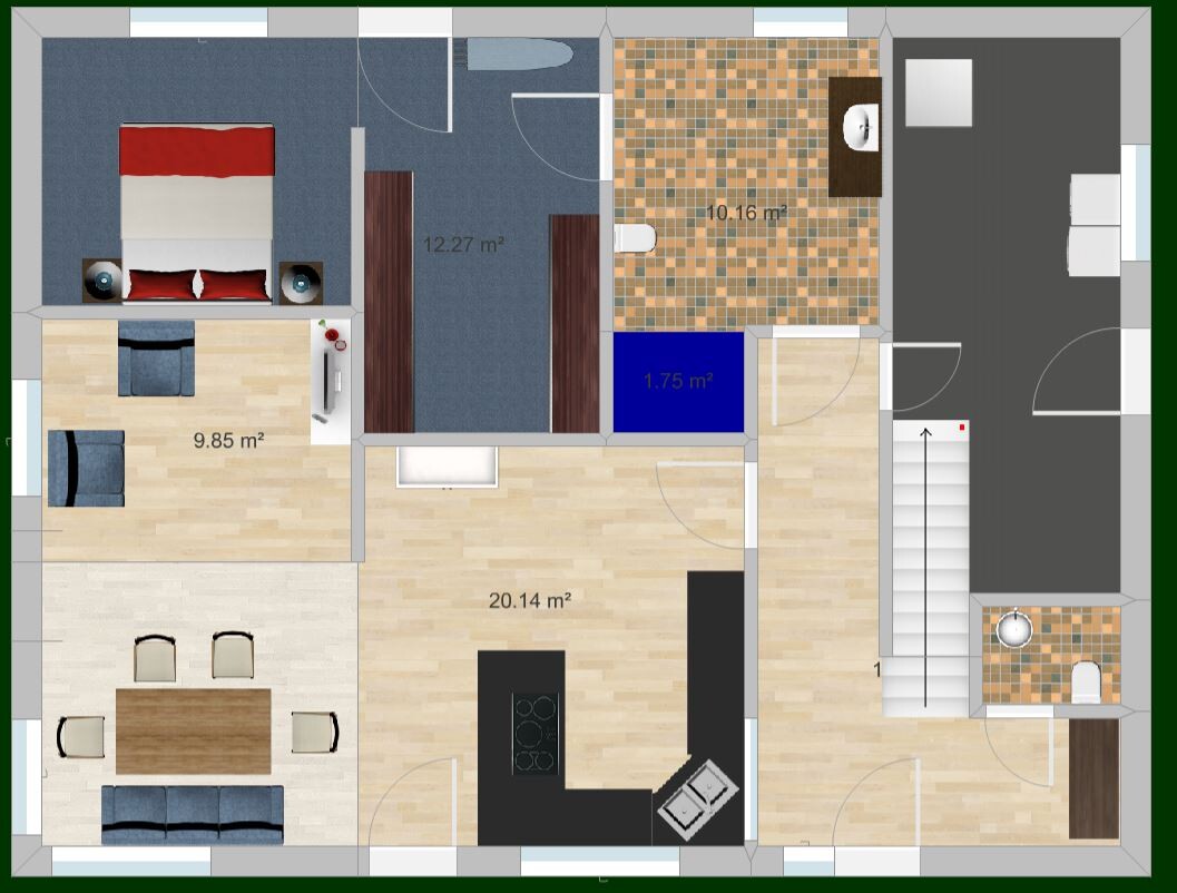

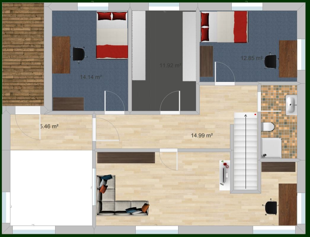

Hello, we have now received the initial floor plans from the architect. I’m curious to hear your thoughts. Finally, we have followed your advice and didn’t design everything ourselves but asked the house builder’s architect to develop a plan that meets our requirements.
Some unusual features are intentional. For example, you can only access the bedroom through the bathroom and dressing room, which covers 95% of our daily routes.
Also, there is only a small living area with a TV on the ground floor. Life happens downstairs, while watching TV in peace takes place upstairs.
Suggestions for improvement are very welcome. Comments are also appreciated as long as they are well-intentioned.

MayrCh
19 Jul 2020 18:54
Tell your planner to include measurements, otherwise it’s a bit difficult to assess.
It seems there are no load-bearing walls, as hardly any wall aligns with the one below, and the wall thickness is not properly considered.
What is the white area on the bottom left of the upper floor?
How is the building oriented?
neo-sciliar
19 Jul 2020 19:10
The house measures 13 by 10 meters (43 by 33 feet). South is at the bottom. There is a wooden beam ceiling, and the roof is self-supporting with the upper floor open up to the ridge. The white area represents an air space.
