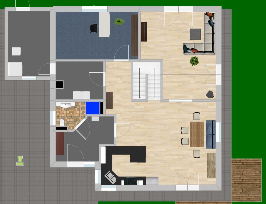

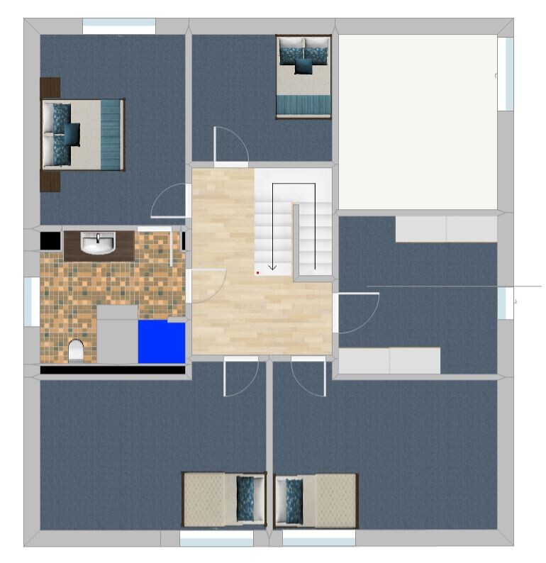

We have a plot of land (see site plan) and have started planning our dream house without an architect. Before we move forward in more detail, it would be great to receive opinions, ideas, and perspectives.
On the floor plan, you can see an electrical transformer to the east. It is quite tall and does not provide a pleasant view. Therefore, the utility room is planned here, separated from the house with access to the "breakfast terrace."
We are planning with the future in mind. This means we want all the essential living spaces on one level. Upstairs is for the children and grandchildren when they visit, as well as hobby rooms, an office, etc. The area above the living room is open. Downstairs, it is important for us to have separate areas. The kitchen/dining and living rooms should not be an open, connected space. We often have guests while others want to watch a movie in peace.
We welcome any extraordinary ideas. The house should be unique. But we also appreciate advice on realistic feasibility.
The house will be built as a timber frame house.
The building plan allows for few restrictions. The building envelope is shown on the drawing.

neo-sciliar15 Jun 2020 10:33Hello everyone,
I had to register again after being banned and receiving no response from the moderators to my messages. I hope (and kindly ask) not to be banned again without reason.
Yes, I was (very) upset that my data was shared here without asking. This should not be done. Nevertheless, the comments and criticism here are valid and helpful, so I have taken them on board and revised the floor plan. See attachment.
I will try to answer the questions from the questionnaire:
Plot size: 640 sqm (6889 sq ft)
Slope: flat
Site coverage ratio: --
Floor area ratio: --
Building envelope, setback lines: max. 13 meters (43 feet) deep and max. 15 meters (49 feet) wide
Edge development: permitted for carports/garages
Number of parking spaces: none
Number of storeys: none
Roof type: none
Architectural style: none
Orientation
Maximum heights / limits: max. 8 meters (26 ft) high
Other requirements
Architectural style, roof form, building type: modern wooden house (possibly Stommel house)
Basement, storeys: no basement, 1.5 to 2 storeys
Number of occupants, ages: 2 adults (44 and 41), 2 children (16 and 19)
Room requirements on ground and upper floors: see plan
Office: family use or home office? Home office
Guest stays per year: approx. 5 nights
Open or closed architecture: closed
Conservative or modern construction method: ??
Open kitchen, kitchen island: open, kitchen island optional, important: no cooking facing away from the room. Open-plan living kitchen
Number of dining seats: 6
Fireplace: yes
Music / stereo wall: TV with 5+1 surround sound
Garage, carport: carport for 2 cars
Further wishes / special features / daily routine, also reasons why or why not. No “all-purpose room.” Often guests from part of the family, so separation of living room and dining room.
Who created the plan:
- Builder’s planner
- Architect
- Do-it-yourself (x)
What do you like most? Why? open but still separated
What do you dislike? Why? entrance area still too confusing
Price estimate by architect/planner: --
Personal price limit for the house including equipment: 450k, possibly 500k
Preferred heating technology: gas or heat pump. Definitely underfloor heating
If you had to give up on which details / expansions:
- can you give up:
- cannot give up
Why is the design as it is now? E.g.
A mix from many examples from various magazines...
What do you think makes it particularly good or bad? living area, open up to the ceiling, central staircase for short distances.
I have tried to “smooth out” all the corners and edges. The rear left room is intended as the utility and service room behind the carport, outside the main building envelope. Large, as it should also serve as a garden tool storage.
Comments (honest and even blunt) are still welcome.
Regards, sciliar
