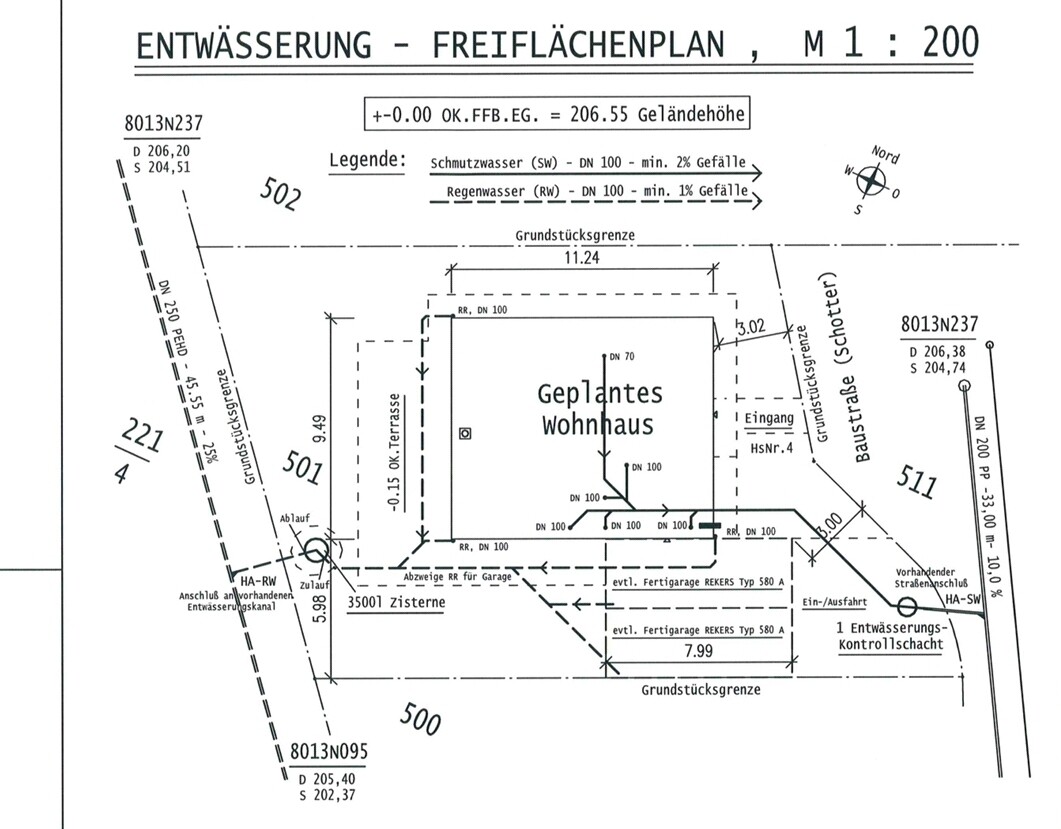

Palladin7317 May 2019 21:50We have just signed the building application documents and have a problem. The property developer says we should connect the wastewater pipes under the slab (no basement), while the building inspector says, according to DIN 1986-100, they should lead directly outside and be connected externally. The argument for routing under the slab is frost protection, and for outside routing, accessibility. Does anyone have experience or expertise with this?

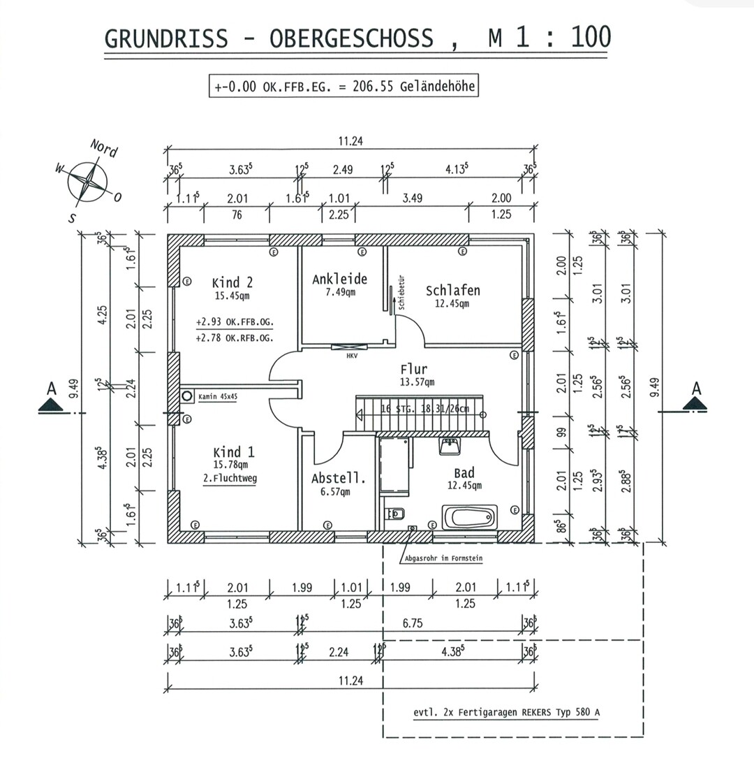

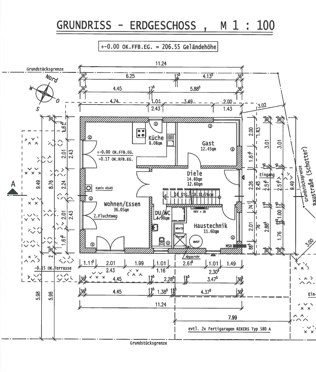

Please show the plans.
