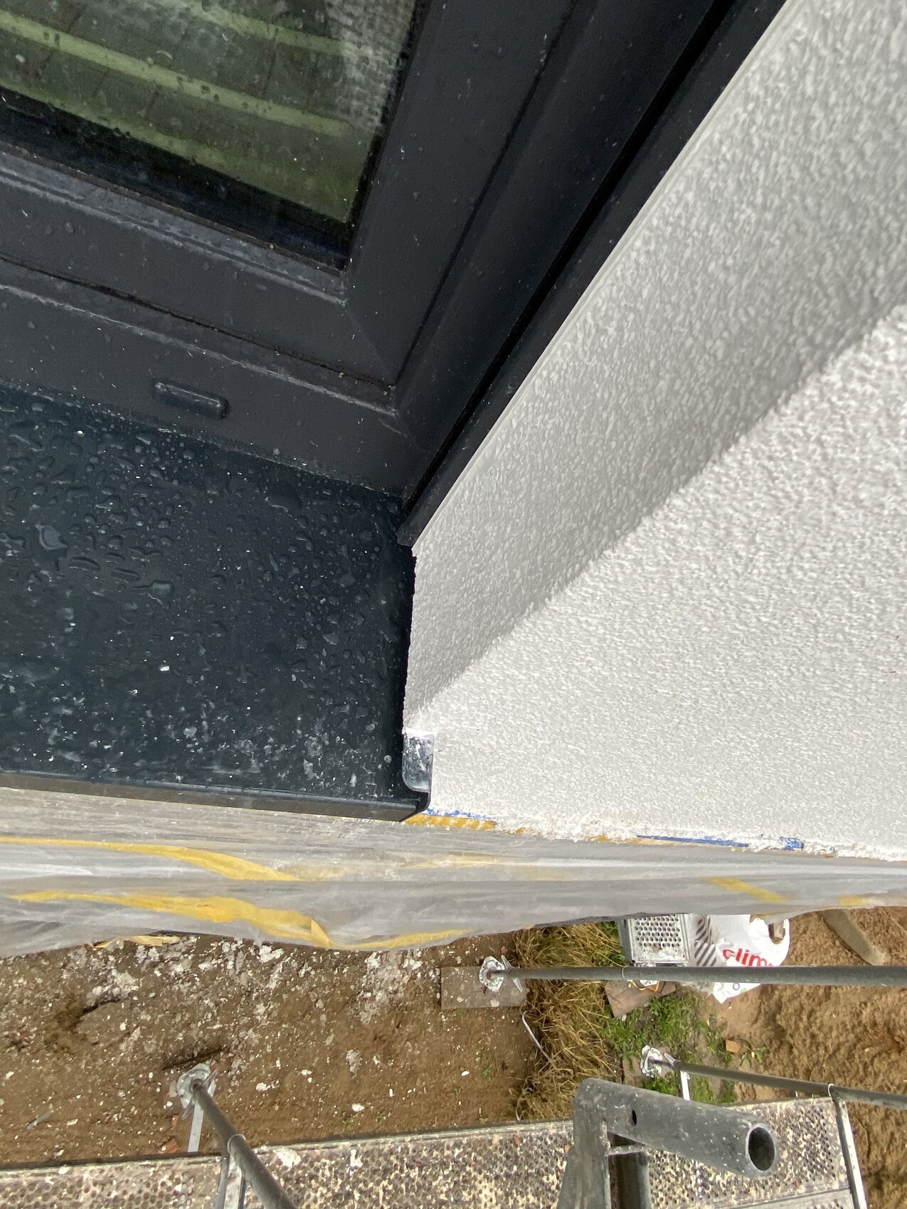

Hello everyone.
Our windows are (according to the window manufacturer) RAL7016.
Our window sills (these were installed by the company that did the exterior plastering—only God knows why) are supposedly also RAL7016.
They are plastic windows with aluminum window sills.
However, the color difference is very noticeable!
Do I have to accept this?
Exterior view of a window front with black frame, gray rough plaster wall, and scaffolding below.

It will never match perfectly. Even a powder coating using the same powder on steel and aluminum will have a slightly different color. Different gloss levels also make the color appear different. Additionally, there are two different coating processes involved here. When in doubt, always compare samples, but keep in mind that there may still be slight variations.

Other materials make it look different for that reason
Curly
15 Dec 2019 14:10
Aluminum and plastic always look different. The aluminum is painted, while the plastic window is covered with a film, so they cannot look exactly the same. Don’t worry, the dark windowsill will be dusty after a week anyway, so it will look different again.

Normal! I don’t see any issues there.

These are plastic windows and aluminum window sills.
That is the entire reason. Because: RAL is not Pantone. An RAL color code only specifies the color of the paint or other coating used – it does not indicate how the finished surface will appear.

Thank you very much for your opinions.
I guess I'll have to accept it then.
Thank God it only affects the upper floor, as we have a brick slip cladding in the basement.
If I had to see that every day from the outside on the ground floor during summer, I would freak out...
