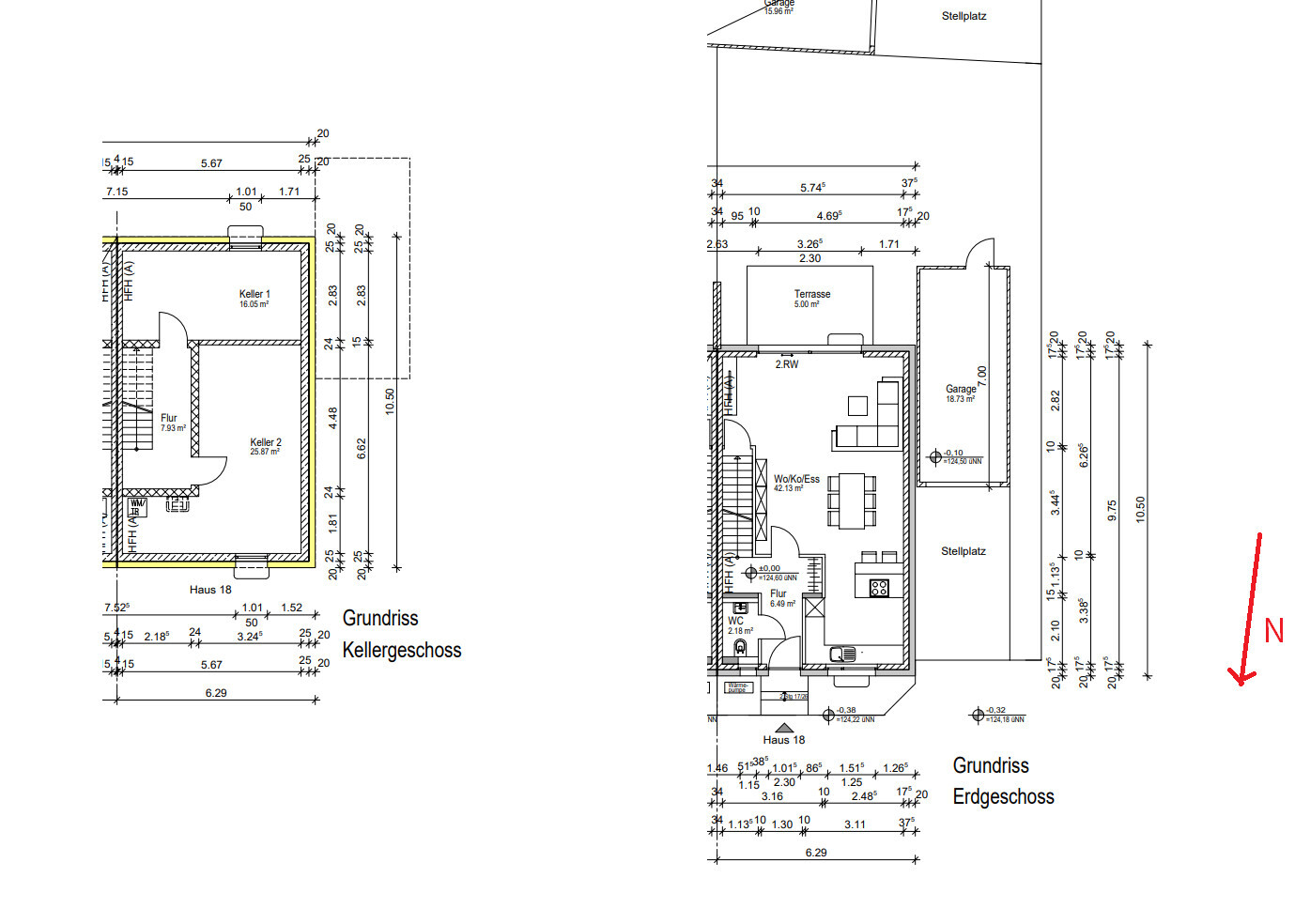

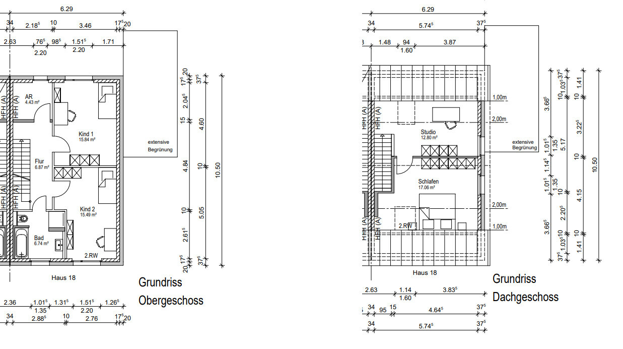

Here are the floor plans:
Basement and ground floor floor plan of a house with terrace, kitchen, living area, and garage.
Two floor plans: upper floor with hallway, storage room, child room 1, child room 2, bathroom; attic with studio and bedroom.
Basically, with the ideas I’ve had so far, I wasn’t sure if we’d be making improvements or accidentally making things worse. Sort of like the “mass-produced house – small changes with unintended side effects” thread we have here in the forum. From what I understood in the initial consultation, the walls that aren’t filled in yet (like on the upper floor) can be moved fairly easily. I’m not sure about the niche wall on the ground floor (which I think is above the basement wall, so possibly a load-bearing support?) or the wall in the attic. We will definitely ask about that as well.

- The kitchen and entry area don’t quite feel fully coherent to me. The niche is better than no coat closet at all (as we’ve seen in some other floor plans), but somehow both the niche and the kitchen feel a bit constrained. Maybe the kitchen as a U-shape instead? The island doesn’t seem very practical the way it is. Or (just another idea) swap the coat closet niche and kitchen niche (so the hallway at the entrance becomes wider and then narrows, and maybe the fridge would fit better in the wider kitchen part? But then the coat closet would be behind the door, hmm). None of these options excite me 100%, so I often end up thinking “or just leave it as is”, argh! By the way, a dark hallway doesn’t bother us at all.
- We actually like the upper floor quite a bit. Currently, we would use one of the children’s rooms as an office; long term, it depends on family planning 😉 I also keep looking at the storage room, where only one wall is really usable, and I wonder how useful it really is. We also considered taking a bit of space from the children’s rooms to make one slightly bigger for a small second office for me. At the moment, in our rental apartment, we have a bigger office and a small workspace in the living room (which would be the replacement). But again, it’s that kind of “or just leave it as is?” thing. Seems like a risk of making things worse.
- The attic raised the question of whether to reduce the bedroom size and make the studio a separate room. We’re not sure if that’s possible (if my assumptions about the walls are right), and currently there isn’t really a need for it. (Like I said, for now a child’s room will serve as an office... but long term, it may indeed be needed as a bedroom.) Again, “or just leave it as is?” For the first few years, it truly doesn’t matter, and by then remote work may be out of fashion anyway, who knows 😉
So far, it’s just brainstorming. We get the feeling that the current floor plan would be quite livable for us, and every time I think about changes, I end up wondering "did I just make it much worse?" :p I guess I should also try drawing the furniture and take a closer look.

Niche wall on the ground floor (I think it's located above the basement wall, so maybe it’s actually a load-bearing support?)
Looked at it again, maybe not after all 😀 Still confused. I’m also starting to doubt whether I remembered the wall details correctly, oops.

So the niche is better than no cloakroom (as we have seen in some other floor plans), but somehow both the niche and the kitchen feel a bit cramped to me because of it.
On second thought, I would keep the niche there and if anything, make a U-shaped kitchen.
On third thought, the staircase to the upper floor (basement and ground floor) could be a quarter turn, so that the basement entrance is accessible from the dining area, then place the kitchen at the top left of the plan, and the living room corner where the kitchen currently is. Having a window facing southwest would be nice.
What I like is the sight line from the entrance toward the staircase/living area.

For the third idea, the staircase going up (basement and ground floor) would be a quarter-turn, so that the basement access is from the dining area. Then the kitchen would be at the top left of the plan, and the living room corner where the kitchen is currently located.
To be honest, I’m not sure how much we can change here (especially without causing significant extra costs), but we will take it into consideration. This is not a fully custom plan, and I don’t yet know which parts the developer will do “by the book” and keep fixed. That said, I’m also not completely sure if we actually want to change the staircase (I think I need to search the forum for that image with the floor plan measurements for stairs and mark it up). The advantage of having the kitchen next to the terrace would certainly be the shorter route from the terrace, although with an open floor plan I don’t find it a big issue if it’s the other way around. Otherwise, I will probably have to make a drawing, because I can’t really imagine how to arrange the kitchen then. (But I’ll wait until I know what’s possible. I’ll probably find out more this or next week.)
About the "window facing southwest," I’m not sure what you mean, since there is a garage there? Or do you mean a window on the west side, at the north corner where the kitchen is currently planned? (Or did you mean the upper floor instead of the ground floor?) Again, I’m not sure how much can be changed there. I assume new windows usually require new structural calculations? In principle, there are probably no windows on the ground or upper floor, since for the mirrored end house on the other side, windows are not allowed (noise protection towards the railway). But we agree it would be nice to have windows on the west side (which is actually one of the advantages of an end house), so we will consider that again 🙂

mayglow schrieb:
When you say "window facing SW," I'm not sure what you mean, since the garage is there?
Yes, windows facing the yard. Natural daylight would be nice there, even if it's just the driveway.
