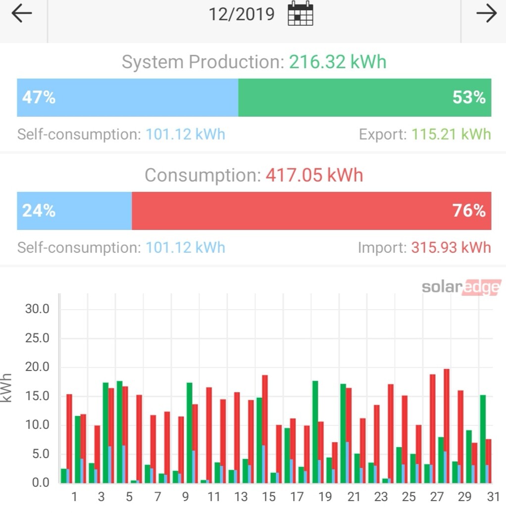

But if you come around with a 20 kWp system capacity, then that makes sense again I recorded a yield of 28.9 kWh on December 30. System size is 7.5 kWp south-facing roof.
boxandroof1 Jan 2020 10:55With a 10kWp system, I could have fully charged a battery 9 times in December. The best day for me was only about 18kWh.
I do not plan to install a battery in the foreseeable future.
boxandroof1 Jan 2020 11:12Your yields sound very good!
I will find out how things are going with the neighbors... I assume my system will be mostly in the shade because of the low sun angle (flat roof with parapet). Otherwise, this large difference is hard to explain. The yield in December was a poor 70 kWh.
