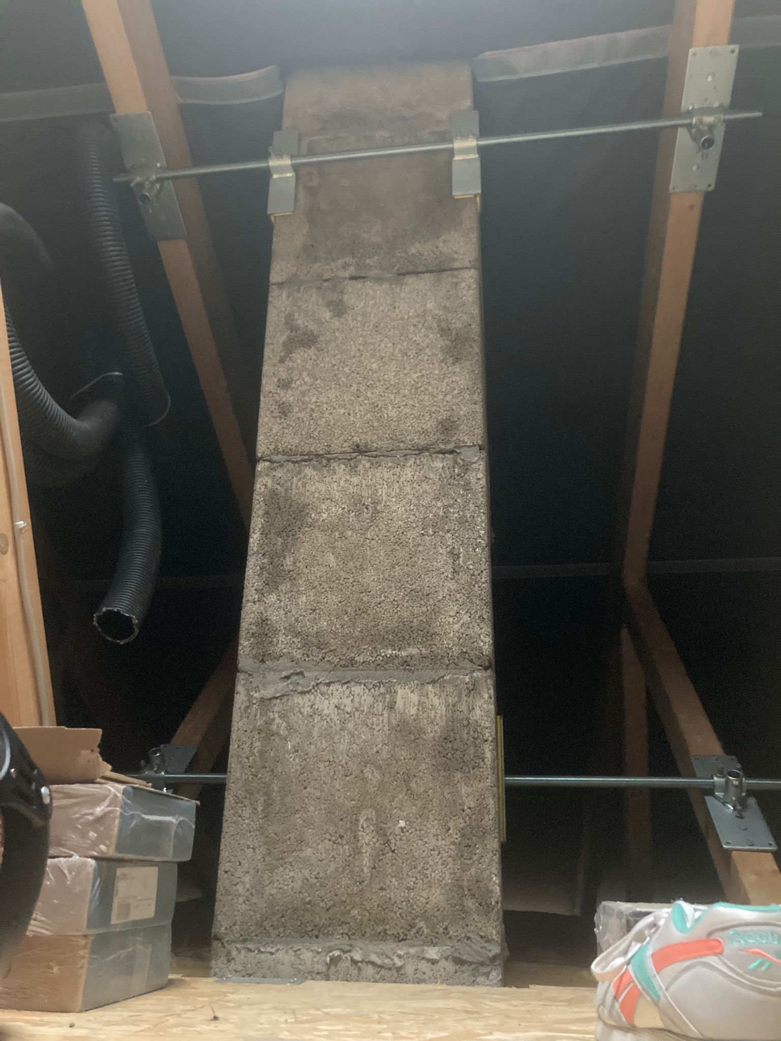

This was visible from the outside in the part that runs through the attic (photos). The light-colored brick got darker day by day until actual water droplets were visible.
The bricks became increasingly darker and damp.
When spring came, it gradually disappeared.

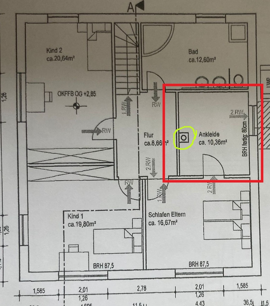

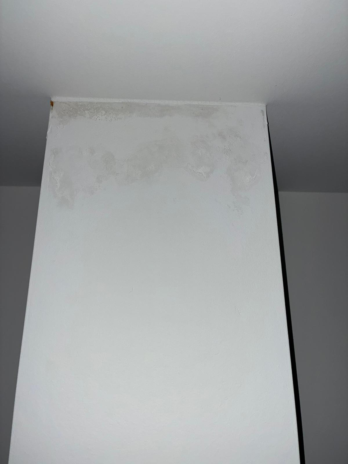

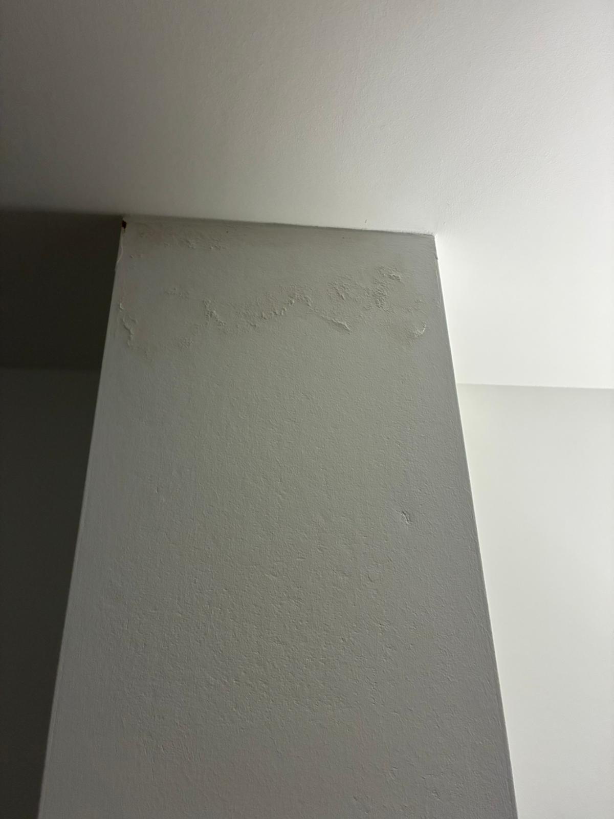

This winter, we have the problem again and now it seems the water has moved one floor lower and caused increasingly large stains on the plastered wall in the dressing room (see photo, red border for the room, green for the chimney). I suspect from online research that salt efflorescence is now visible.

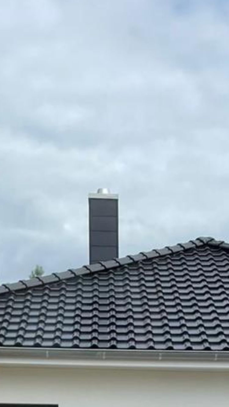

An unused chimney is essentially a duct running alongside heated rooms that itself is not heated and therefore cooler. If the chimney is sealed at the top, this only applies to the duct itself. If it is open at the top, it obviously communicates with the outside air (and there is also rain entry). But even “just” condensation is enough to make the chimney walls damp. Anyone living in a house without a chimney should either omit or seal off the chimney and ideally also remove the chimney cap, relocating this closure inside the building’s thermal envelope.

How can a fireplace be sealed?
I’m actually confident enough to climb onto the roof myself to save on costly contractor fees. =)
