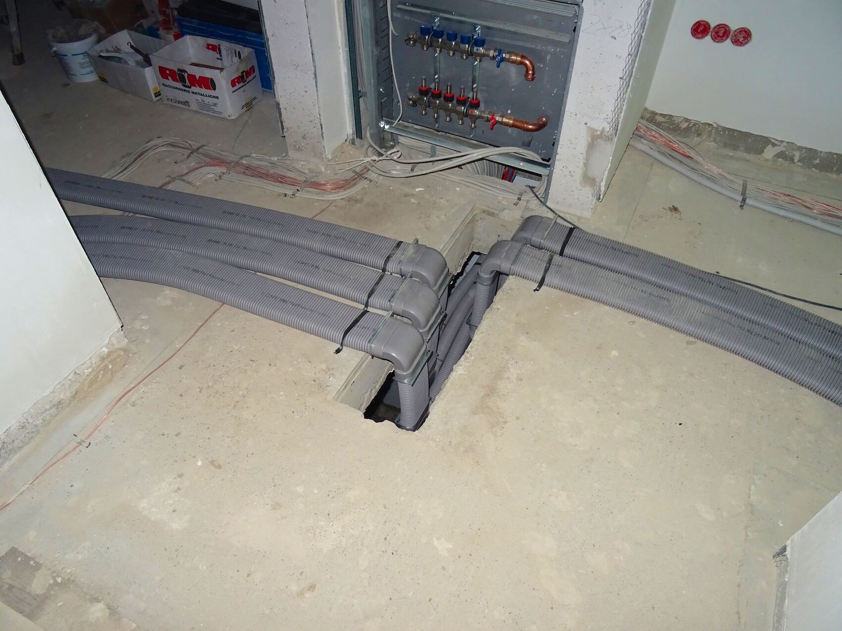

I don’t have a picture of the opening at the moment. However, the attached image (from the internet) illustrates the situation quite well. The section on the construction site isn’t quite as long.
Gray conduit pipes run over the concrete floor; next to them is an installation distributor with copper pipes.

The internet is available too, but unfortunately that picture shows the wrong side. My concern is where your problem is (from below): from above it disappears into the finished floor and is closed off. What are you worried about from underneath? That something might crawl in, moisture perhaps?
Wintersonne
24 Mar 2020 19:48
What are you worried about from below: that something might crawl in, moisture for example?
Well, I’m not really sure. The insulation (on the opening) might be unstable, or I did consider moisture coming from below, but I’m not sure how that would damage the insulation... So, would it make sense to first install insulation from above plus complete the rest of the floor structure, and then at some point (fairly soon) fill in from below with polystyrene or foam? Then put a board on it, plaster, and finish?

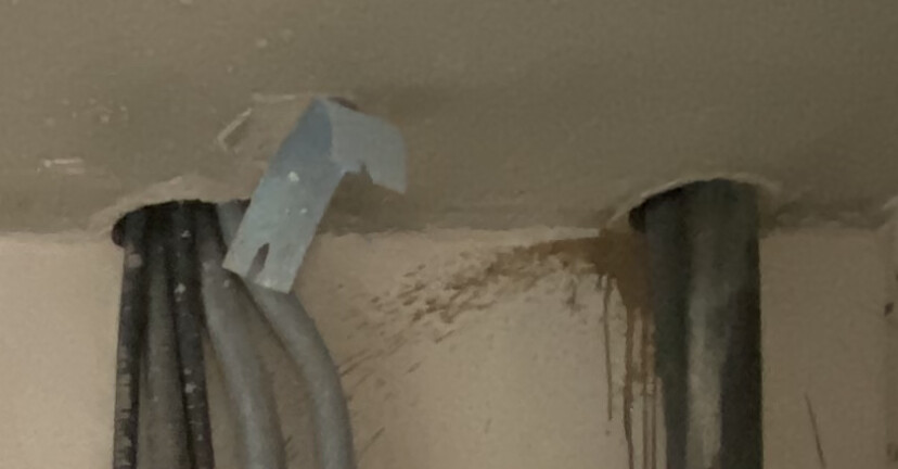

Golfi9024 Mar 2020 20:17
My problem area is clearly visible here.
The hole goes straight through the bathroom wall above and ends in the unheated attic...
Two pipes on a damp wall; brown water stains below the ceiling, tape visible.
