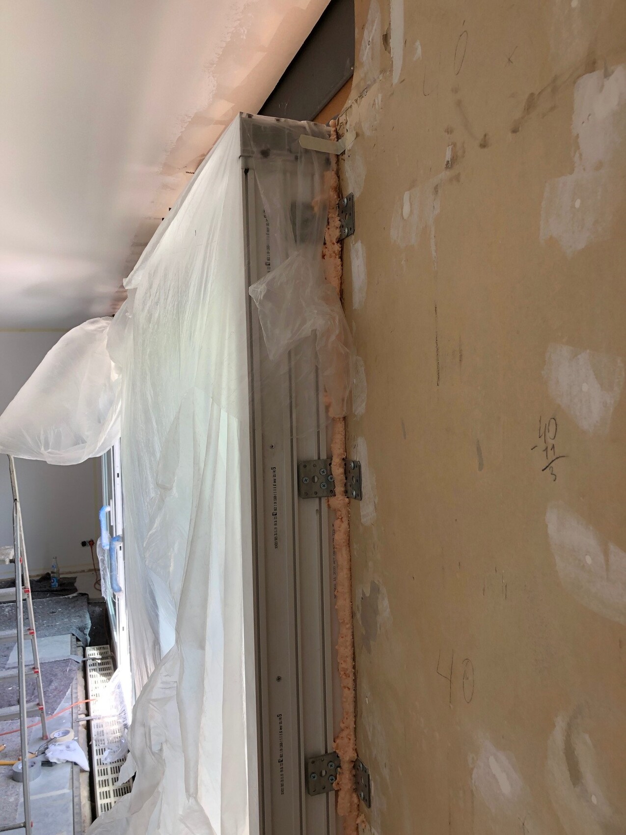

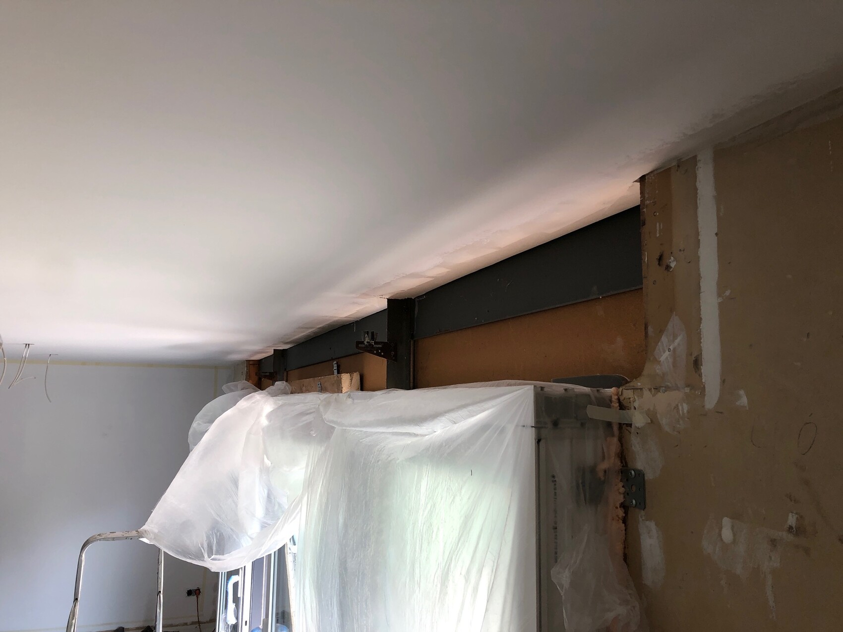

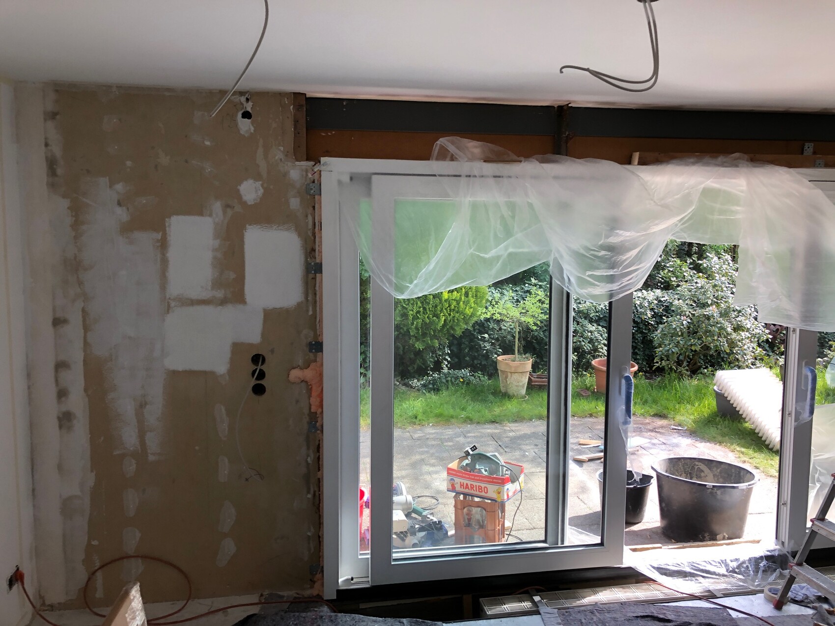

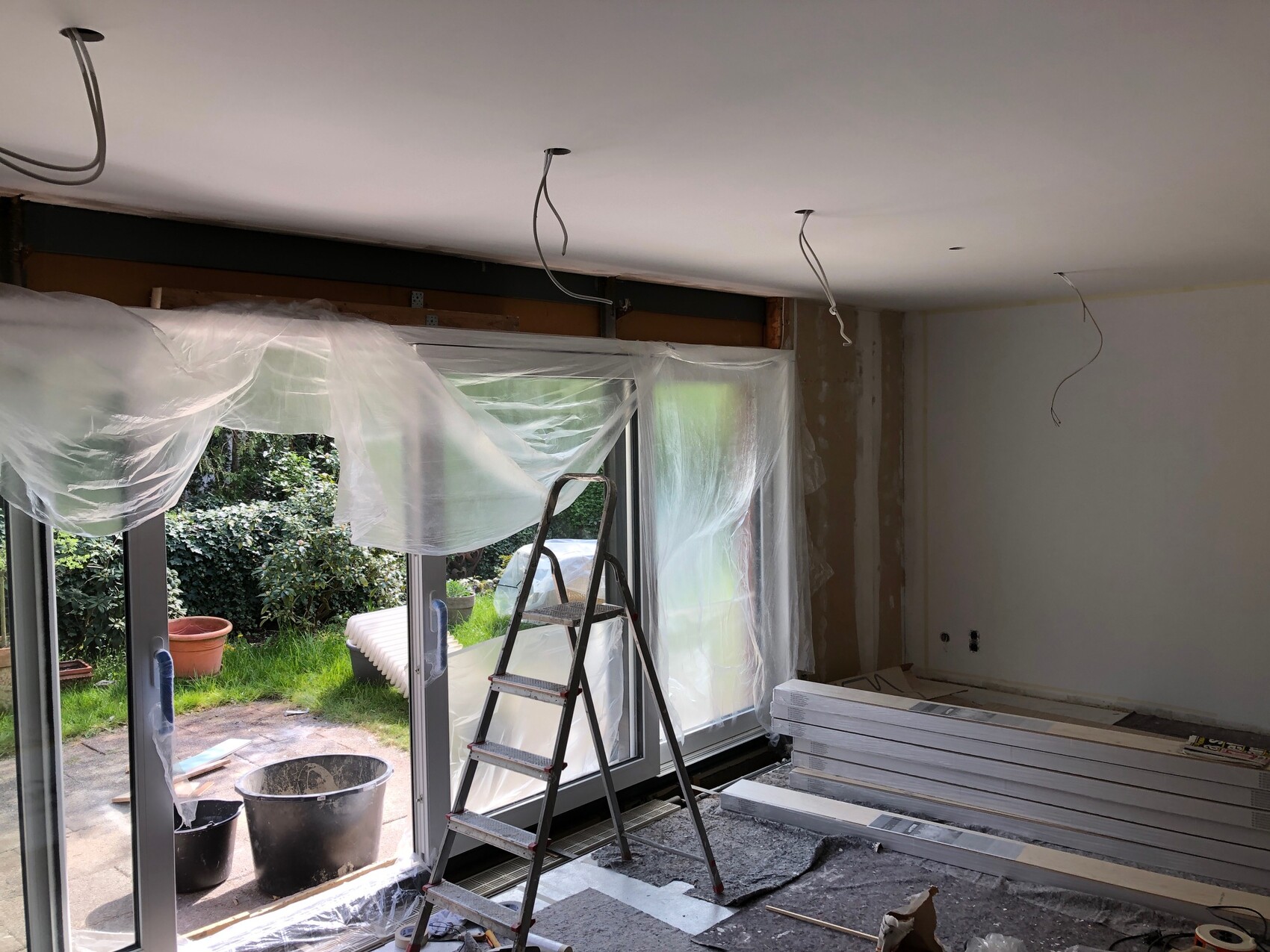

my renovation is slowly coming to an end. Of course, there’s one last nice project to wrap things up.
A new lift-and-slide door has been installed. Due to the on-site conditions, it extends about 14cm (5.5 inches) into the room. I would prefer it visually if I could close off the openings above and on the sides flush with, for example, drywall panels.
I’m thinking of a kind of wooden frame construction, with three vertical battens on the sides and cross pieces between them. I think I can manage to close the sides somehow, but I have some concerns about the area above the lift-and-slide door. Is it possible to also attach a batten horizontally there? If necessary, could it be “glued” in place? It should work, right?
Do you have any concerns that the drywall might crack at the joints due to vibrations from repeatedly opening and closing the door? Or do you have another idea on how to cover these areas flush with the door? Thanks.

21 Apr 2020 19:10
Sorry, I can only post pictures of the exterior tomorrow.

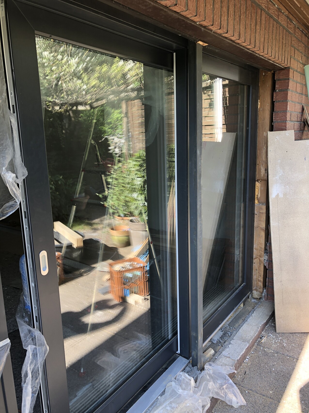

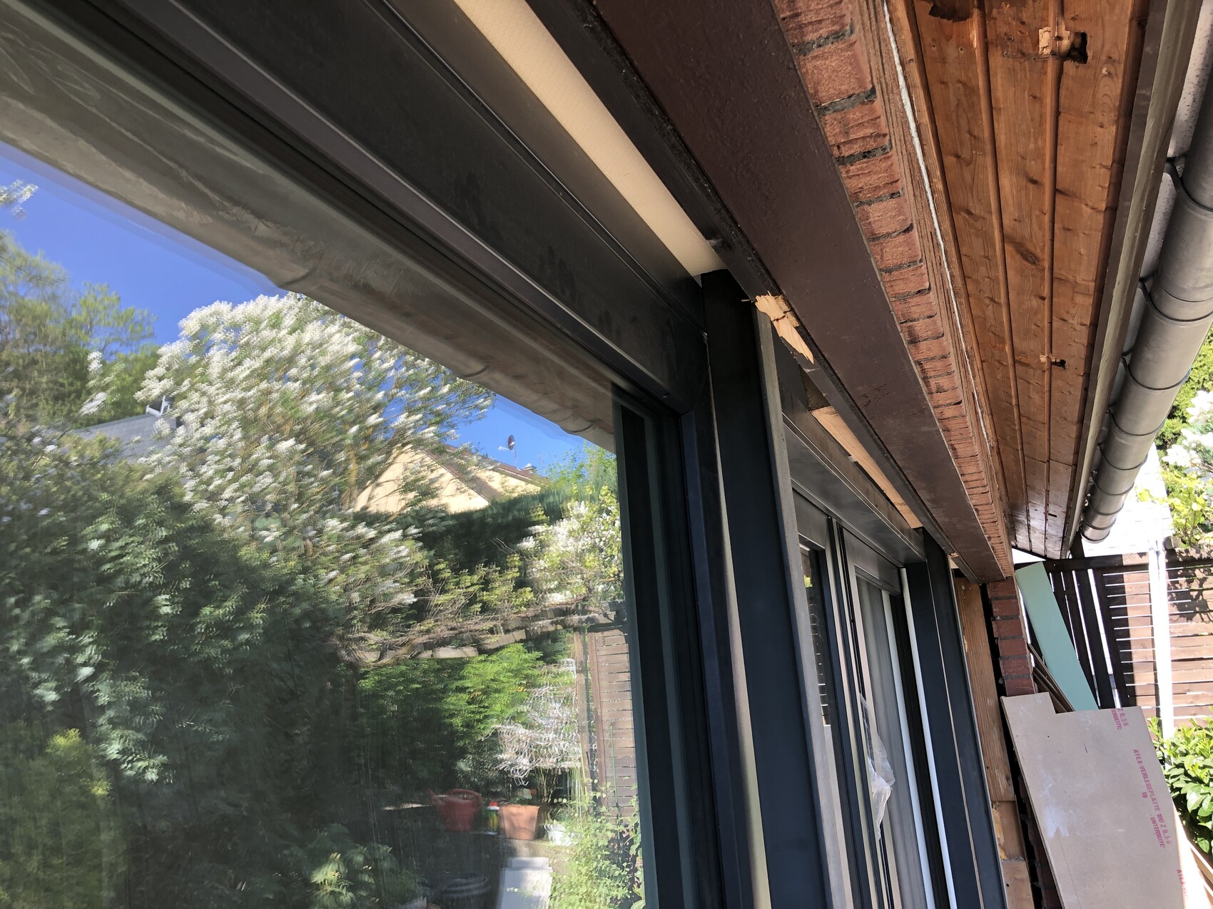

The problem is two vertical steel beams on the outside that cannot be removed, as well as steel beams above the door. The old door was built more "around" these. I will take more photos tomorrow and upload them. The roller shutter box will be removed, there will be new external Venetian blinds.
@guckuck2: That was my plan, that’s how I wanted to do it.

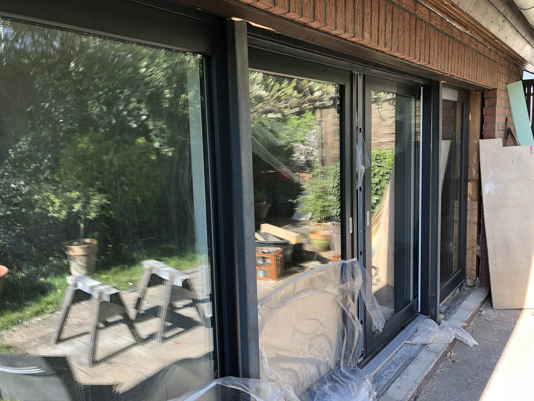

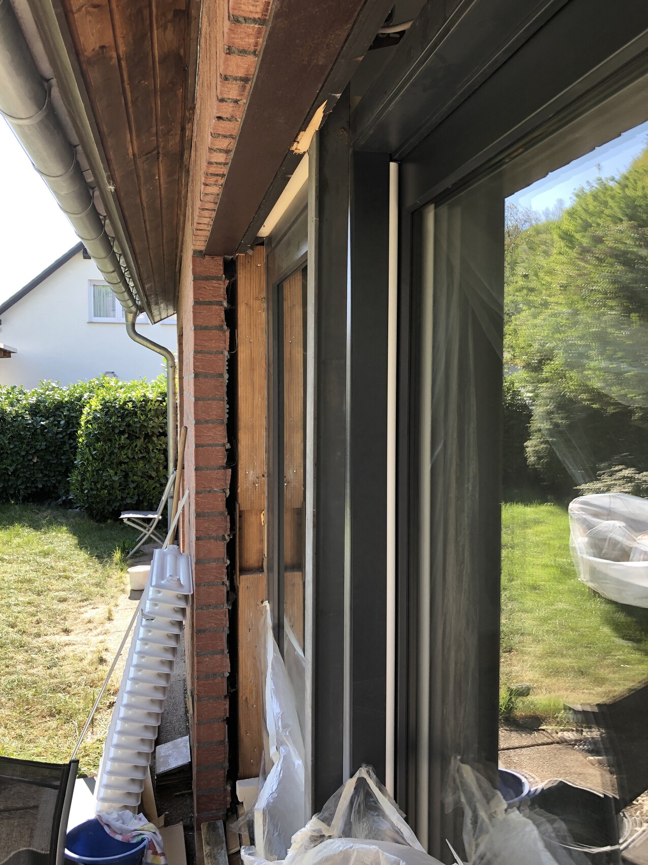

X_SH5_X
22 Apr 2020 17:19

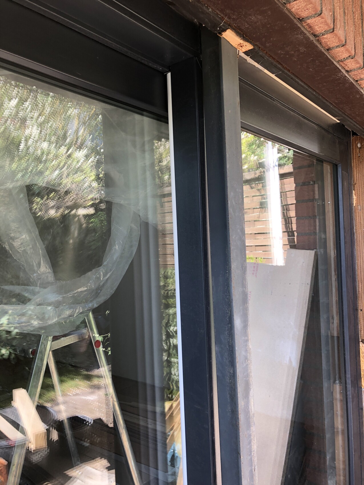

Here are the photos from the outside. Everything will, of course, still be clad and have external blinds installed in front.
Large glass sliding gate in front of construction wall; ladder, construction wood, plants, and covering material.
Exterior view: brick wall with exposed wooden frame, large glass front, construction tools in the garden.
Glass sliding doors during renovation; protective film on the frame, construction work in the garden, ladders next to it.
Large glass sliding door with black frame, construction site tools, ladder, and plastic sheeting in front.
Exterior view of a house: glass window reflecting the garden, next to wooden cladding and construction timber.

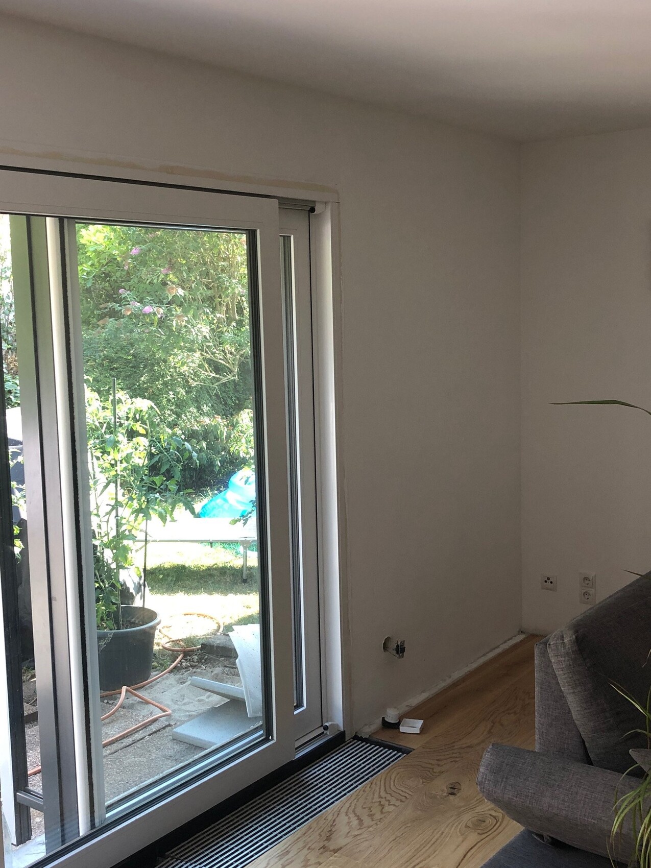

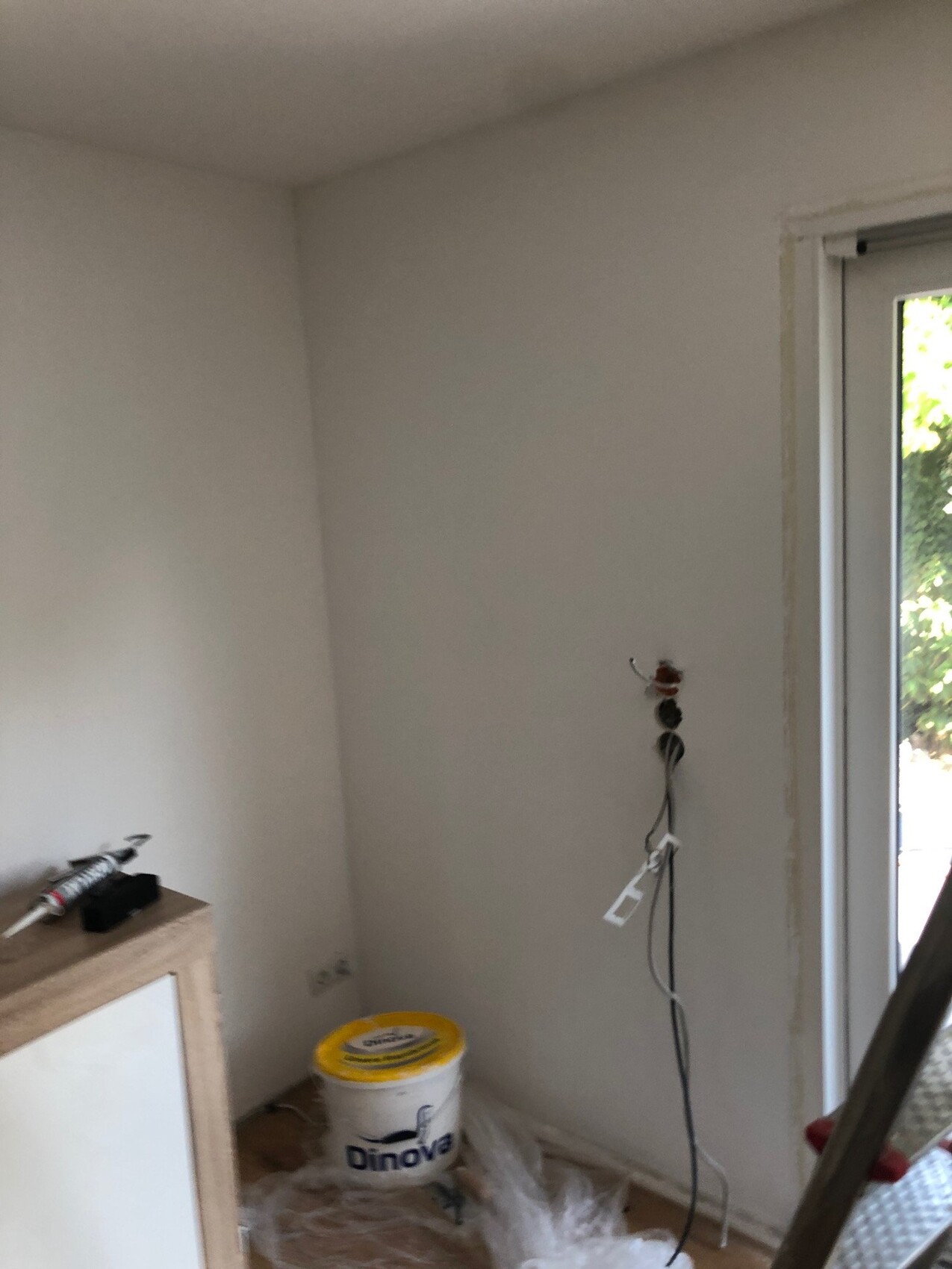

29 Jul 2020 11:32
For your information, we covered the door with drywall and insulated it with stone wool. We did it ourselves, and I am satisfied with the result.
Living room with glass sliding door to the garden, wooden floor, sofa on the right, plants outside.
Renovated interior: cables, bucket, protective sheet, and door leading outside.
