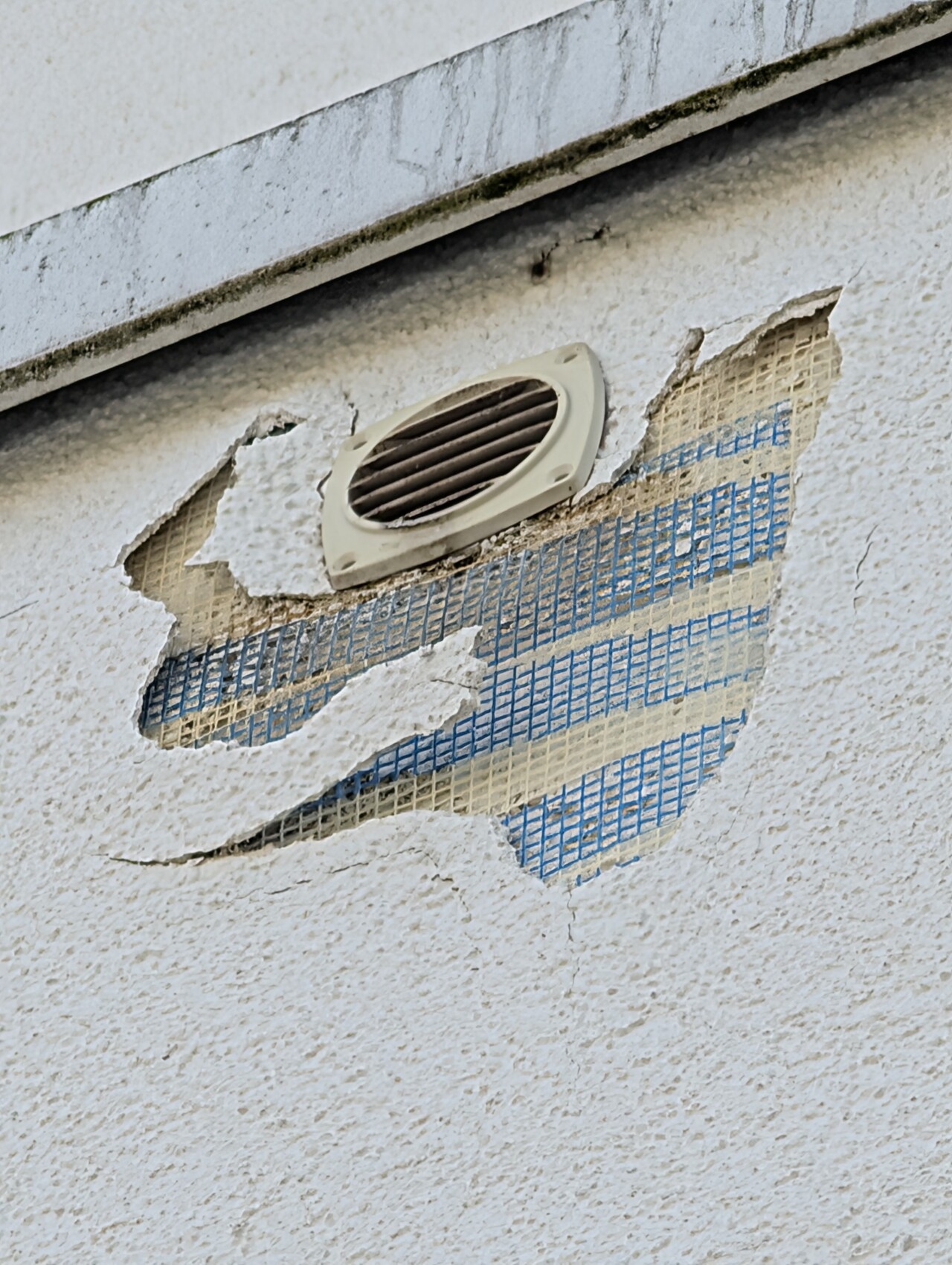

Blaexe90Hello everyone,
I am reaching out to you as a community of experienced construction professionals and homeowners because we, as a condominium owners’ association (HOA), are currently a bit uncertain.
The situation: On our new building (approximately 4.5 years old), the plaster on the facade is crumbling around two pipe penetrations (common ventilation pipes) (see photo). A third, identical penetration still looks fine. We discovered and reported the damage in January. The end of the 5-year warranty period is approaching, so we want to make sure this issue is properly resolved.
The developer has already identified the cause (albeit remotely diagnosed: missing separation between the plastic pipe and the plaster) and has responded in writing to our questions about the repair. However, their answers seem somewhat vague to us.

- What do you think of these answers? Is this a solid basis for a repair, or are these just vague responses designed to avoid commitment?
- I’m especially skeptical about the statement regarding moisture (“only a few drops,” “diffuse out again”). The areas have been open since winter, and there has been heavy rain frequently. Is this statement realistic?
- What would a truly professional repair look like to you? What should we pay attention to when the contractors come?
- What about the third area? We don’t want to just rely on “check and if necessary.” Is it common to do preventive repairs in cases where the defect is systemic?

Apparently, something must have coated the reinforcing mesh to prevent the plaster from bonding with it. As a result, the plaster remains a separate layer, apparently only as thick as a film.

The situation: On our new building (approximately 4.5 years old), the plaster around two pipe penetrations (stack ventilation) on the facade is flaking off (see photo).
