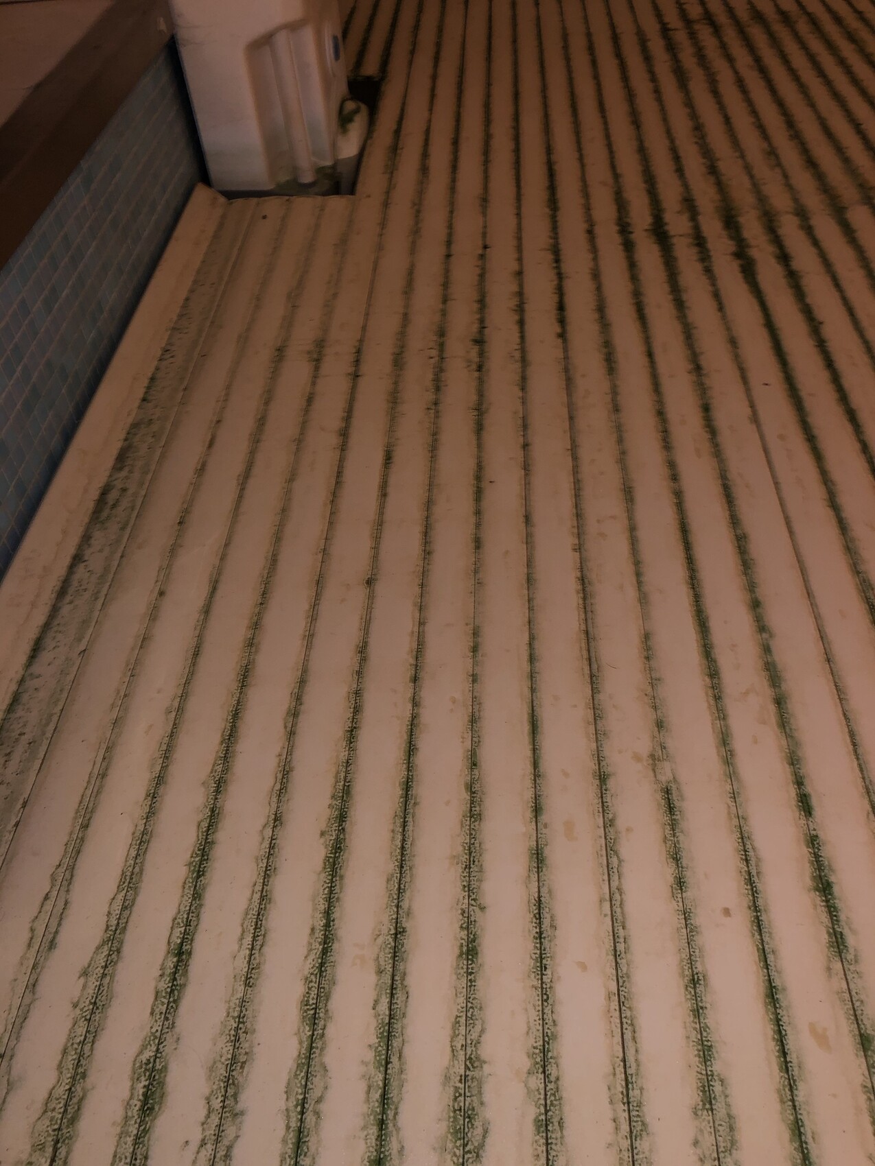

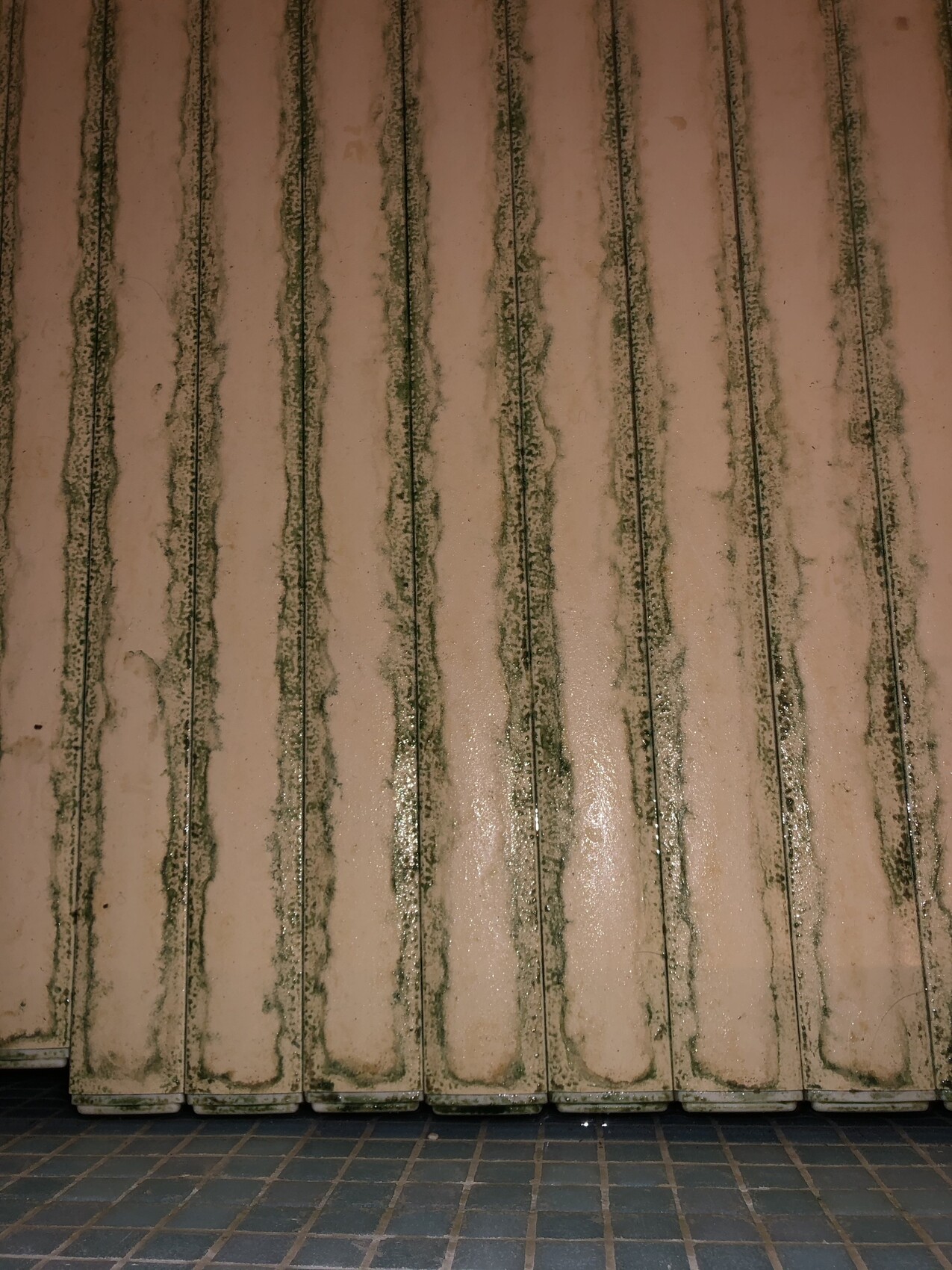

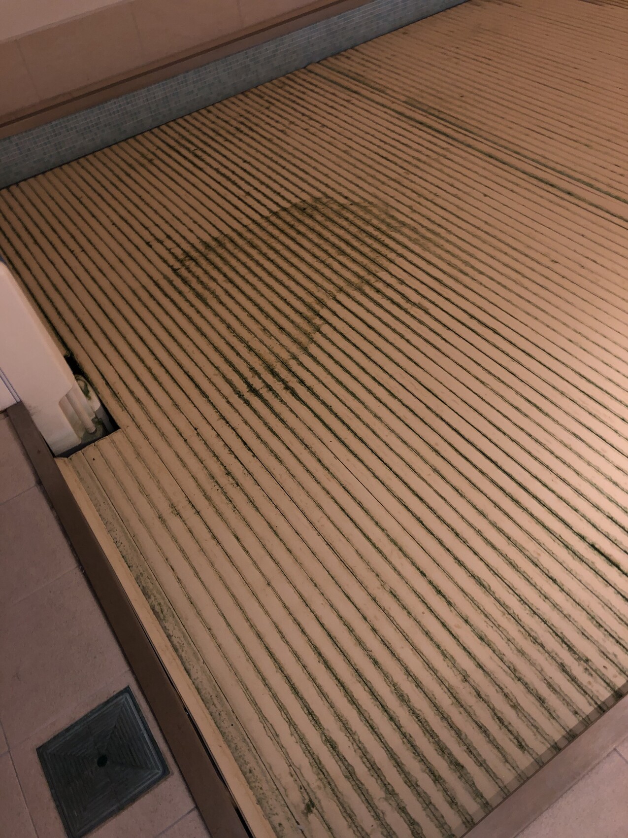

S_t_e_p_h_a_n20 Jan 2021 17:18Hello,
My house came with a pool that still contains water, but the system is currently not in operation. As a result, the water looks quite unpleasant.
Before I drain the water, I would like to test the entire system and then clean the pool and related equipment.
Question 1: When I drain the water later, is there a risk that wall tiles might fall off because the water is no longer providing counterpressure?
Question 2: How can I clean the pool cover that appears to have algae and what seems to be lime scale? Please see the photo.
Question 3: There is also a dehumidifier in the pool room, which still runs but no longer reduces humidity. Since it consumes 2,000 watts and is 15 years old, it probably isn’t worth repairing. Does anyone have a recommendation for a good device suitable for a pool room?

Could you also please share some pictures of the equipment?
What does the water look like? The cover already doesn’t look very good.
There are cleaning agents, pressure washers, and brushes available for this.
I suspect the water hasn’t been disinfected or circulated for a long time.
Do you have any leaks in the pipes?
The proper procedure would be to drain the water, clean everything, backwash the filter or even replace the sand. Then fill it with water again, adjust the settings, and filter adequately.
It might also be worth considering replacing the pump with a modern, controllable unit. But this can only be assessed once the equipment is seen.
Please don’t just switch it on. The dirty water will quickly clog the filter.
Debris would also settle in the water.
Dehumidifiers always consume a lot of electricity. To give a recommendation, the room volume must be known.
There are also several different systems for dehumidification.

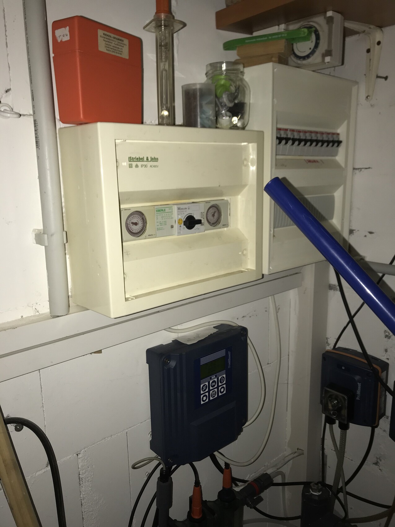

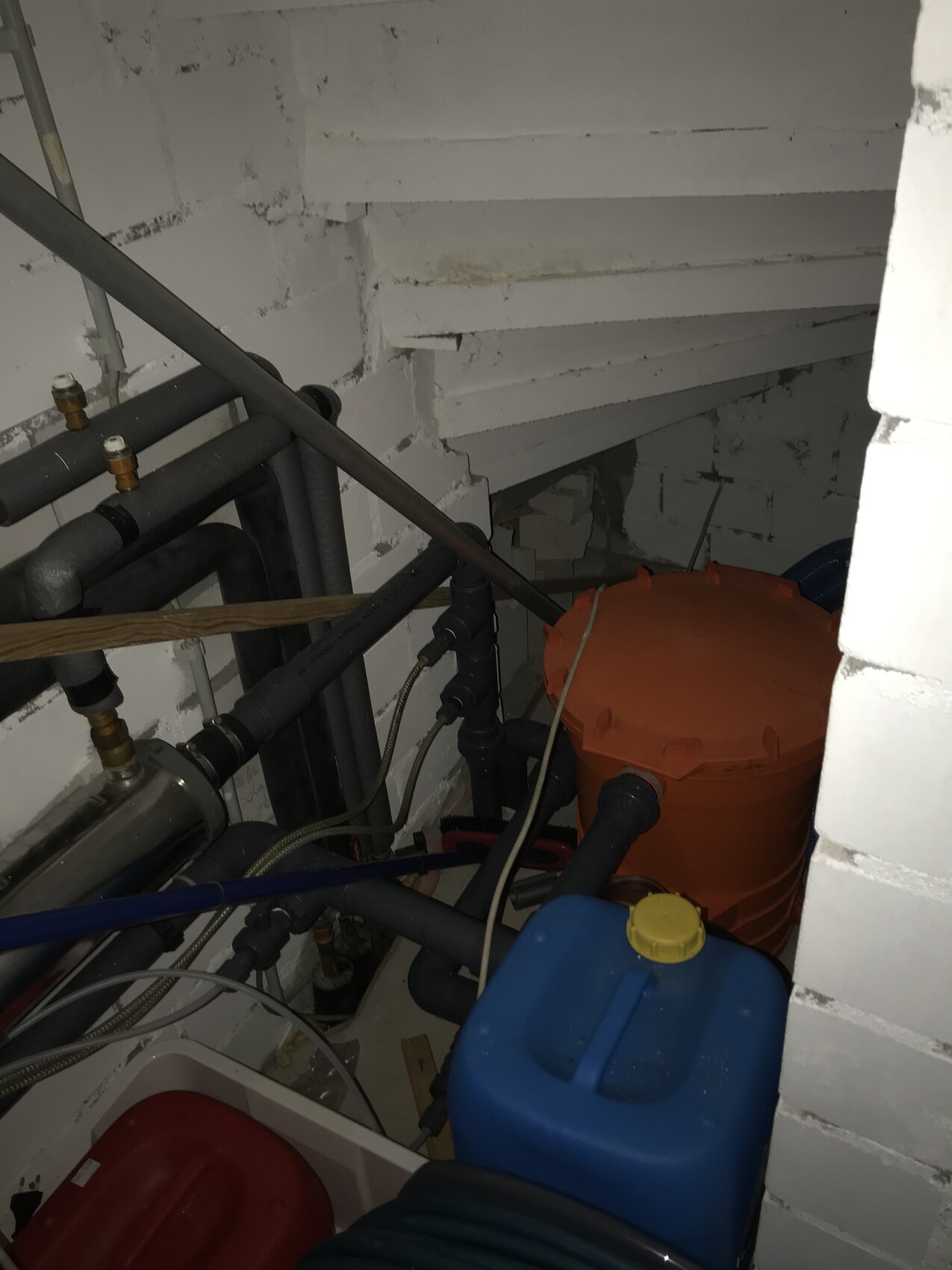

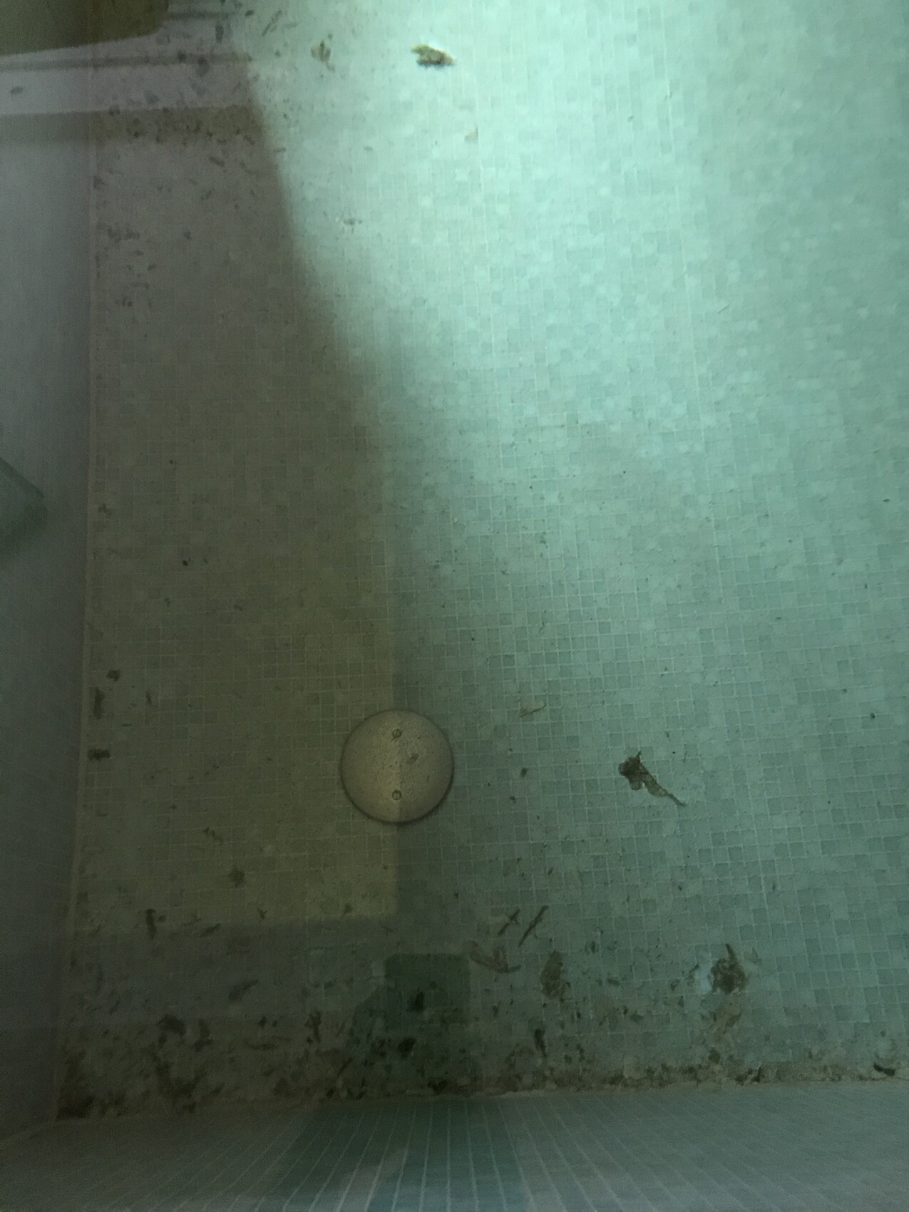

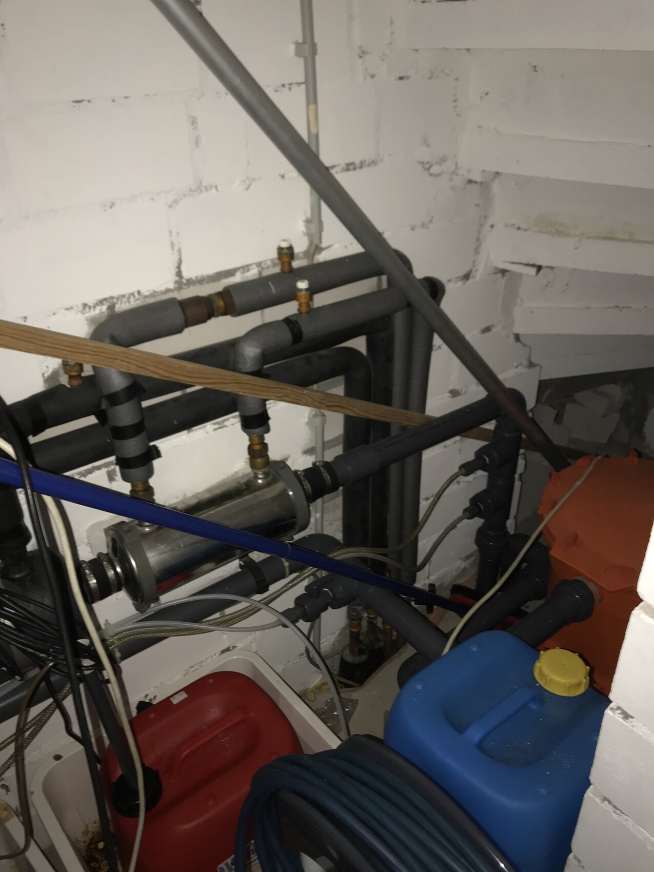

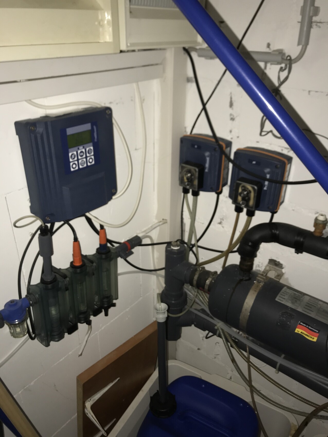

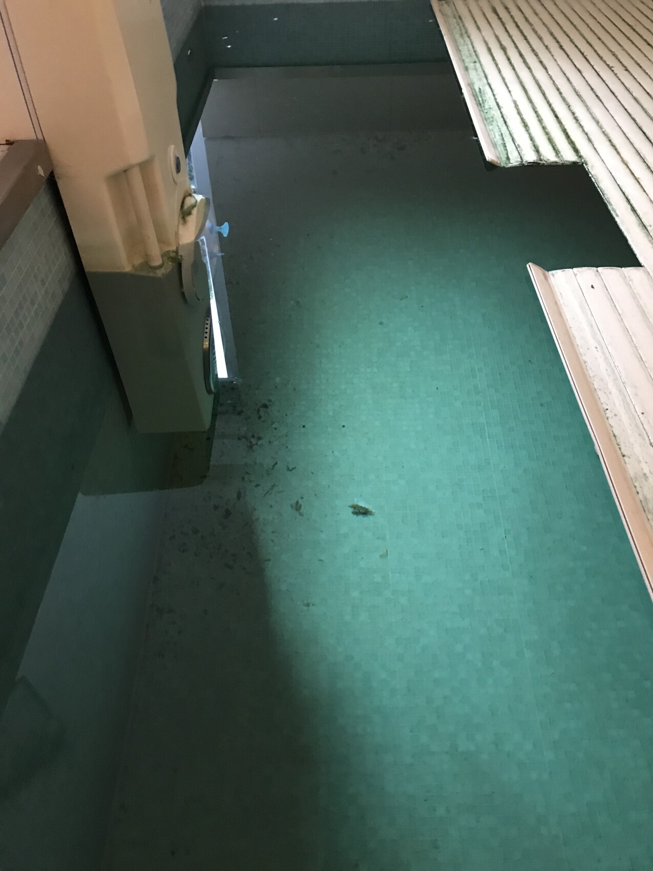

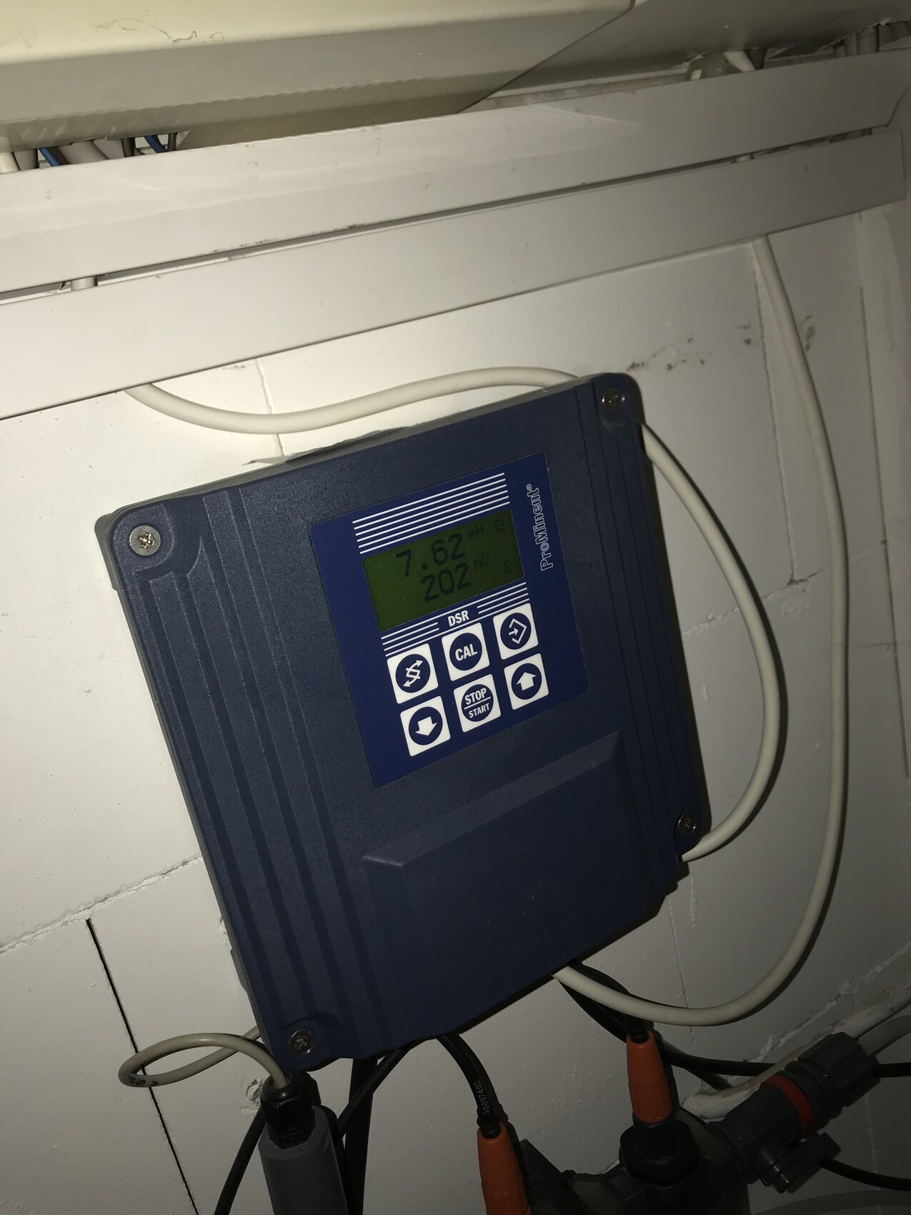

S_t_e_p_h_a_n21 Jan 2021 10:54Hello,
here are some pictures of the technical equipment and the water.
A pH and chlorine test was also done a few weeks ago, and all values were within the normal range (assuming I performed and read the tests correctly).

Thanks first of all for the pictures.
At least the water is clear.
Your pH level is too high. It should be between 7 and 7.2. If it’s higher, the disinfection won’t work properly and can harm the equipment and skin.
Your redox potential (ORP) is way too low! It should be around 720mV. This means the water currently has too little chlorine.

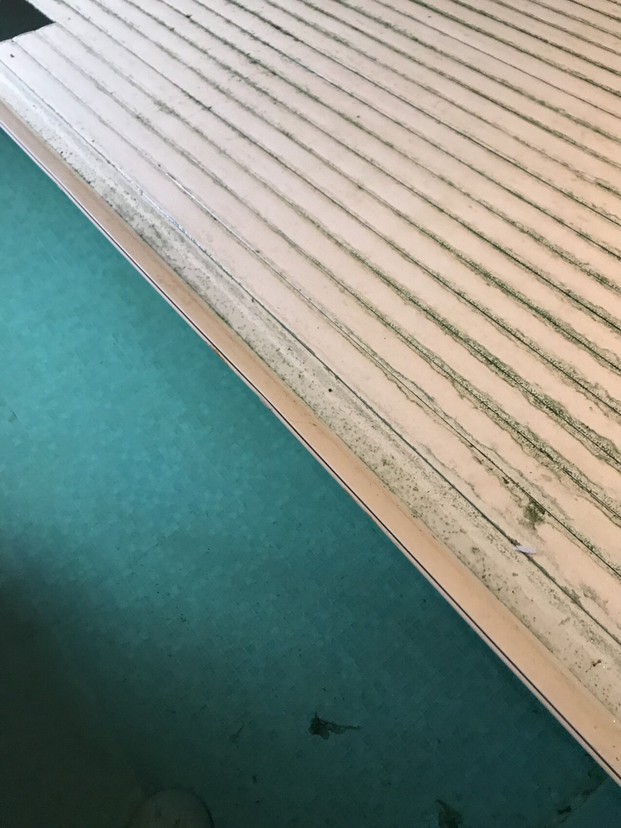

The usual problem is the waterline, where you have the most dirt buildup.
Your control system for pH and chlorine is a very good (and expensive) branded unit.
Unfortunately, the pump and filter are not shown in the pictures. I suspect the pump is housed in the orange container.

I would start by cleaning the cover. There are good branded cleaners from Bayrol or even generic ones. Let the cleaner soak well, then scrub and use a pressure washer. Multiple cycles might be necessary. Only then drain the water and clean the entire pool.
It won’t look like new, but as long as it works and looks better after cleaning, that’s fine. It’s better than spending a lot of money on a new cover right away.

You can find the instructions for your dosing system online. The probes need to be recalibrated.
The timer shown in the picture is probably for the pump.
If the system has been idle for this long, it will be interesting to see what happens. A modern pump can quickly pay off. I see the greatest risk of defects here.
The pipes do not get damaged. The sand in the filter will definitely need to be replaced. Check the seals.
Based on the dosing system, I believe quality components were installed.
