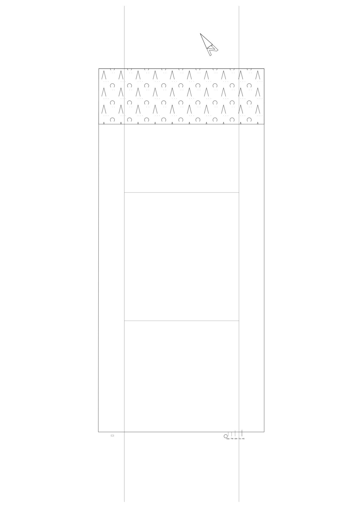

Thanks first for the feedback.
The plot is 20m (66 feet) wide and 40m (131 feet) deep.
The orientation can be seen in the picture.
The requirement is:
Buildable area starts 15m (49 feet) from the property boundary, with a build zone depth of 15m (49 feet).
The door swing directions in the hallway are not finalized yet.
The windows on the upper floor are not square; they are floor-to-ceiling windows.
The utility room is quite small, that’s true. However, I’m not sure where I could gain more space here.
Since a garage on the boundary (9m x 3m x 2.5m) (30 x 10 x 8 feet) is planned and the attic is still available, I don’t see the space issue as too critical at the moment.
The door in the utility room has now been planned to open inward.
The requirement is:
