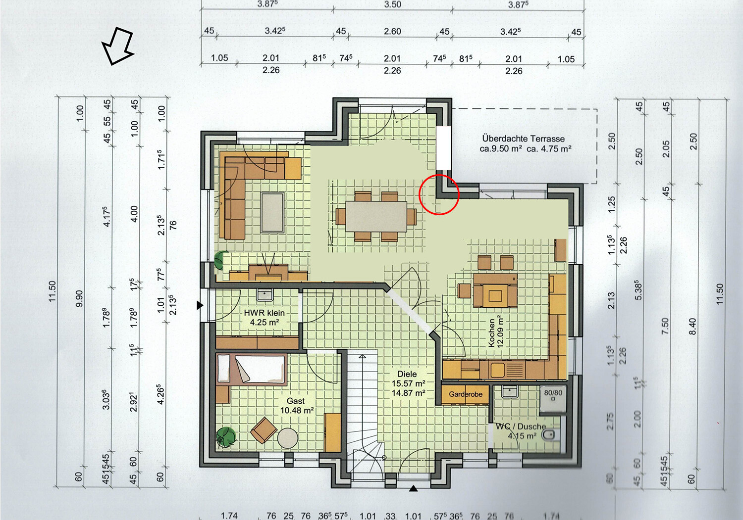

We finally have our plot and are currently deep in the floor plan design phase.
However, since most planners have only implemented our ideas without offering creative or challenging suggestions, we are unsure if we are on the right track.
Therefore, here is our current plan along with some questions.
Thank you very much for any input!

- We are not yet happy with the sofa corner with TV options; corner sofa in the room or in front of the window feels awkward.
- The main entrance is unprotected. We imagine adding a bay window (about 80 cm (31 inches)) to shelter guests from rain. Unfortunately, this makes the staircase tight. We need a good idea here.

1. How to make the sofa corner feel cozy?
2. If the bay window is added at the entrance (see pictures “bay window”), how to fit the staircase underneath?
3. Since we had little real input from the planner: What do you think??

kaho674 schrieb:
I would swap the bathroom with the bedroom, so the missing 3m (10 feet) wardrobe from Yvonne’s critique fits behind the door. Also, exchange the kitchen with the living room, and you’ll have your cozy corner.
I think the idea of adding another bay window is nonsense.
Otherwise, I don’t see any major mistakes or brilliant improvements in the design that would get more out of the plan. If you find it too boring, the only solution is to start over completely. If it works for you, then build.Far too simple not to think of. With the swap, you achieve what you wanted.
I would still fine-tune the bathroom a bit.
A dining table won’t fit in a space 2.60m (8.5 feet) wide; it will simply be too tight. With two children who will be getting up several times in the evening to go to the kitchen, your sofa area won’t really feel cozy anyway. When you have children, I would always position the sofa area somewhat out of sight, otherwise you’ll never have any quiet time in the living room later on when the kids are older.
Sabine
Sabine
How does the *ahem* "modern" front door find its way into a house that could be classified as a 'Frisian house'?
Helix schrieb:What exactly does that mean? - Thin facing bricks?
Flat tiles
Helix schrieb:What is the reason behind that?
The angled passage to the living area is a deliberate choice
Helix schrieb:
For the bedroom, we considered building a partition wall to create a walk-in closet area with plenty of wardrobe space and a vertical strip window for natural light, but I'm not sure if it will become too tight (see attached image)?! Where is the extra space supposed to come from? Wardrobes typically need about 60 cm (24 inches) depth, with at least 90 cm (36 inches) clearance in front of them... that already makes 210 cm (83 inches) out of 440 cm (173 inches). That leaves only about 20 cm (8 inches) of clearance between the bed and the wall. Swapping the bathroom layout would definitely be a better solution.
Personally, I would also swap the living and kitchen areas.
Also, I agree that the bay window area is too narrow for a dining table.
Helix schrieb:
The idea of swapping is so simple that no one thinks of it. ypg schrieb:
Far too simple to come up with. The swap achieves exactly what you wanted. Funny, to me it really stands out when looking at the misaligned patio door.
I also find the bay window space for the table too narrow. The question is whether it really has to be used for the table. If the sofa isn’t too oversized, maybe the table could be placed crosswise instead?
(sorry, the patio doors got messed up during editing; please imagine there’s an additional window in the bay instead.)
I really dislike that awkward deep corner that protrudes into the room. That makes me wonder if I shouldn’t cover the terrace differently, push the kitchen back up, and end up with a much more classic layout than originally planned.
kaho674 schrieb:
Strange, I think it really grabs your attention when you see the misaligned patio door.A lot caught my eye, for example the unnecessary tile pattern... and that slanted wall I really dislike: my eye just gets stuck there, and I wonder who would design something like that. Then I close it.
