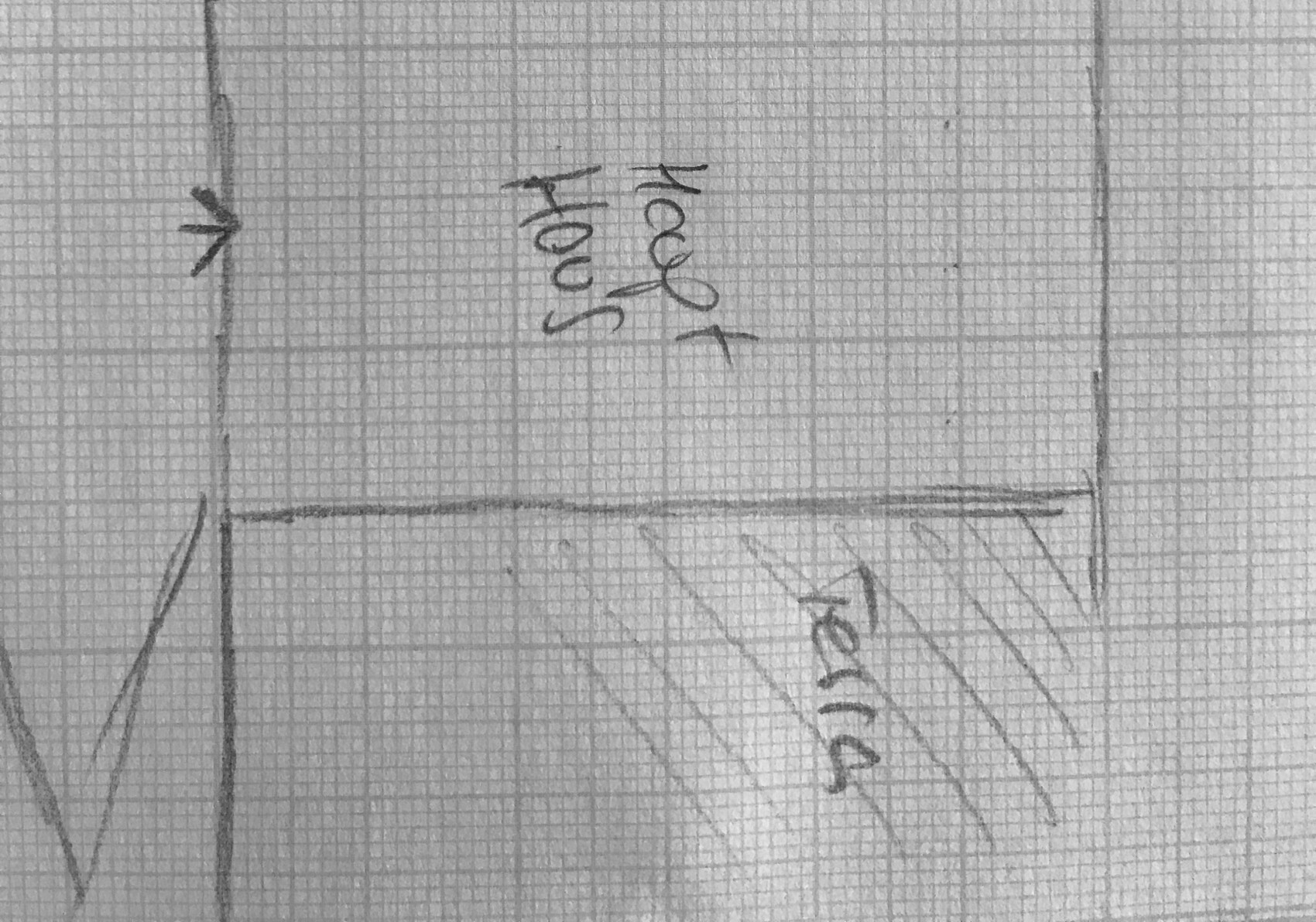

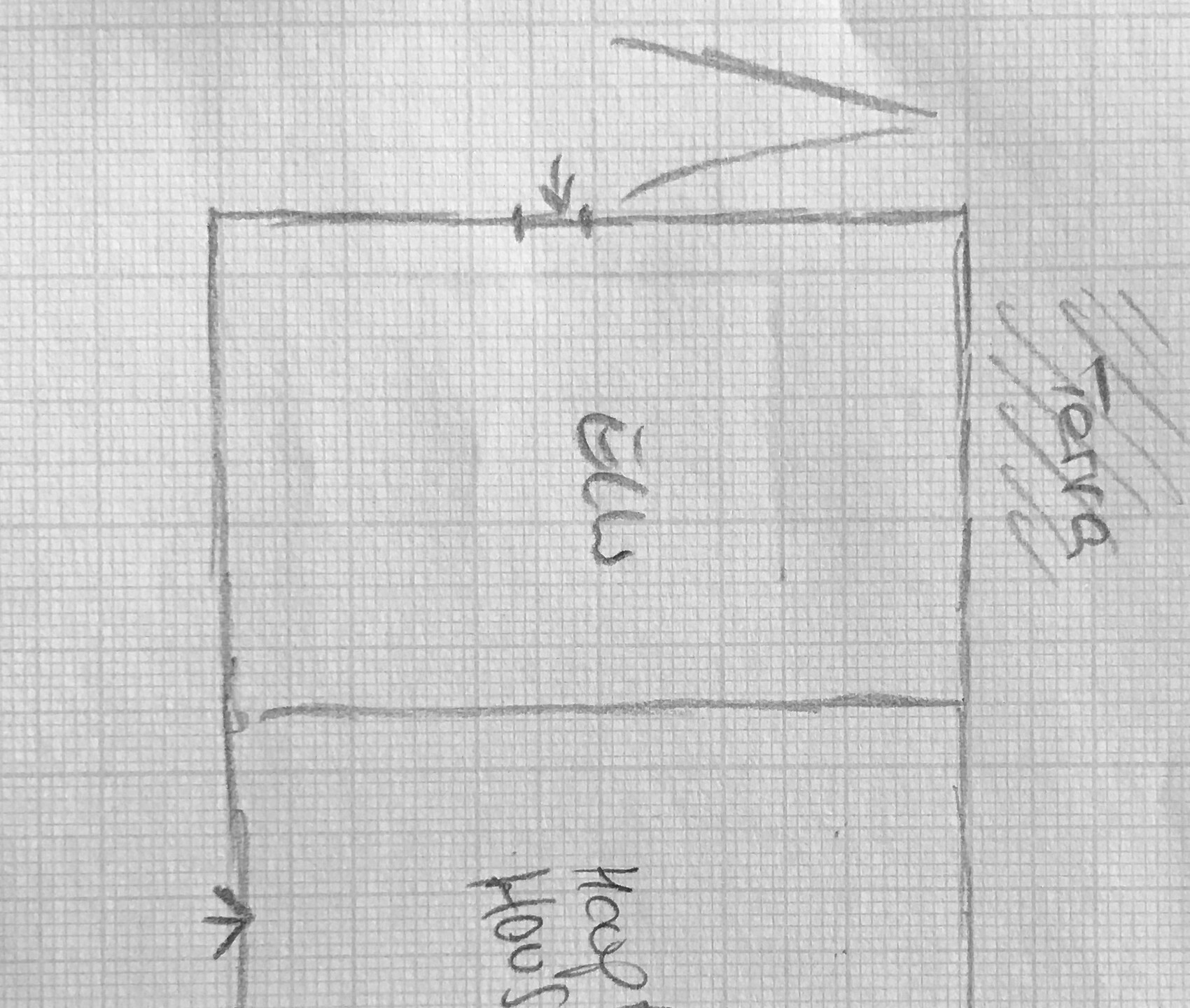

Unfortunately, I can’t upload the entire sketch here, so I had to split it up.
So: my suggestion is the simplest and most cost-effective. Of course, you can also work with L-shaped designs, staggered layouts, etc.
Ultimately, it depends on the plot. The plot shapes the house!Thank you for your sketch. Regarding the plot, we have quite a bit of freedom. I have also posted the site plan here.

I find it hard to imagine a house where a granny flat has 80 sqm (860 sq ft) on the ground floor, and the main house has about 70 sqm (750 sq ft) on the ground floor and 90 sqm (970 sq ft) upstairs. Which roof shape would suit this? So 80 + 70 = 150 sqm (1,615 sq ft) total on the ground floor would quite reliably result in 90 sqm (970 sq ft) in the roof space above both, with a gable roof.
fullkehr schrieb:
It should definitely not look like a duplex. The granny flat should be inconspicuous. If both conditions are to be met, you can’t just place them side by side like a garage.
Also, the above calculation fits “classically” like a glove—any deviation would cause complications to still make it work.
You could render one part and use brick cladding on the other (or vice versa), and many other options.
