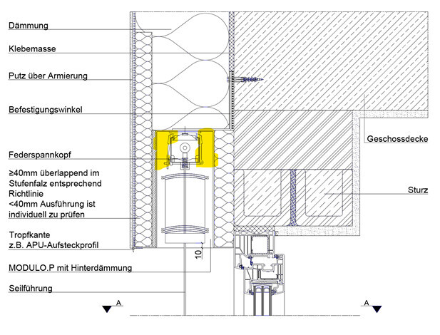

Unfortunately, I made the mistake of not installing the cable for the motors inside the ceiling beforehand. My window installer has now suggested attaching the cable to the exterior wall. On each floor, you can simply run the cable once along the outside wall and connect the motors. Since we are getting exterior wall insulation (ETICS), the cable can be well hidden. As far as I know, this is also done in passive house standards to avoid too many drillings through the exterior wall.
The motor is equipped with a Hirschmann connector. I can unplug this connector inside the box and remove the motor. So far, so good. However, I also need access to the terminals, and here I am uncertain. The window installer says there is some space to fit the terminals. The “passive house standard” apparently also does it this way, but there are opinions that there isn’t enough space to install everything properly. The Hirschmann connector also requires space.
Here is the technical drawing of the box. The yellow areas are supposed to be about 30mm (1.2 inches) wide and 40mm (1.6 inches) high. The Hirschmann connector and the terminals should fit there.
Cross-section of window installation in masonry with insulation, adhesive, and plaster over reinforcement.

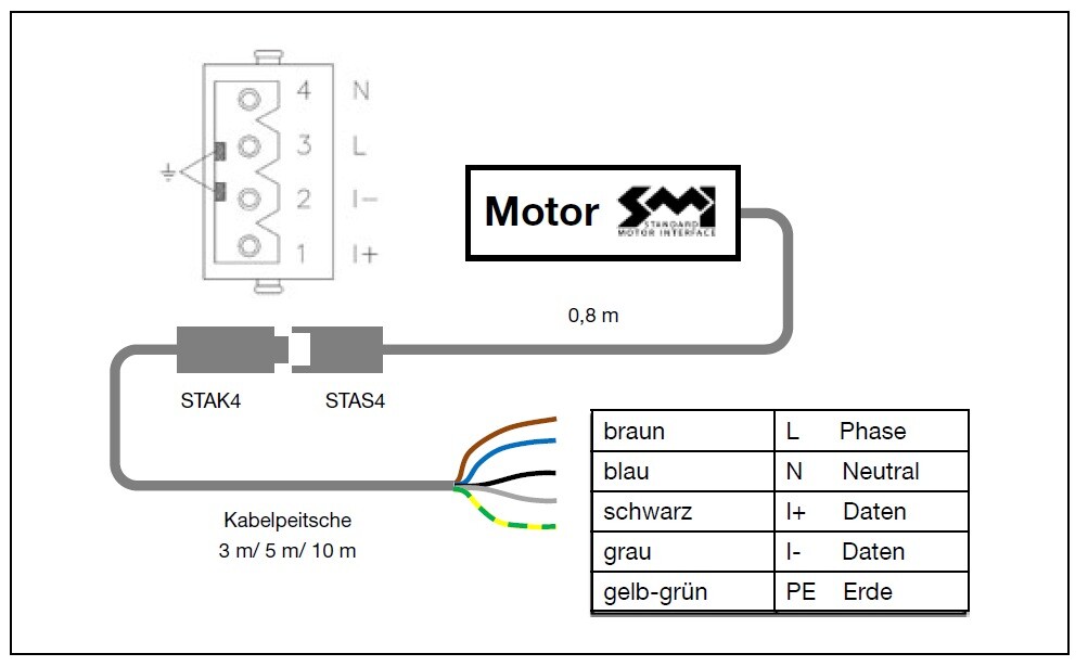

And here is the drawing of the motor:
Motor connection diagram STAK4/STAS4: cable colors brown L, blue N, black I+, grey I-, PE.
My idea is to use a 5x 1.5mm² (5x 16 AWG) cable along the exterior wall to control each motor. I would leave a sufficiently long cable going into the box (and one going out) so that I can comfortably clamp the cables under the box with the motor. Then, I would carefully work past the slats and connect the cables to the designated areas. If necessary, I would use tape or something similar to prevent the cables from slipping down.
What do you think, will this work? I know it won’t be fun, but I assume I will only do this once, and if I ever need to access it again, it should still be reachable. Certainly, I could also install a junction box inside the house, chase channels, drill holes, and run cables from room to room… but if I can conveniently install along the exterior wall, why not?

I don’t see anything that shouldn’t work here. However, I would consider monitoring the total length of the ring and, if necessary, installing multiple supply lines.
