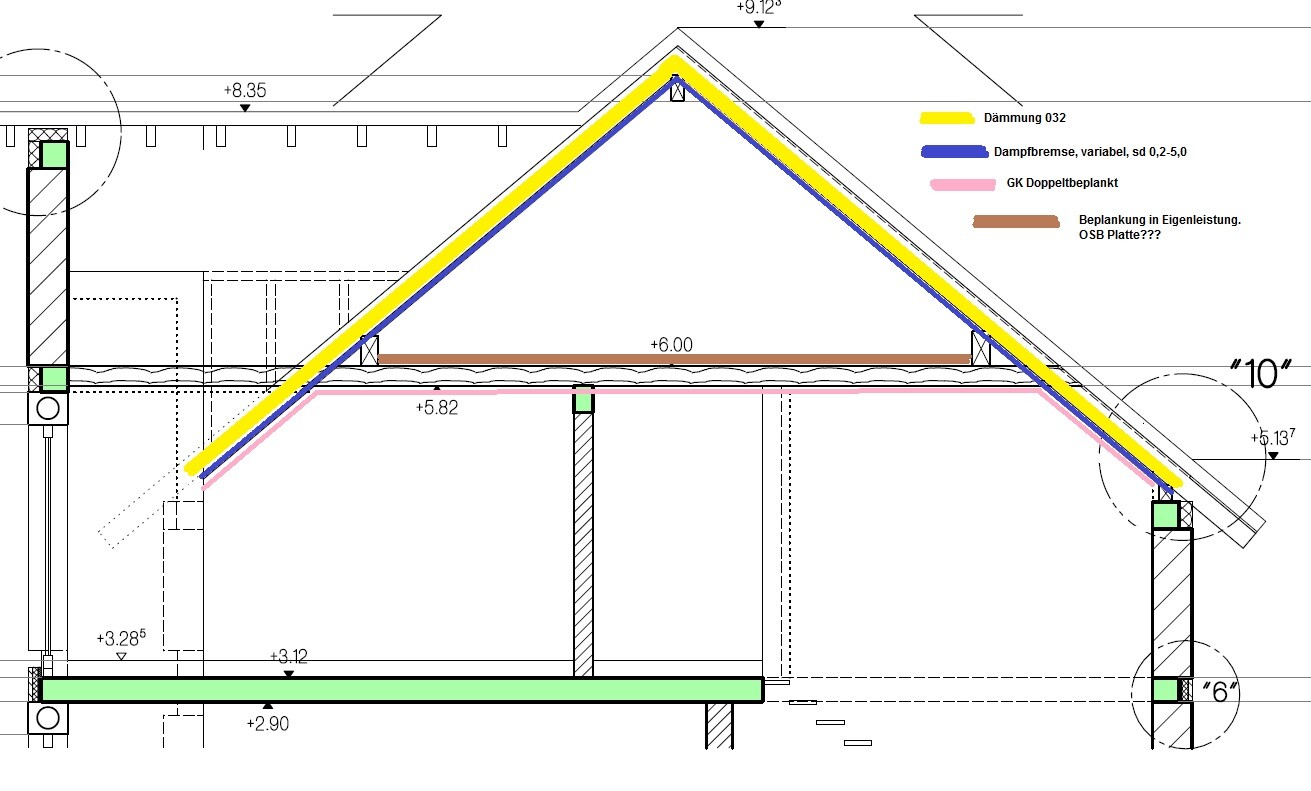

Hello, is this topic too sensitive? Or did I express myself unclearly?
I made a drawing. It concerns the brown line. The question is whether I can simply screw into it, or if, for some reason, an additional vapor barrier is needed, or if I don’t need one because there is already a complete one on the outside. At least that’s how I understood it.
Regards, David
Regards, David
