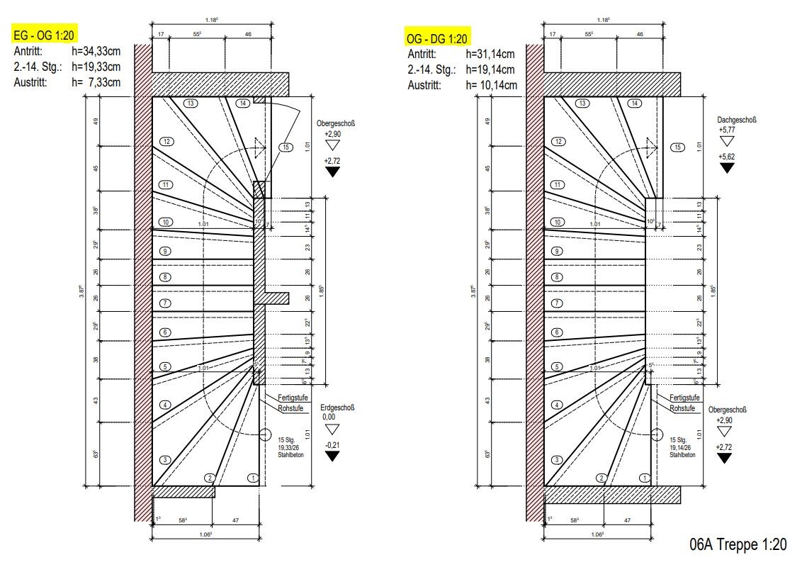

We need to clad 2 staircases, each with 14 steps. I have attached the staircase plans for you.

Technical drawing of a spiral staircase at a scale of 1:20, showing ground and upper floors.

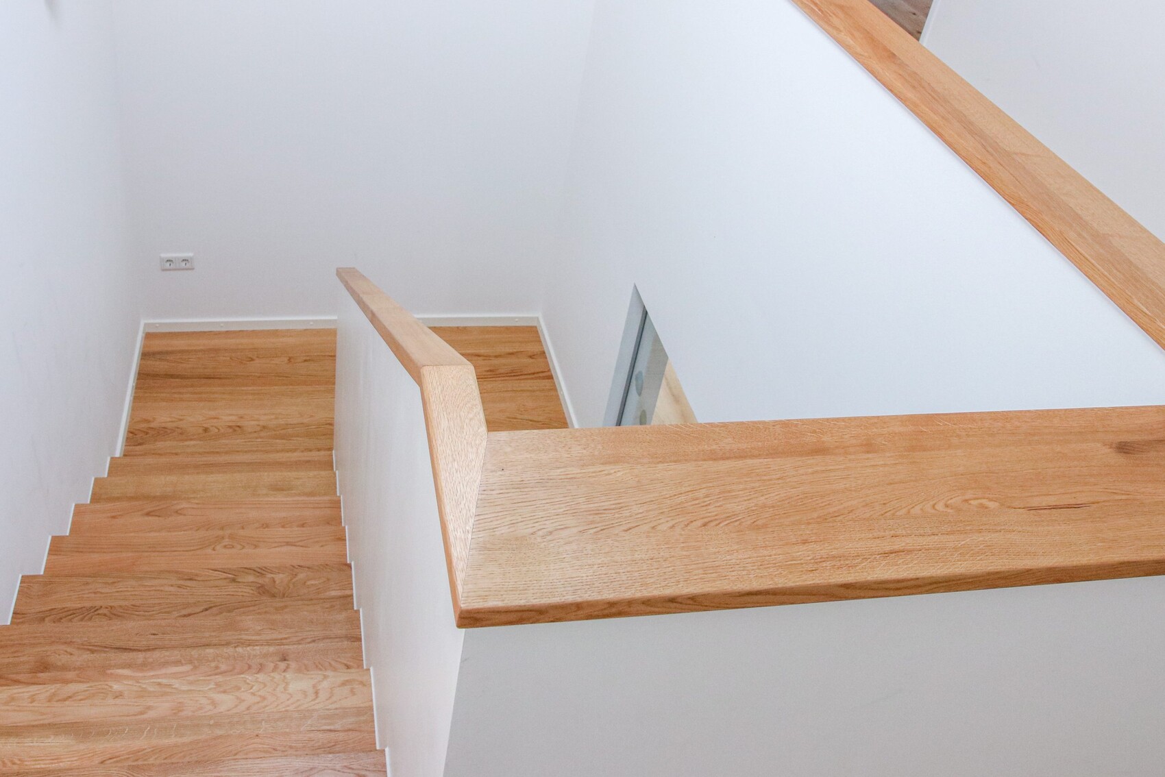

Hi, yes, the treads and handrail are painted (light gray). This was recommended to us since we wanted a light color, and surfaces subject to heavy use tend to look worn quickly if they are only oiled.
We never really discussed the type of gluing or quality in detail. To be honest, I always assumed the pieces were solid wood, but now I know that is unrealistic. I can't detect any typical finger jointing, so I suspect they are block-glued, but I probably can't judge that accurately.
And I assume that if it’s not specified in detail, A-grade wood might not always have been used for the treads. However, you can’t actually see this, and we are very satisfied with both the price and the workmanship.

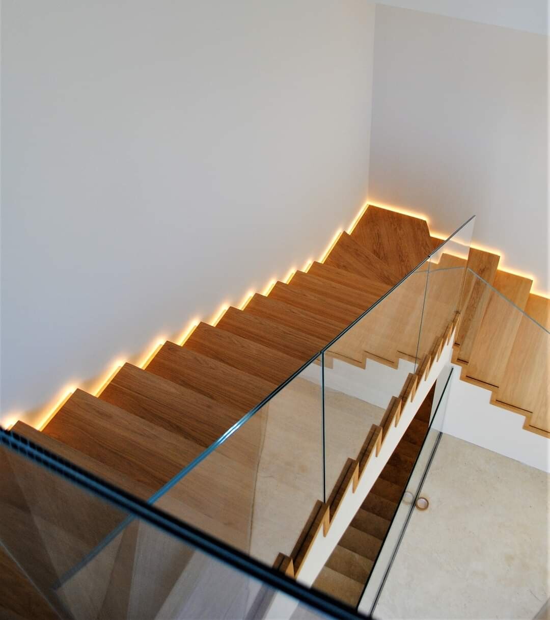

We will also clad our concrete steps with wood. From the start, we already gave some thought to how it should look. It will be an oak stair landing with recessed LED lighting (like in the lower picture). My husband really wanted a glass railing. However, since we have two children and I find glass a bit "uncomfortable," we will simply build up the wall of the storage room (under one stair flight) and place an oak wood panel on the parapet.
The whole project will be carried out by a Polish master carpenter. Total costs (17 steps in brushed and lacquered natural oak, 4cm (1.5 inches) thick, risers mitered to the treads, LED strip recessed into the step, handrail, travel + labor — we will arrange overnight accommodation for two people) — approximately 7000€.
