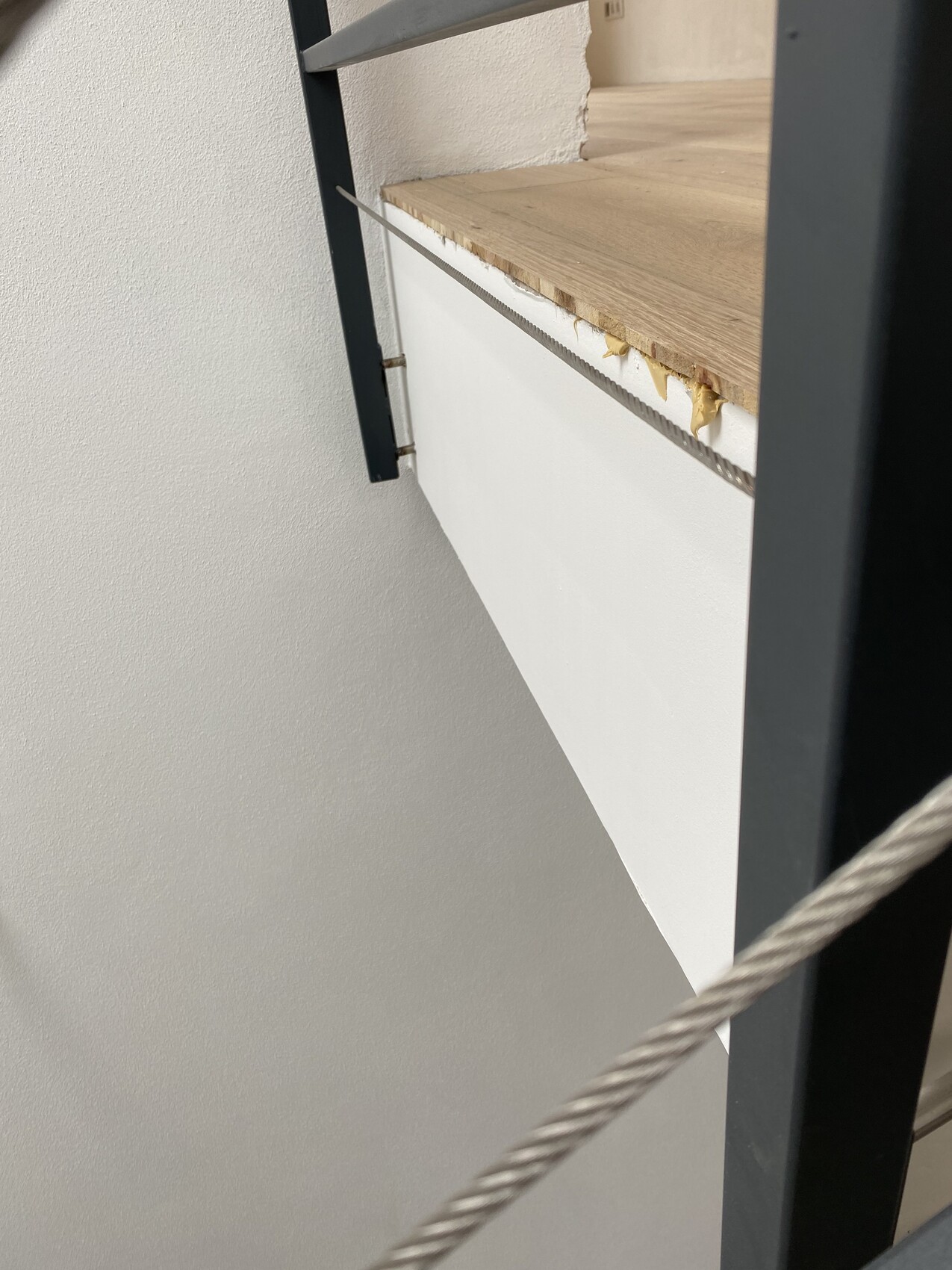

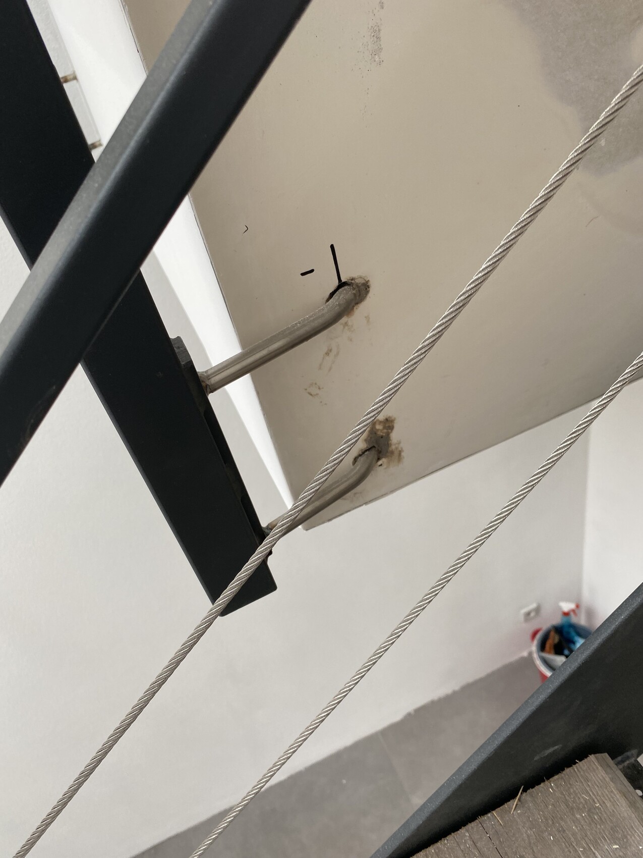

we have a small open gallery and recently installed a steel stringer staircase.
There are screws sticking out now, which doesn’t look good visually. I’ve attached some pictures for reference.
Do you have any ideas on how to fix this?

Tolentino1 Oct 2021 10:24
Glue the entire surface with the parquet flooring? Or use a steel plate, either brushed stainless steel or in the stringer color.
Alternatively, cover it with a drywall panel and repaint it.
face261 Oct 2021 10:36
Who installed the staircase for you? The metalworker/stair builder should have been able to plan this in advance and include a steel stringer or something similar.
1 Oct 2021 11:58
Patrick93 schrieb:
There are screws sticking out now, and it doesn’t look good visually.
Do you mean the two brackets in picture 1? You can patch the plaster with gypsum and paint the brackets in the gray shade like the staircase. That will make it look appropriate again.

As for the side in picture 2: Remove the adhesive yourself using a putty knife and then paint over it with white afterward. Applying something over it beforehand will reduce the aesthetics.
face261 Oct 2021 13:46
...which is why I also wrote that it could/should have been done differently.
I’m not familiar with the background. It’s not very elegant. Who installed the hardwood flooring? If there was no steel stringer or similar support there beforehand, you’d usually install an angle profile or something similar at that transition. Didn’t the flooring installer ask how to finish that edge?
Regarding the side shown in picture 2: remove the adhesive itself with a putty knife and then paint over it afterwards. Applying something in advance ruins the aesthetics.
And what about the seam edge of the flooring? Just leaving it like that?

1 Oct 2021 13:55
face26 schrieb:
And the edge of the parquet? Just leave it as is?
If the plaster edge meets the wood cleanly, I would leave it like that, yes. Why introduce a third material?
