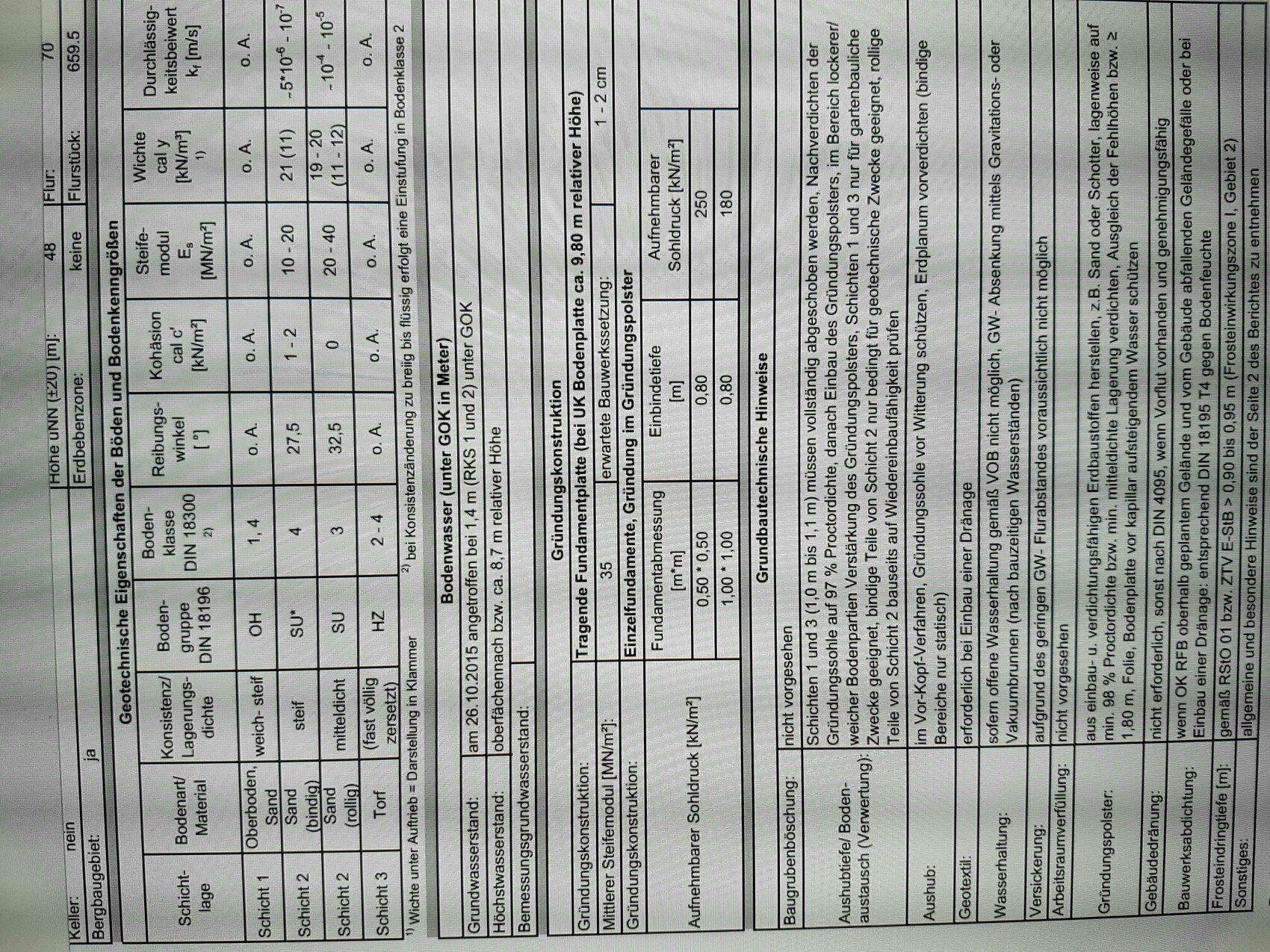

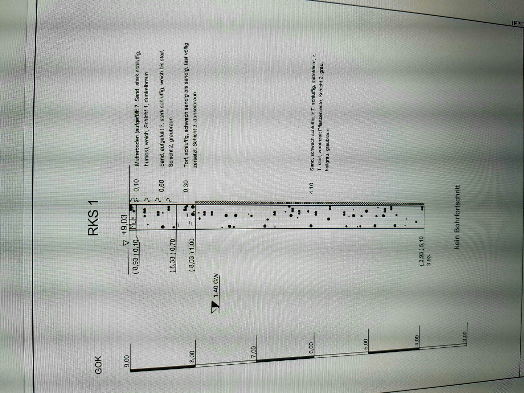

We are building a 14 x 14.5 m (46 x 48 ft) bungalow. The soil report indicates the following layers:
Layer 1: Topsoil 20 cm (8 inches)
Layer 2: Sand, highly silty, soft to stiff, gray-brown
Layer 3: Sand, highly silty, humus, soft to stiff, dark brown to black-brown
Layer 4: Sand, low silt content, partly silty, medium dense, ...
Recommendation: remove 1 to 1.1 m (3.3 to 3.6 ft) and refill with compacted gravel or a similar material.
Now, a groundworks contractor who has seen our plans pointed out that he was not informed about our planned fill. We actually need to build up an average of 1 m (3.3 ft).
He suggested that it would be sufficient to just strip off the topsoil (and possibly some centimeters of layer 2) to achieve a 1.4 m (4.6 ft) gravel layer underneath the foundation slab. If necessary, the foundation slab could be made a bit thicker and the reinforcement adjusted accordingly. This would save us money.
However, our structural engineer insists that everything must be removed as recommended in the soil report.
Now we are uncertain. Both are professionals.

It is best to bring together a structural engineer, a geotechnical expert, and a civil engineer. They should provide you with a recommendation, then the excavation is carried out, and in the end, the geologist performs an inspection of the foundation pit. Only then is it ensured that they are truly liable for their recommendation. We did the same, but in our case, due to the slope, a laboratory soil stability analysis was also included.
