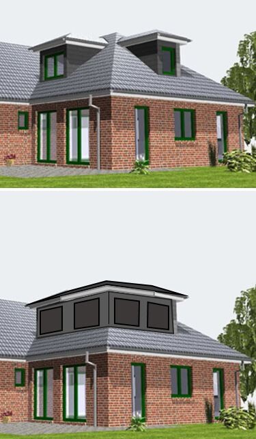

Mottenhausen schrieb:
Mentally, maybe also think of it as a bungalow with a steep roof pitch and a "corner dormer" What exactly do you mean by a corner dormer?
since the roof pitches of the different sections have to be different, For a roof frame like that, you’d need a carpenter experienced with bat-wing dormers. That comes with premium rates.
