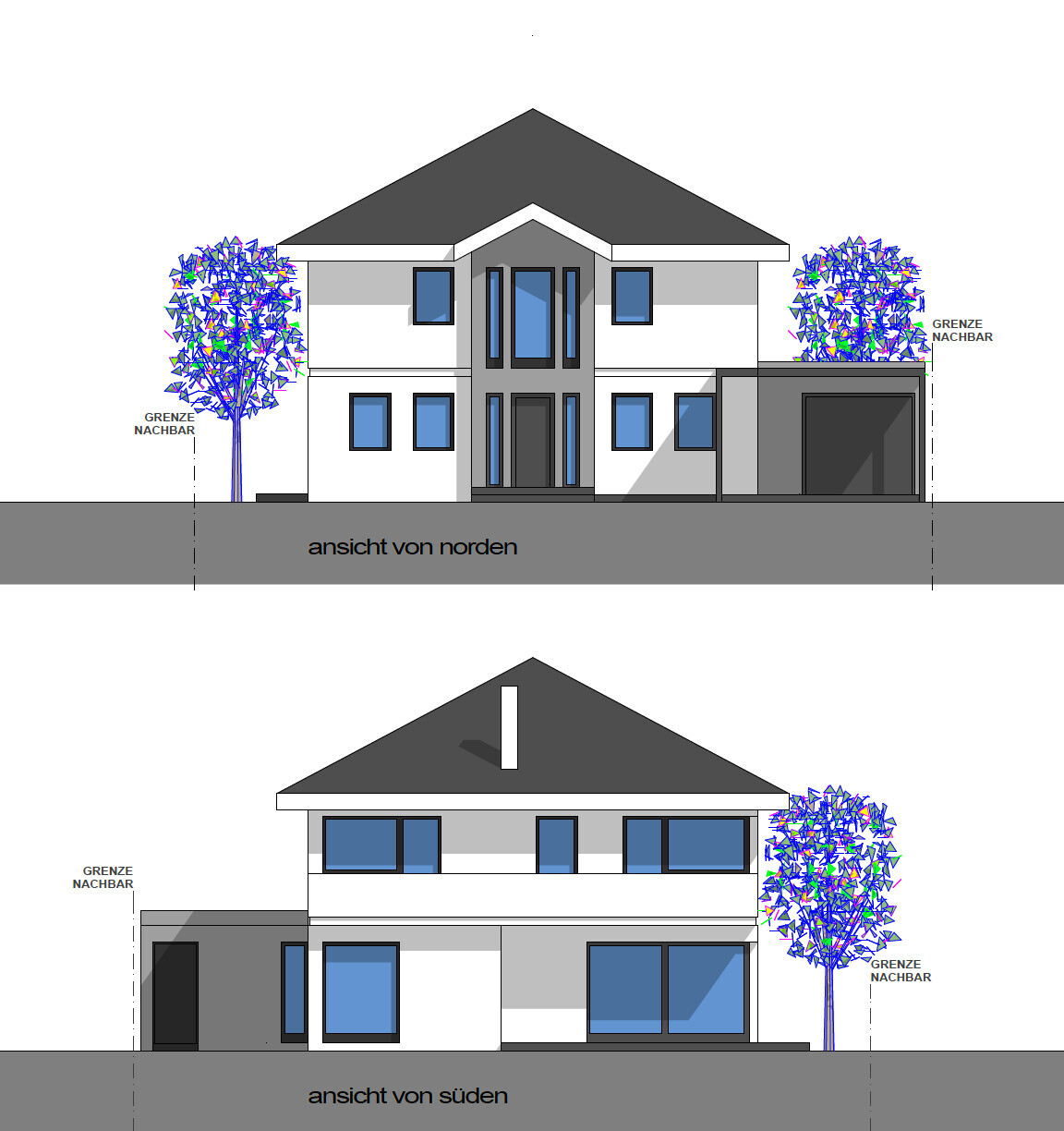

This design looks as if different people were responsible for the house and roof at this architectural firm: roughly speaking, "Bauhaus" with a hip roof. Window reveals are slapped onto the wall planes like in exposed concrete buildings from the 1970s, and the overall appearance of the facade roughly corresponds to the “standard” of the currently fashionable, superficial interpretation of the term "Bauhaus," topped with a traditional half-hip roof. A potpourri from the haunted house of internet image galleries.

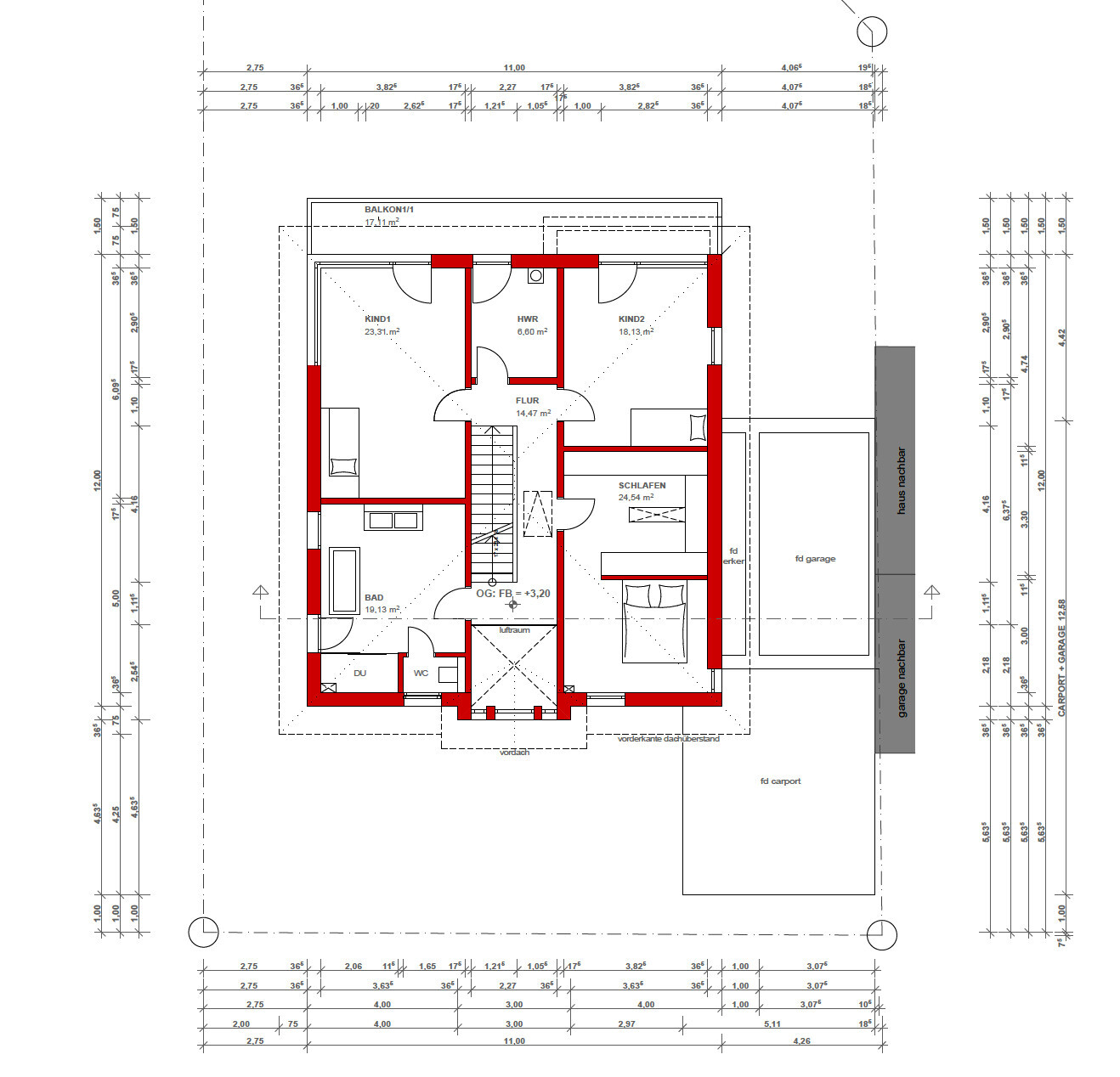

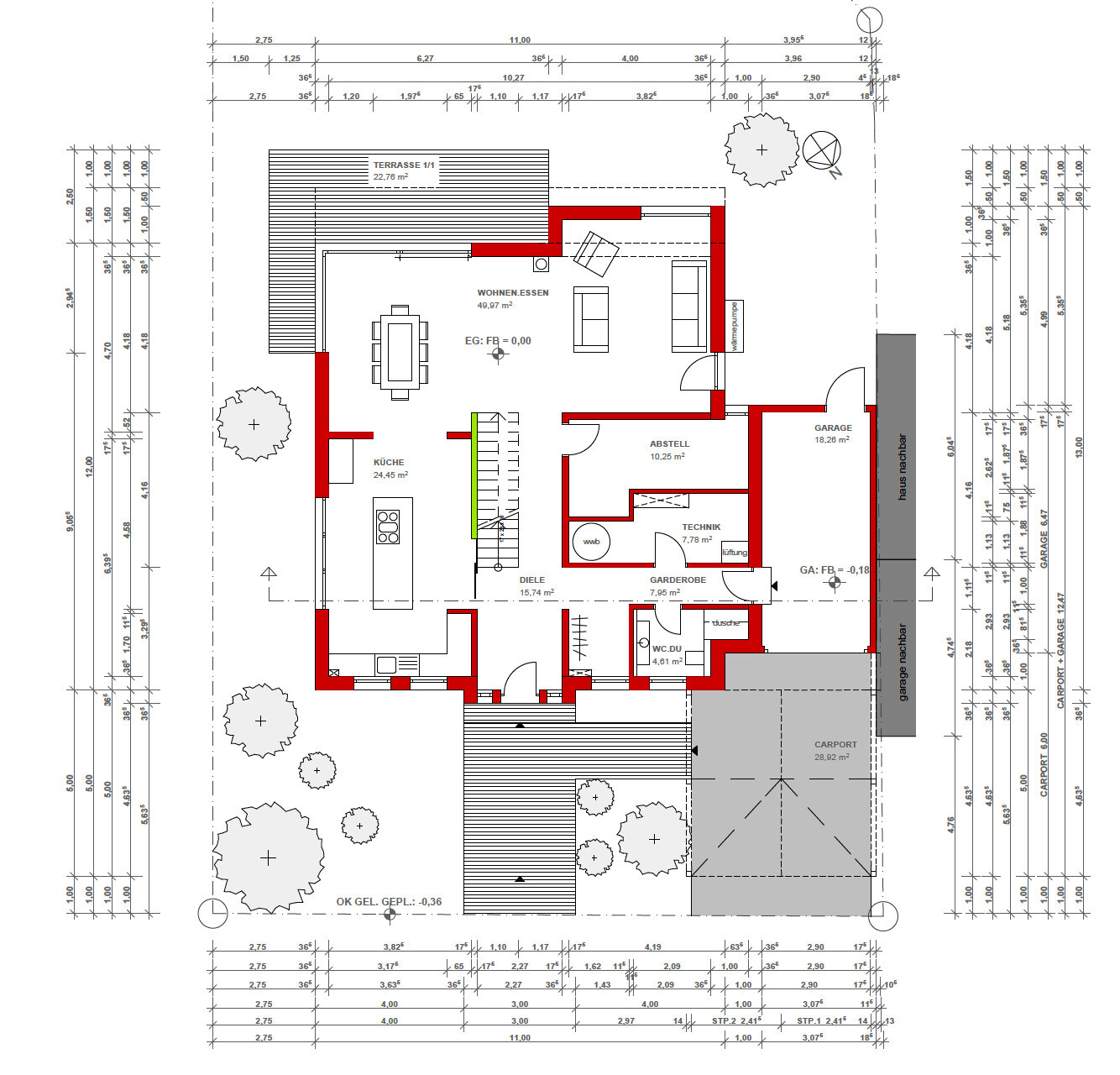

I won’t go into the details of the floor plans yet, as it seems to me that about 20% of the space can still be cut out without much pain. These are nutritionally empty square meters – even the architect hasn’t managed to create areas in the large, hall-sized children’s rooms where you can place anything besides the beds. Against this background, it seems simply too early for specific remarks, such as the fact that a single-step "stair" (at the garage passage) is a tripping hazard.

toxicmolotof11 Apr 2018 22:24After reading through the entire thread, the house simply offers too little usable space given its enormous size. And essential, absolutely necessary areas are being senselessly minimized.
So either reduce the size by 20–30 m² (215–320 sq ft) while maintaining the same functionality, or provide more (and better) usable space.
To quote the users of an environmentally focused forum in their delicate charm: The only thing missing is the acrylic downpipe from the upper floor bathroom running through the kitchen.
Speaking of the kitchen: A view while washing dishes? What kind? At least an unobstructed panorama of the Alps, a lake, or the Brandenburg Gate should be visible.
The roof is just not acceptable. It either needs to be a clear hipped roof or have a wider ridge. What’s shown looks like form follows function. (Although I do find the street-facing appearance with the dormer-like structure quite attractive.)
toxicmolotow schrieb:
(although I personally quite like the street view with that dormer-like feature) I see this here mostly as a purely decorative detail, like a cocktail cherry on a mixed salad of styles – at least without any "Tuscany" elements.https://www.instagram.com/11antgmxde/

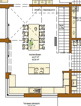

The staircase is meant to be an investment. Regarding its grandeur, a question to the original poster: might it get too little attention and impact in the narrow hallway?
Wouldn’t you rather integrate it into the kitchen/dining area?
Here’s an example from Rensch-Haus (kitchen only):
mrs_bauherrin12 Apr 2018 05:14Thank you for the contributions. We will consider those that suit us and ignore the—quote—"crazy, nonsensical" hasty decisions made by some candidates.
