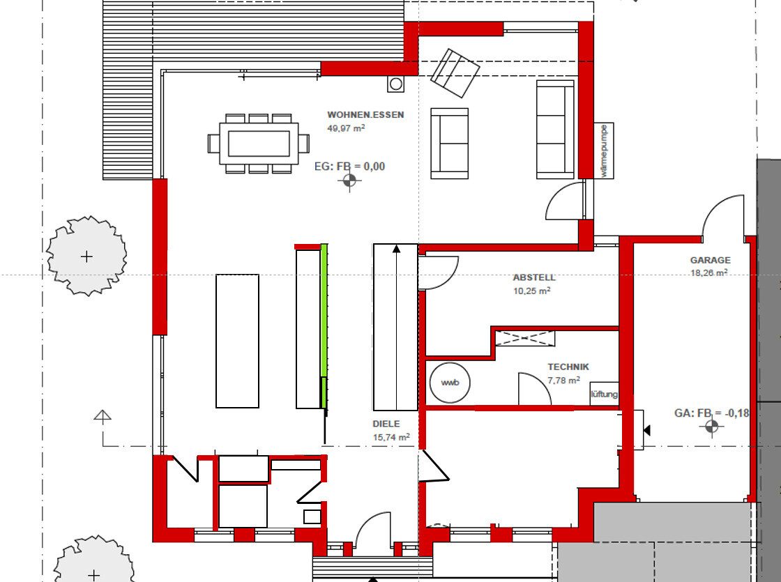

ᐅ Urban villa of approximately 200 sqm without a basement. Please provide your feedback.
Created on: 11 Apr 2018 09:51

Nothing against a large kitchen, but it should definitely be ergonomic... Did you tell the kitchen designer, for example, that the window needs to stay as it is? To me, that’s the main obstacle to an ergonomic kitchen here. The island should be parallel to the main kitchen run, not positioned at a 90° angle. The ideal distance between the two runs is 110–120 cm (43–47 inches). I would also reconsider the dead corner; it’s possible to use it, but it’s better to avoid it.
The long room with the large exterior door along the long side is not ideal for a kitchen. As I said, I would rethink the window setup and, if necessary, move the kitchen run from the wall at the bottom of the plan to the left wall, placing an island in front—which doesn’t need to extend the full length of the kitchen. For example, I wouldn’t put an island in front of the entrance door, but rather pull it toward the dining table and, as mentioned, remove the small wall sections.
Hmm, but will 3.60 m (12 feet) be enough space for the kitchen? Have you thought about swapping the kitchen and living room? The living area doesn’t need such a long narrow space, and then, as Maria already did, you could cut a bit from the WC area... hmm, I have an idea, just a moment, I’ll sketch it quickly. That should also create a fairly large storage room, which you’ll need without a basement (and with two children planned). Direct access to this room from the kitchen and from the garage (if necessary). Also, I don’t quite understand the corner by the shower on the ground floor (near the carport). I’ll make the garage longer, so you’ll also have garden storage and save a corner (which means lower costs!).

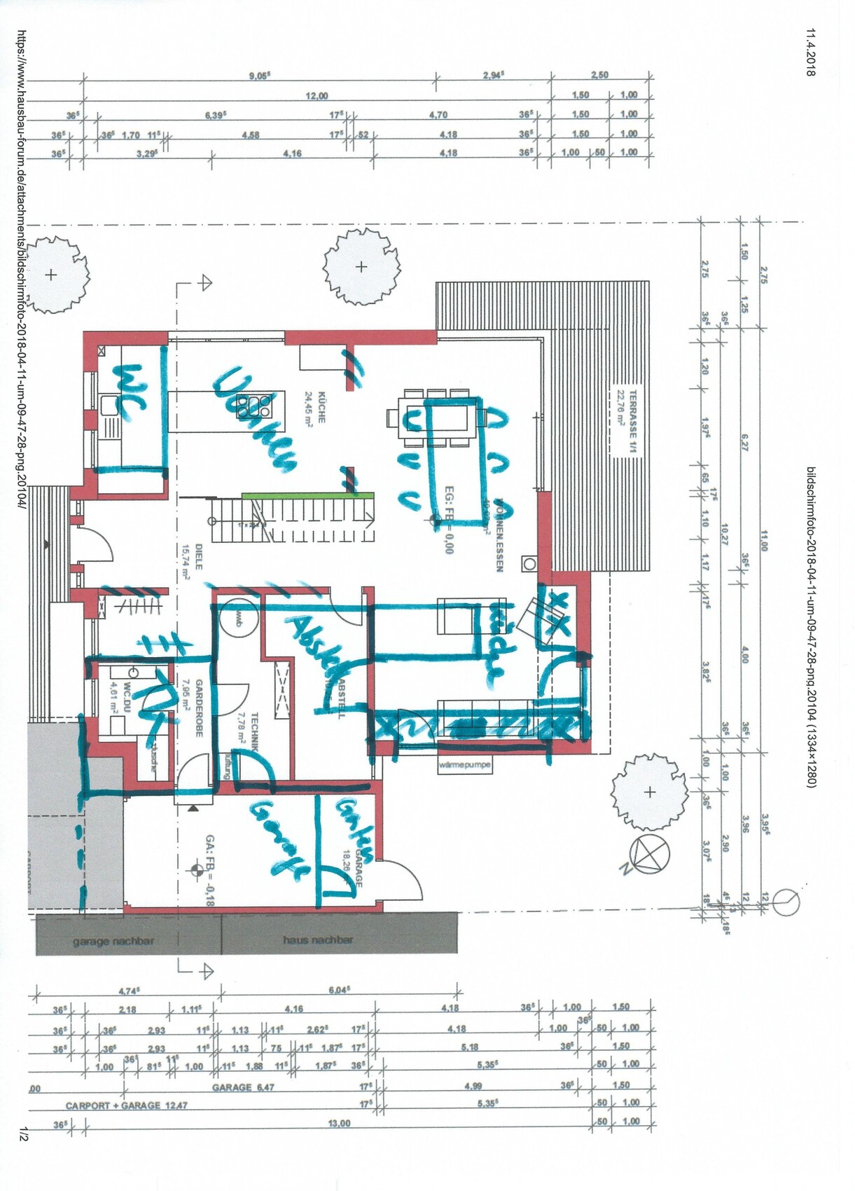

One moment, I’ll upload the drawing shortly:
Unfortunately, my PC rotated the image, but I think it’s still clear: The corner in the bathroom is removed, and the bathroom will become the utility/technical room. The storage area is now really spacious and can be accessed from both the garage and the kitchen. The garage is moved forward, which creates a small additional space at the back for garden tools. The kitchen is arranged in two parallel lines without a dead corner, and the island is about 110cm (43 inches) deep. The hallway (now leading to the kitchen) can be slightly widened at the expense of the storage room, and the wall to the cloakroom can be removed, making the entrance area more open and providing more space when several people arrive at once. Access to the technical room can be either from the cloakroom or from the storage room; however, the storage would then have three doors, which I find less than ideal (or you could do without the garage door to the storage room). For the bathroom, I would also set the wall back slightly to make the entrance area more pleasing.
Windows and patio doors still need to be properly revised, of course. I would suggest a long window above the entire countertop in the kitchen, positioned slightly lower so it doesn’t cause glare while working but still provides a bright workspace. Two tall cabinets can fit into the niche, with a patio door to the garden in between, and the terrace can be extended up to this door.
On the upper floor, I would definitely plan an additional small room, as there is more than enough space there.
mrs_bauherrin schrieb:
At the moment, we have a bed with a width of 160cm (63 inches) plus about 15cm (6 inches) for the frame, totaling 175cm (69 inches). That’s enough for us. You’re welcome to sleep in a 140cm (55 inches) wide bed, but that’s not how you build a house. Maybe you’ll have to sell it or your children might want to inherit it. Then they won’t have a proper bed there. That would be unfortunate.
Overall, one of the clearly better designs presented here. Basically functional, which with the exterior dimensions is not really a challenge, but still.
I would keep the bathroom on the east side. Still, smaller, with an additional room between the children's bedroom and the office.
To do this, the staircase simply moves to the other side of the hallway; in my opinion, there is also enough space for a door to the storage room underneath.
The corridor downstairs is just nonsense.
The walking route from the entrance with groceries to the kitchen is no shorter than through the main entrance. Carrying a fully loaded shopping basket in a 1-meter (3.3 feet) corridor, you’ll easily bruise your elbows.
I would completely remove the second entrance. If you really want it, place it in the storage room.
The bedroom should be planned for a 2-meter (6.6 feet) bed; 1.6 meters (5.2 feet) is too small for newlyweds.
The kitchen is really a major issue; I can’t imagine it being cozy or practical with floor-to-ceiling windows and the rotated island in that large space.
Think through daily practical tasks such as loading and unloading the dishwasher, carrying dishes to and from the dining table, handling hot pans from the stove to the sink, etc.
I am also curious about the outdoor area. Does the terrace face directly south? It would be almost unusable in summer then.
My suggestion:
Kitchen with a large island (which can of course be made even bigger to fit the cooktop and sink), with your side-by-side refrigerator next to it. Adjacent to that, a small pantry. Bathroom and staircase each located on the opposite side. Removed the hallway to gain an additional room:
