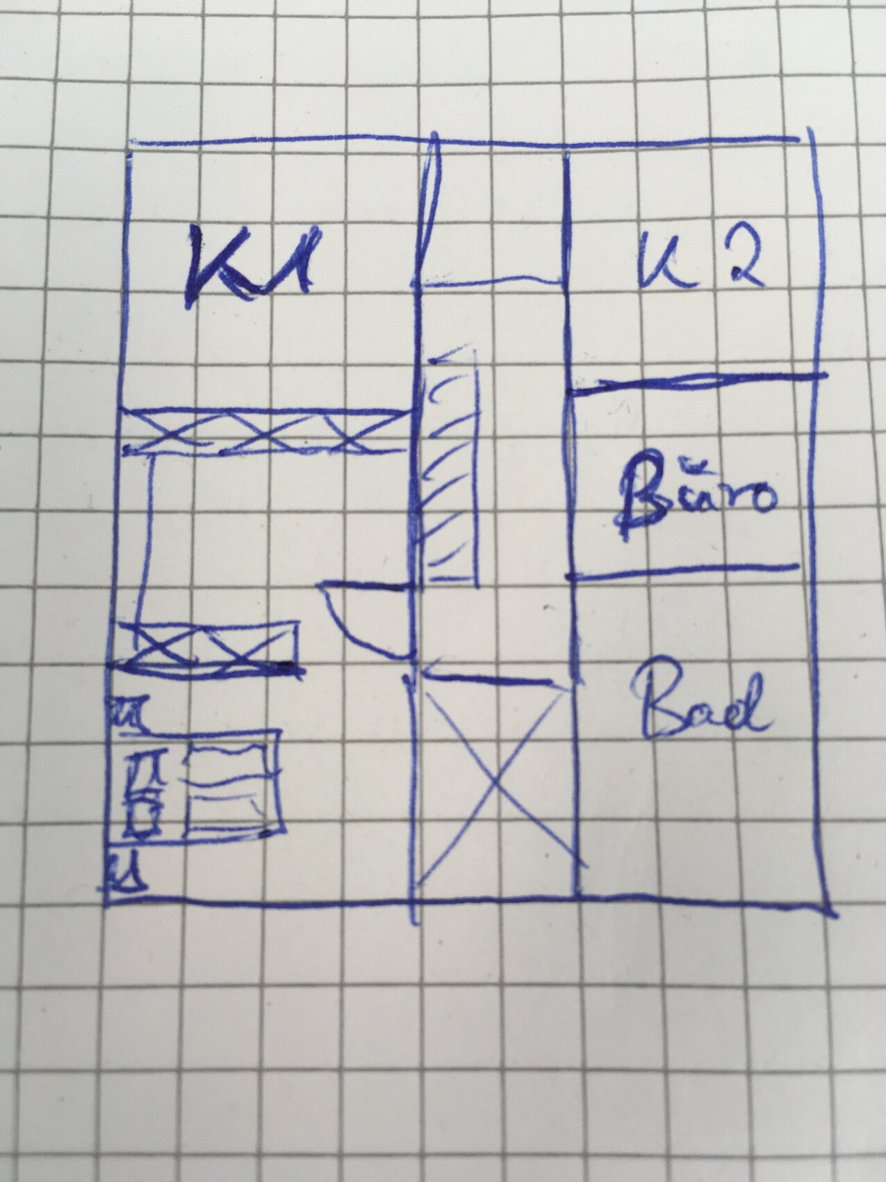

mrs_bauherrin11 Apr 2018 13:00Thank you, Maria,
Bathroom Upstairs
On the left side, the neighbor has no windows facing us, so it’s perfect for a bathroom. On the other side, the neighbor has four windows looking directly in. Since I don’t like frosted glass windows at all and prefer using blinds when I want complete privacy, the bathroom should probably stay on the left side, even though we really like your design because it would give us an extra room.

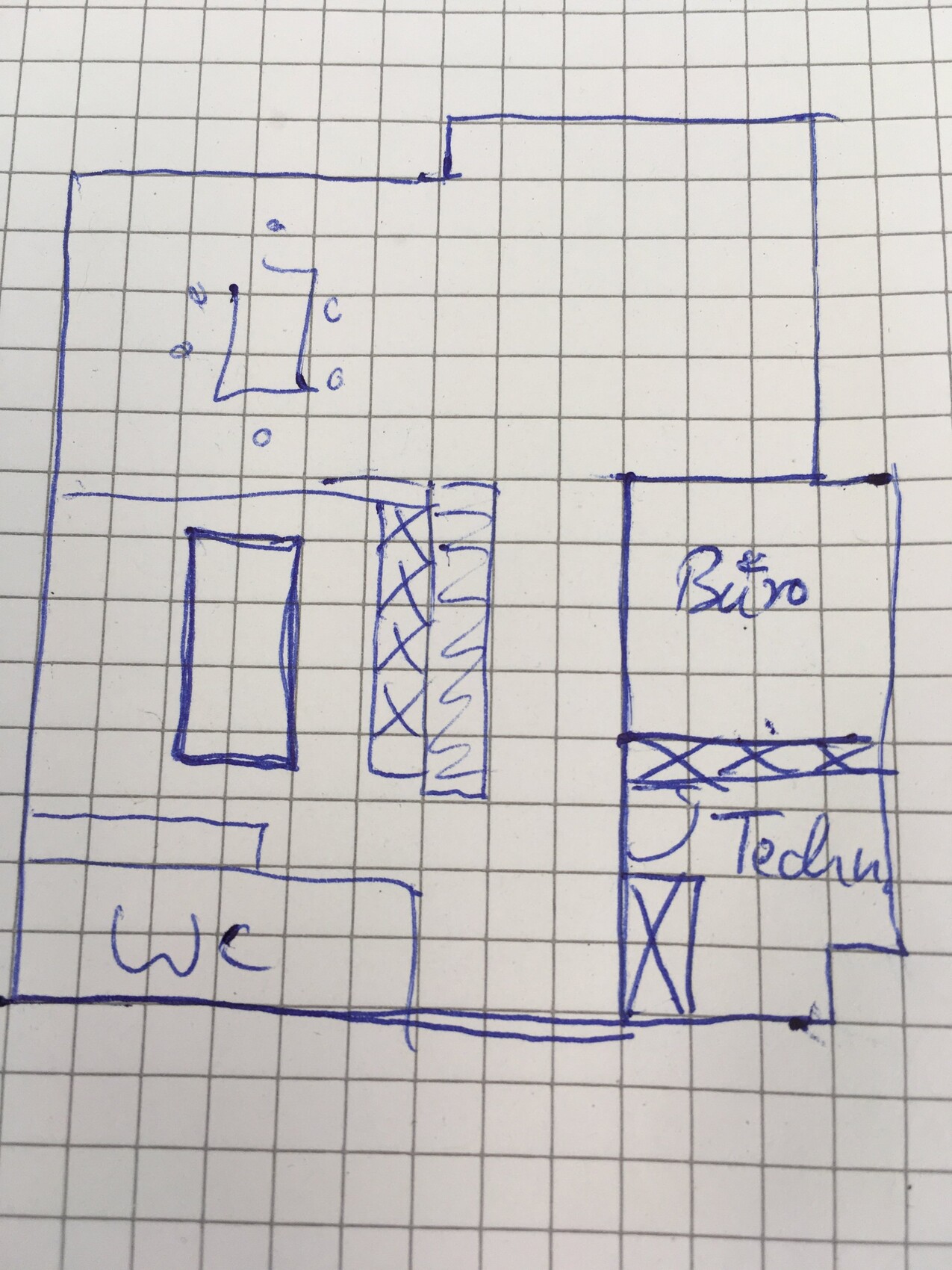

Ground Floor
We are considering removing the access from the garage to the main house. This would allow us to enlarge the shower to 100 x 90 cm (39 x 35 inches) and the utility room.
Kitchen
I’m quite attached to my large kitchen, even though it’s a bit inconvenient in terms of walking routes. I really appreciate your suggestion, though, and will review it again to see if we should move the toilet to the left.
Bathroom Upstairs
... hmm ... is there maybe another option?
Ground Floor
Kitchen
Do you have a large room at home where you could mark out your kitchen layout and test the walking paths in real life?
Almost 25 sqm (270 sq ft) is quite spacious—and also expensive to furnish. Considering that, the functionality might become challenging.
1st option:
If you rearrange the ground floor so that the stairs move to the other side of the hallway, you can also mirror the layout of the upper floor.
2nd option:
You could, of course, keep the bathroom in your preferred location and possibly make it a bit smaller, so there would be room for a dressing area and bedroom instead of the children’s room. You’d need to adjust the windows for the bedroom, of course.
Then you could place both children’s rooms and a small office on the other side of the house. I’m unsure whether the second children’s room would get enough natural light.
