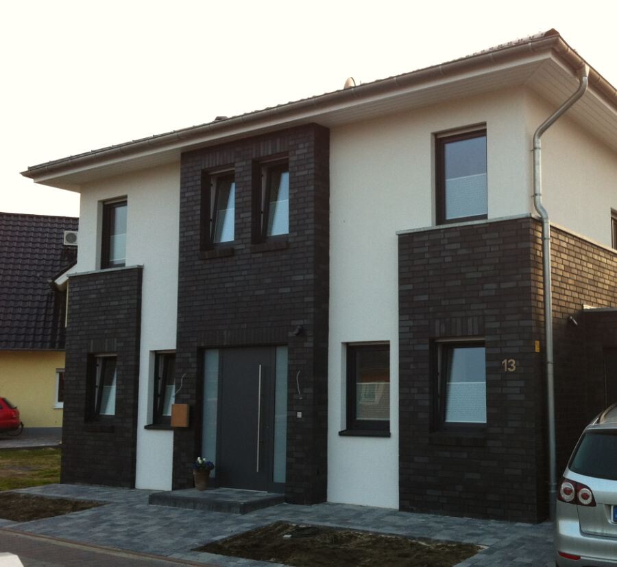

We are not keen to pursue a legal dispute with the city, so my question is whether anyone has a picture of a town villa with a half-hipped roof. We find it difficult to imagine this based on sketches.
A typical town villa looks like this to me (see below, 2 full floors with a 26° pitched roof):

Where did you take the photo?
