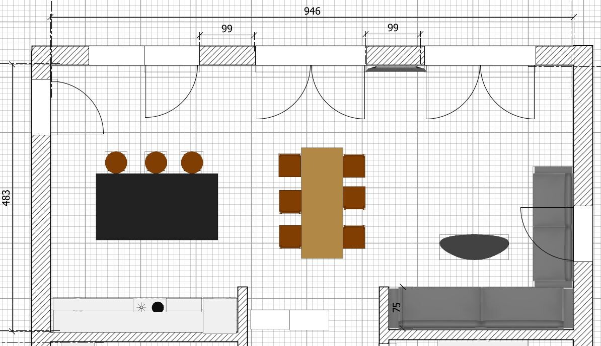

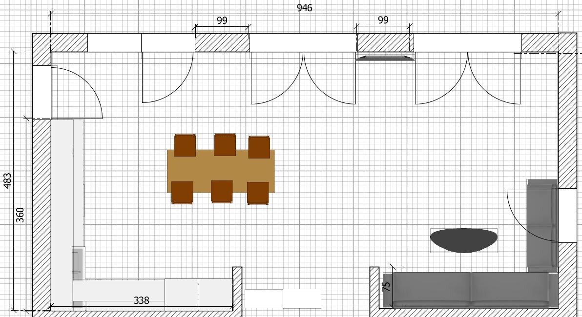

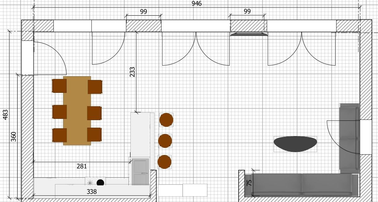

the basement of my house is now completed. For several days, I have been thinking about how to arrange the furniture and plan the kitchen. I am worried that 43m2 (460 sq ft) might be too small.
Our architect’s plan does not include any furniture, so I took the time to create some layouts using Sweet Home 3D.
Questions:
- What do you think about 43m2 (460 sq ft)?
- Which layout do you like the most?
- What would you do differently?
THANKS for your opinions.
Questions:

Take accurate measurements for the table.
Option 1 and 3 don’t work. Option 2 might be possible.
The minimum depth is 80 cm (31.5 inches)
Wall to table edge
For example, if the table is 90 cm (35.5 inches) wide, you need 250 cm (98.5 inches). This means no one can pass a occupied chair without squeezing or holding in their stomach.
Please upload the entire floor plan.
43 sq m (463 sq ft) is quite small.
Wall to table edge
Your table is 70cm (28 inches) wide, if I haven't miscounted. I wouldn’t go below 85cm (33 inches) at all. A width of 75cm (30 inches) for a sofa is also risky. You’re more likely to fall off. Ours is about 95cm (37 inches).
The kitchen should have at least two tall cabinets for the refrigerator and oven.
I would continue planning with OPTION 2. The seating island seems unnecessary anyway.
I can only fault you for approaching the house-building process completely unplanned.
Show me the rest to see if anything still needs fixing.
