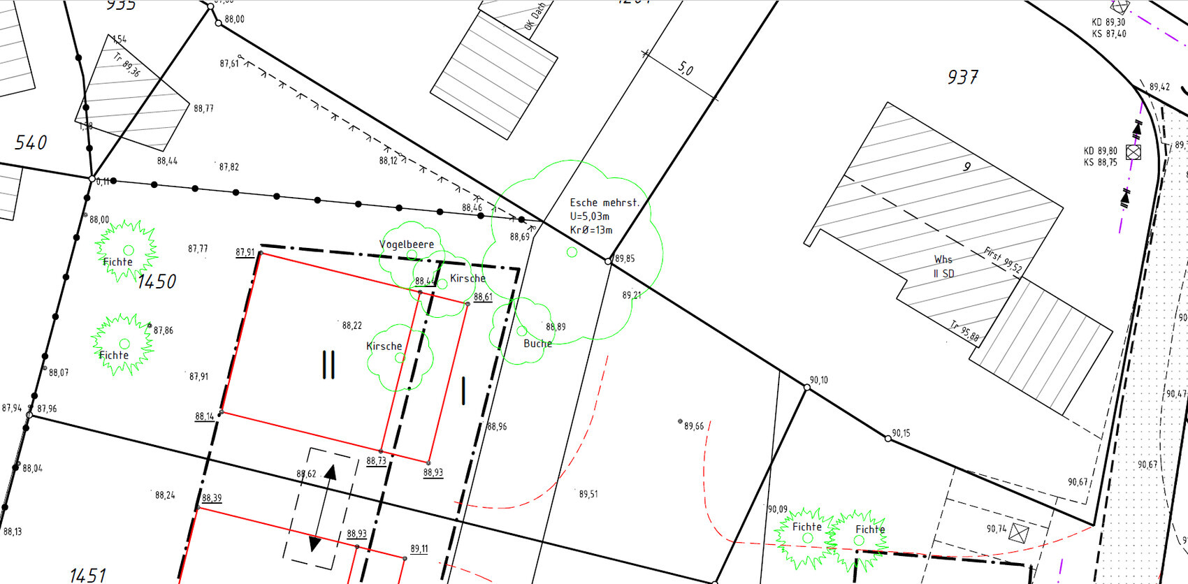

Hello dear forum members,
after reading along for a long time, the time has finally come for us as well.
Since we are always open to criticism, different perspectives, and suggestions, we look forward to your opinions on our floor plan design.
Before entering the crucial phase, the two of us created a self-designed floor plan, and this is the one we want to move forward with.
Now, onto the details:
Development Plan/Restrictions
Plot size: 880m² (0.22 acres)
Slope: Approximately 2m (6.5 feet) between the east and west property boundaries but varying significantly—see surveying documents
Floor area ratio: 0.4
Gross floor area ratio: 0.8
Building envelope, building line and boundary: 13x10m (43x33 feet) for one full story and 10x10m (33x33 feet) for two full stories
Edge development: None
Number of parking spaces: No requirements
Number of stories: 2
Roof type: According to the development plan, pitched roofs are mandatory
Architectural style: Urban villa
Orientation: Main entrance on the east side, terrace and recreational garden on the west side, utility garden on east side
Maximum heights/limits: According to the development plan no specification other than two full stories
Other requirements: Rainwater must infiltrate the plot. According to the soil report, the ground is not optimally permeable. Additionally, some hydrostatic pressure from groundwater is expected. Therefore, we plan to install a cistern to use rainwater.

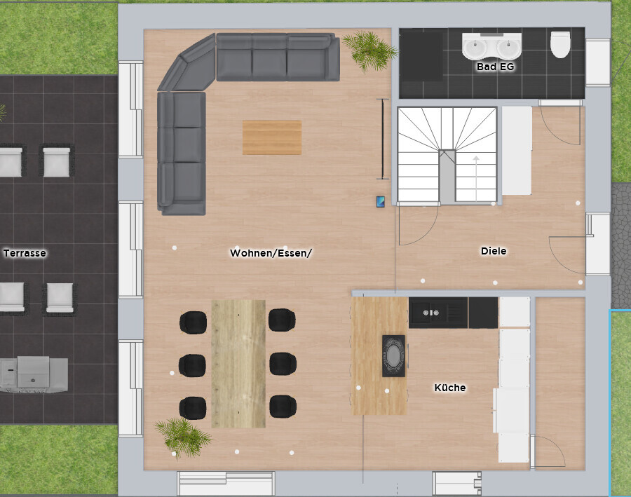

Open or closed architecture: Open on the ground floor
Traditional or modern construction: Modern
Open kitchen, kitchen island: Open with large kitchen island, cooking happens daily, about once a month guests up to 8 people, pantry directly adjacent to kitchen
Number of dining seats: 6-8, expandable with an additional table

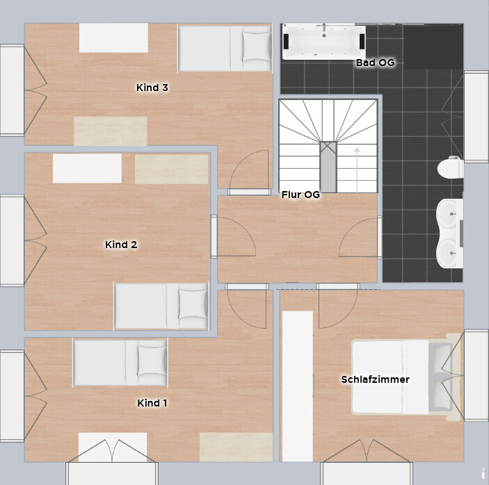

What do you especially like? Why?: Large living/dining area, open kitchen, pantry, three children’s rooms roughly equal in size facing the garden
What do you dislike? Why?: No walk-in closet in the master bedroom

Site plan of a building plot with boundary lines, buildings, trees, and driveways.
Floor plan: open living/dining on the left, kitchen on the right, hall with staircase, bathroom on ground floor, terrace.
Upper floor plan: three children’s rooms, bedroom, hallway, bathroom with tub and double sink, staircase.

Kraj schrieb:
We will adjust to 230 width and 230 depth.
Then the entire floor plan concept is pointless... a lot will change.
If you reduce the width to 2.30 meters (7.5 feet), also consider increasing the whole stairwell niche (with a ceiling height of 2.50 meters (8.2 feet)) to 2.50 meters (8.2 feet)... that’s better.
Kraj schrieb:
A single-sided shelf with a depth of 15cm (6 inches) is sufficient there.
That room will be quite expensive: approximately 4 square meters (43 square feet) at 2000 €/sqm... 8000 €, and the shelves won’t even be able to hold a baking tray. Do you really want such a “hamster cage”?
