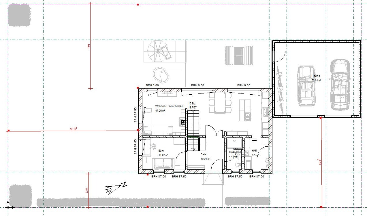

Ground Floor (GF):

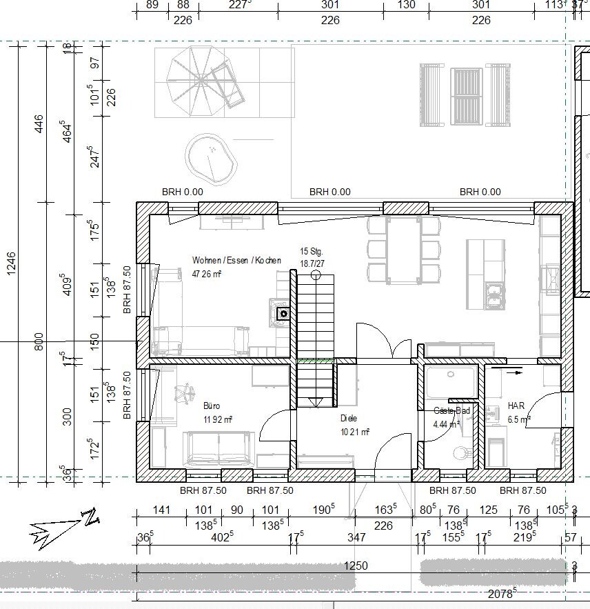

Bright hallway,
Large kitchen with island (including seating, e.g., stools) and preferably a small pantry (possibly accessible via a "fake" kitchen cabinet), plus a small “bench” made from low cabinets by the window, double-leaf sliding door guided inside the wall to separate dining / living area,
Bright dining area,
Spacious living area, preferably with a panoramic fireplace as a room divider (not next to the TV),
Guest room / office,
Generous utility room with space for possibly two electrical panels, softener system, ground source heat pump, washing machine (possibly dryer), and drying rack,
Guest WC with shower.

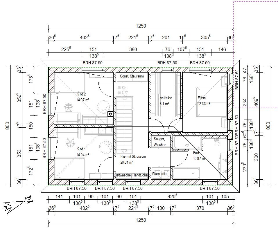

Upper Floor (UF): at least 2 children’s rooms, 1 storage room, bedroom can be fairly small. Instead, a spacious bathroom with 2 washbasins (or 1 long basin with 2 faucets), bathtub up to 2 m (6.5 ft), and shower. WC with privacy screen, e.g., with door T-shaped.
Walk-through dressing room between bedroom and bathroom. Sliding door on the wall between bedroom and dressing room and regular door between dressing room and bathroom. Bathroom should also be accessible from the hallway.

Hmm... quite a few wall corners. (Yes, we always have something to complain about.)
The utility room... is actually a hallway (path from the garage into the house) where nothing can be placed.
The false door to the pantry next to the side-by-side refrigerator will be quite a custom construction and will reasonably have a wider width (65–70 cm (25.5–27.5 inches))—not just a standard 60 cm (24 inches) kitchen cabinet door. To support doors like that, you need quite substantial hardware. Therefore, I don’t think many spices will fit on the inside of the door.
Google “Blum Space Tower,” two of them, with about two-thirds of the height at the bottom as pull-out drawers, and above that two or three shelves for less frequently used kitchen appliances, and you won’t end up more expensive than with your mini pantry and false door.
Upstairs bedroom... bed really placed under a window? Cleaning?
9.1 m² (98 sq ft) of room for almost 5 meters (16.5 feet) of wardrobe?
Patkia16 Sep 2018 21:03
@kbt09
Thank you for your constructive input.
Yes, the idea is to have a false door. Thanks for pointing out that it might actually be difficult to implement. We might still swap the fridge with the oven cabinet, but it’s more likely that we will just leave out the false cabinet and install a small, simple door with hinges there instead. That’s how we saw it recently and we liked that solution.
What do you mean by the corners? Are you referring to the edge in the bedroom, those upstairs by the beds, and the corner in the guest room? We could also make the upstairs hallway with a continuous wall, but then there would only be about 1 meter (3 feet) of passage in total. That might be a bit too narrow?
We also have windows above the bed now, just like at the bathtub. We have no problem with that and actually find it quite nice. Honestly, we haven’t really discussed the windows yet. I just placed them roughly for now.
We would probably give the bedroom a straight wall on the left side after all. This would make the walk-in closet a bit smaller. But it’s supposed to hold not only one wardrobe but also clothes rails.
Regarding the utility room, we had planned the recess for the heating equipment and the long walls for the electrical installations. We assumed that would work. Do you think nothing would fit there?

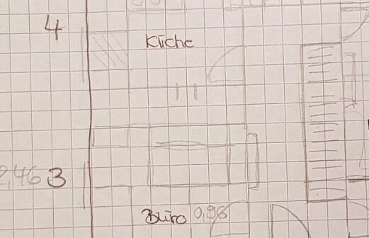

Funny that the pantry isn’t accessible on the drawing. In fact, there isn’t one shown at all.
Hmm, I do see a small room between the kitchen and the office... even with a door... funny, indeed

I have to say, it’s also difficult. On one hand, you suggest marking out on graph paper, which makes sense because you can roughly see the dimensions. On the other hand, if you draw on graph paper and then write the measurements next to it, it’s still not quite right.
Suggestion for compromise: simply draw all walls (whether exterior or interior) half a square thick, and in total it will work out again.
Patkia schrieb:
The exterior and interior walls are all 5mm (0.2 inches) thicker than the masonry will be. This should somewhat account for plaster and similar finishes.
In the digital drawings, 20cm (8 inches) for interior walls and 40cm (16 inches) for exterior walls are practical rounded dimensions "at the sketch level."

What just occurred to me is that your last version was 10.5 x 10.5 m (34.4 x 34.4 ft)… shouldn’t the maximum ground floor area be limited to 100 sqm (1,076 sq ft)?
I planned 8 x 12.5 m (26.2 x 41 ft) and forgot the 75 cm (30 inches) to the right of the garage.
I can actually imagine more of a southwest to west-facing terrace by the kitchen. So now about 8 m (26 ft) distance to the neighbor’s property there.
On the south side, it’s still over 12 m (39 ft).
Utility room on the ground floor now with an outside access, but I’d remove that. This way the room can be used both for building service connections and as pantry storage. There should also be space for a central vacuum system and mop.
Upstairs there is no real separate laundry room, but a niche for the washer/dryer opposite a niche for vacuum, mop, and ironing board. Also space for general storage like bed linens, towels, suitcases, and whatever else you might need.
Walk-in wardrobe in the master bedroom definitely 3 m (10 ft) for a 60 cm (24 inch) deep closet and 3 m (10 ft) for a 40 cm (16 inch) deep closet.
