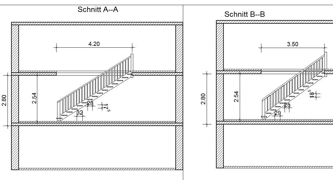

@Patkia .. regarding storage space under the stairs ... everything is understood correctly, but your planned access door does not fit.
Take a look at the rise of a staircase:
From the highest point, you want to place a kitchen cabinet about 100 cm (40 inches) wide first, and then have access to the space under the stairs. However, there is no longer a height of 2 m (6 ft 7 in), but only about 140 to 190 cm (55 to 75 inches) of height in the doorway width under the stairs.
