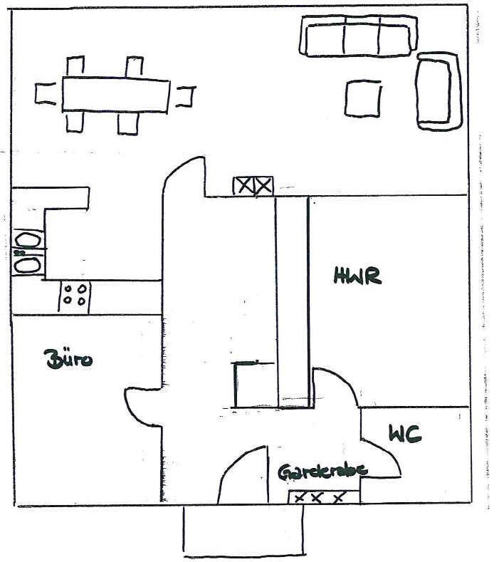

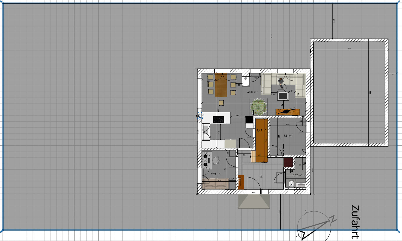

Patkia schrieb:
But with the 3-meter (10 feet) upward extension, we only have 9 meters (30 feet) as the boundary constructionBut then just skip the 0.75 and make it a proper boundary construction.
Where do you plan to place the entrance? By the garage or facing the street?
No, the 0.75 meters (30 inches) are important to us. It may sound odd, but we simply want to be able to walk all the way around our house. Additionally, we don’t want to have to go onto the neighbor’s property every time some work or similar needs to be done on the wall.
I also don’t want my garage to end up being used as a soccer goal by the neighbor’s kids.
Among other things, the entrance is also a constant topic. We would like to have the entrance facing the street, not the garage.
Just to clarify:
If I want a laundry room upstairs without having a boxed-in area downstairs, both the bathroom and the laundry room need to be next to each other and located above the utility room on the ground floor because of the water connections, right?
I have been working on the floor plans from @kaho674 all this time, trying to adapt them for us. By now, we quite like them (yes, rotated), but there are still a few adjustments needed.

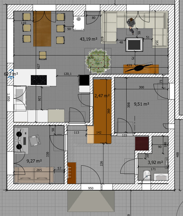

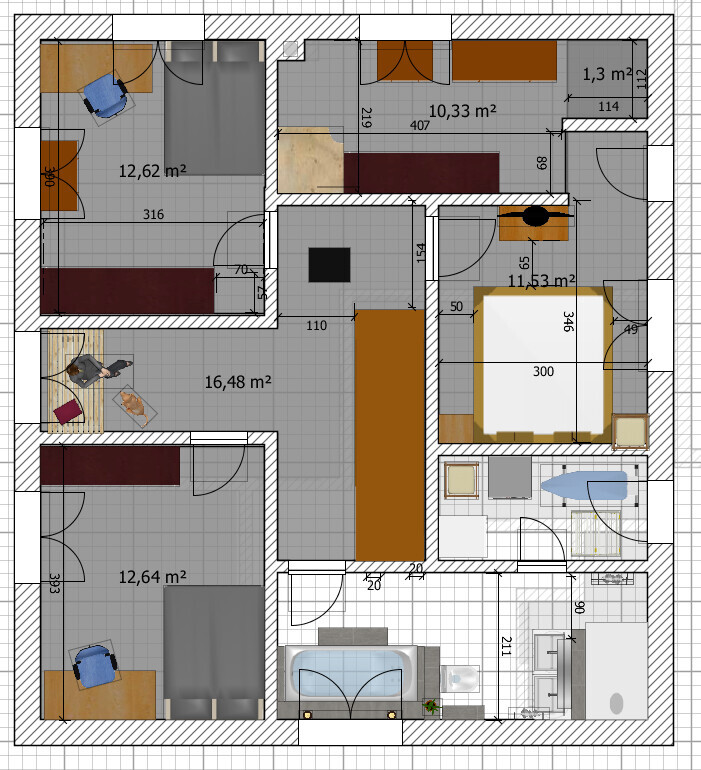

Patkia schrieb:
By now, we quite like the (yes, rotated) version. Just that it would still need a few adjustments To be honest, I find the rotated version quite poor, since it wasn’t designed for that. If I were you, I would rather try the version with the combined living area arranged in a row.

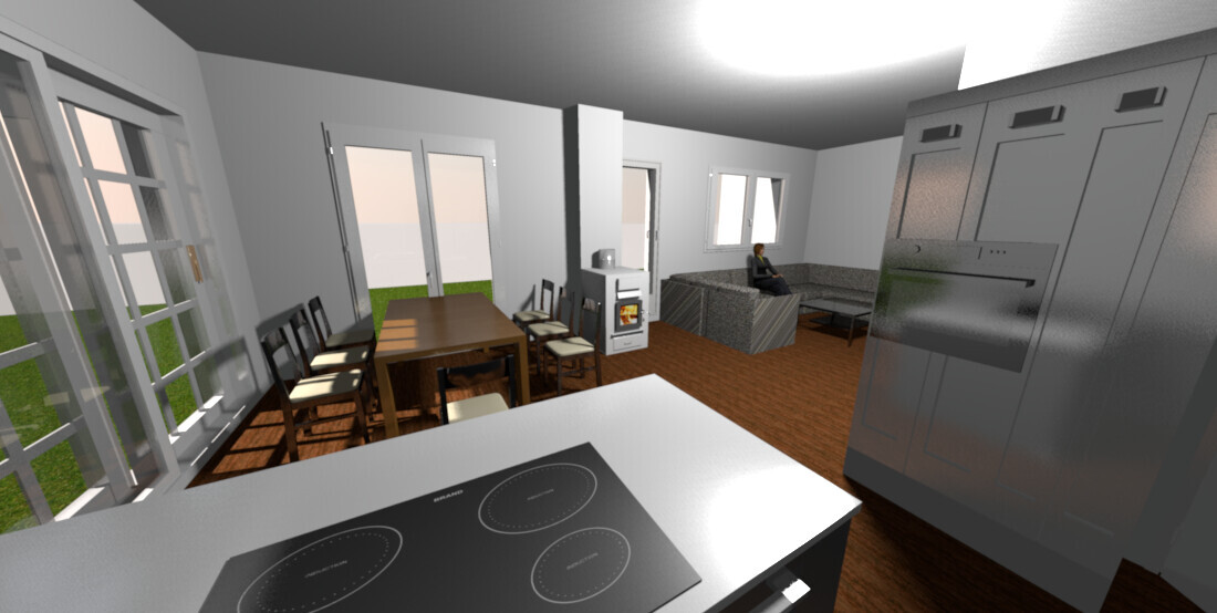

So, I spent a few more hours working on it, trying to make the best out of it and meet as many wishes as possible.
I’m not completely satisfied yet, mainly due to the tight space on the right side of the upper floor. But in principle, everything should fit. I intentionally took the furniture dimensions larger than usual so I wouldn’t have to say next time, “oh no, it doesn’t fit, built too small.”
For example, the sofa is 3.80 m (12 ft 6 in) wide, and the dining table measures 2 m by 1 m (6 ft 7 in by 3 ft 3 in). These are already XL sizes, even though our actual furniture is much smaller.
Additionally, there is the question of whether the staircase is realistic. I followed @kaho674’s design and dimensions.

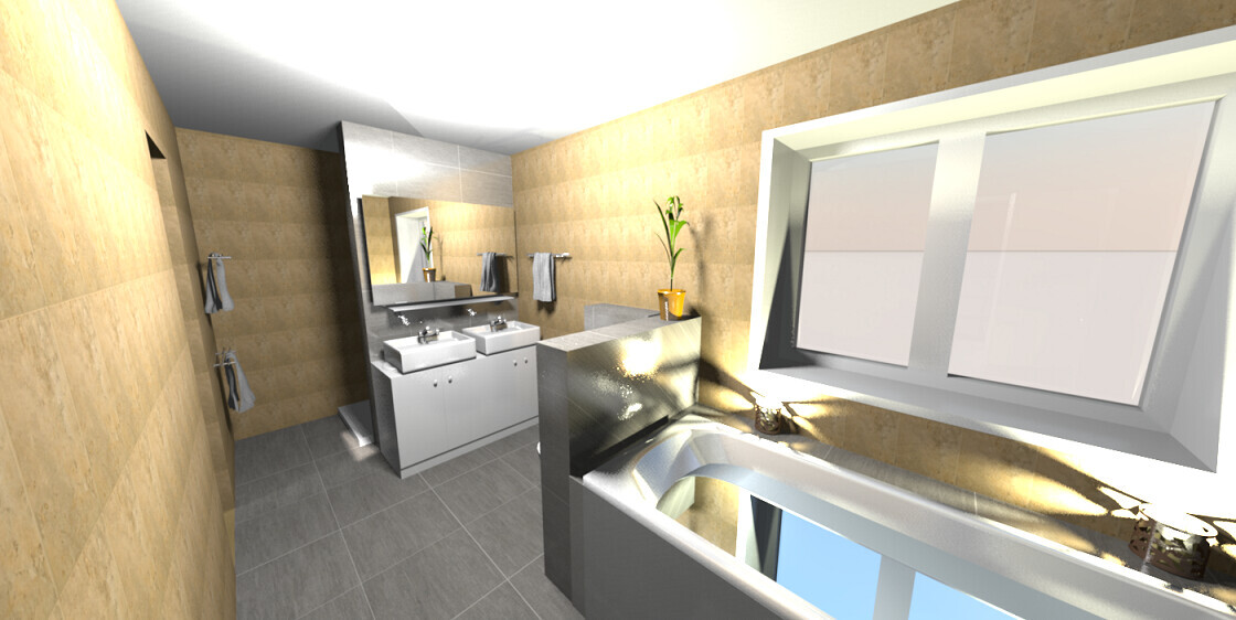

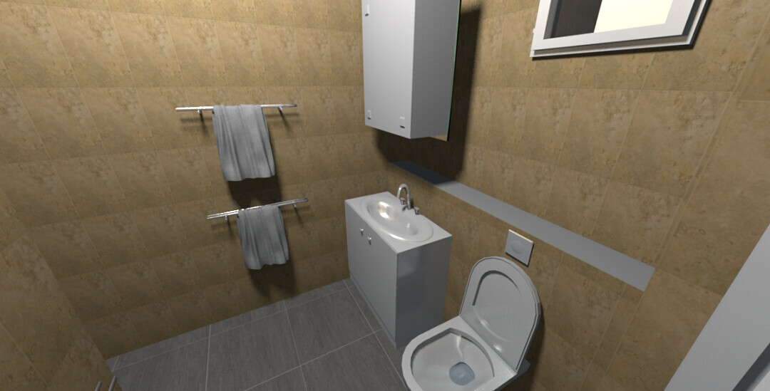

What I still don’t know is how practical the bathroom is. I positioned both the laundry room and the bathroom towards the ground floor utility area, but I’m not sure if you would see a suitcase from downstairs, for example, if the bathtub is placed where it currently is.
You probably know more about that, right?
Most of the windows were just roughly placed for now, so there is no detailed planning behind them yet.
I rendered 2-3 images to get an initial impression of how it might look.
By the way, we have ruled out arranging all the rooms in a row. Among other reasons, we want to set up the TV corner so that no direct sunlight shines on the TV from behind, which would make it impossible to see anything.
Edit: I forgot a bookshelf in the hallway on the upper floor, so don’t be surprised by the black box next to the staircase.
In the bedroom, I initially lowered the 114 cm (45 in) wall to the dressing room to have a continuous wall, but I found the bedroom felt more open with it as it is now, letting in more light.
