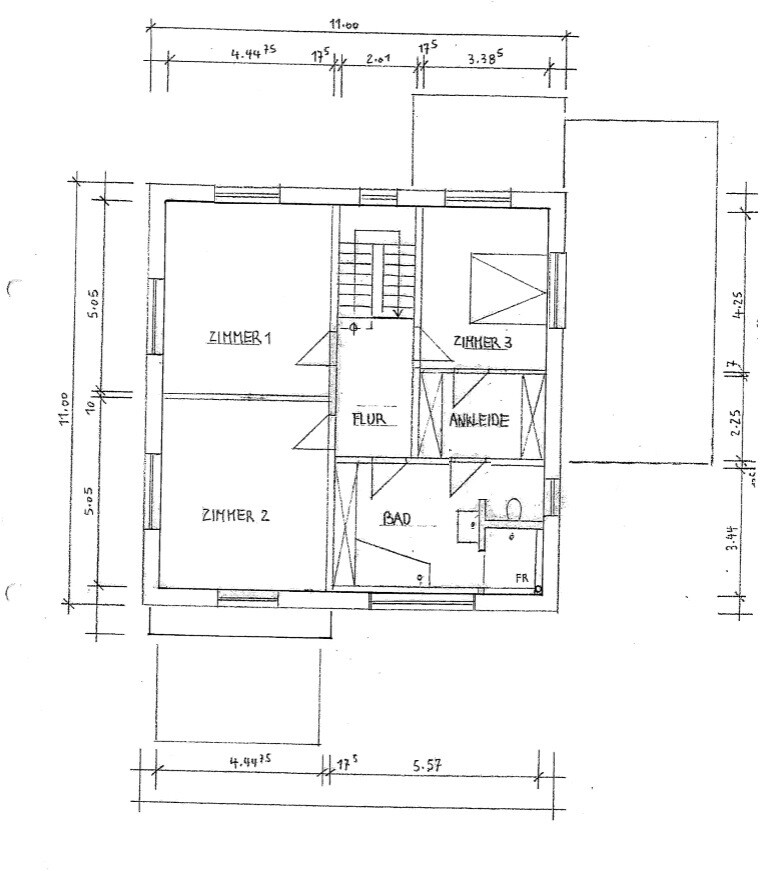

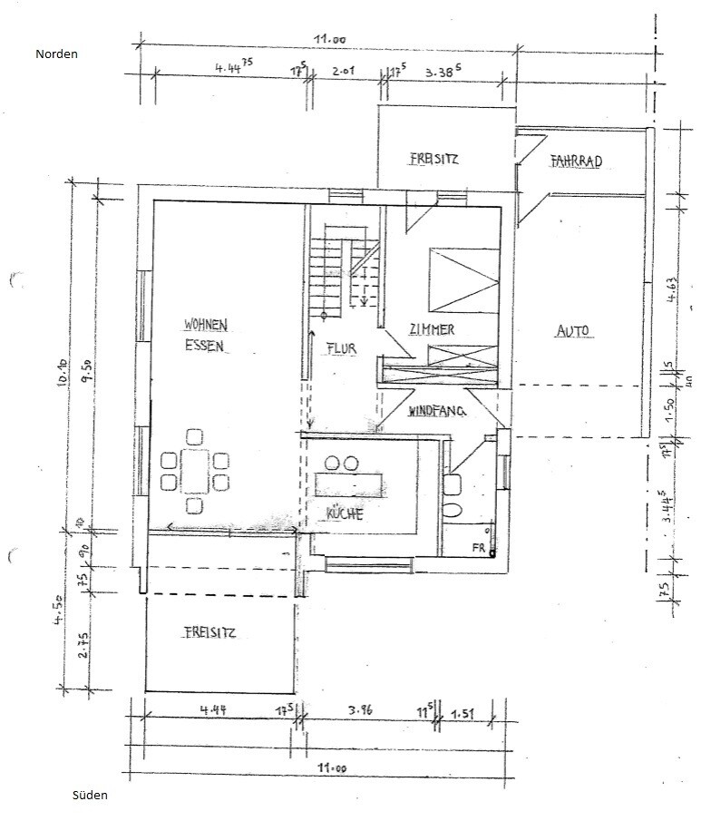

I would like to share our first floor plan and would appreciate your feedback.
Plot size: 495m2 (5329 sq ft)
Slope: no
Roof type: hipped roof
Owners’ Requirements
Basement, floors: 2 + basement
Number of occupants, ages 2, 31 + 28, planning for 1-2 children
Space needed on ground floor, upper floor: approx. 90m2 (970 sq ft) per floor
Office: family use
Guests per year: 3-5 overnight guests per year
Open or closed layout: open living, kitchen, dining area
modern construction style
Fireplace: yes
Carport
additional wishes/special features/daily routine, also reasons why something is wanted or not
What do you like most? Why? The room layout and the size of the rooms.
What do you dislike? Why? The kitchen could be a bit wider. The staircase might not be wide enough.

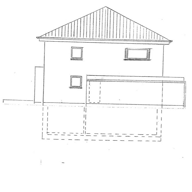

Who said it's messed up? These exterior views are not great, but there is no requirement for a house or its windows to be symmetrical, so that is _not a criterion_! Yes!It was never about something having to be a certain way. A staircase isn't too narrow and doesn't need to be widened.
This was about suggestions for improvement, and my point was that the exterior views should be looked at more closely. What comes of it is up to the homeowner to decide. Nothing more, nothing less.

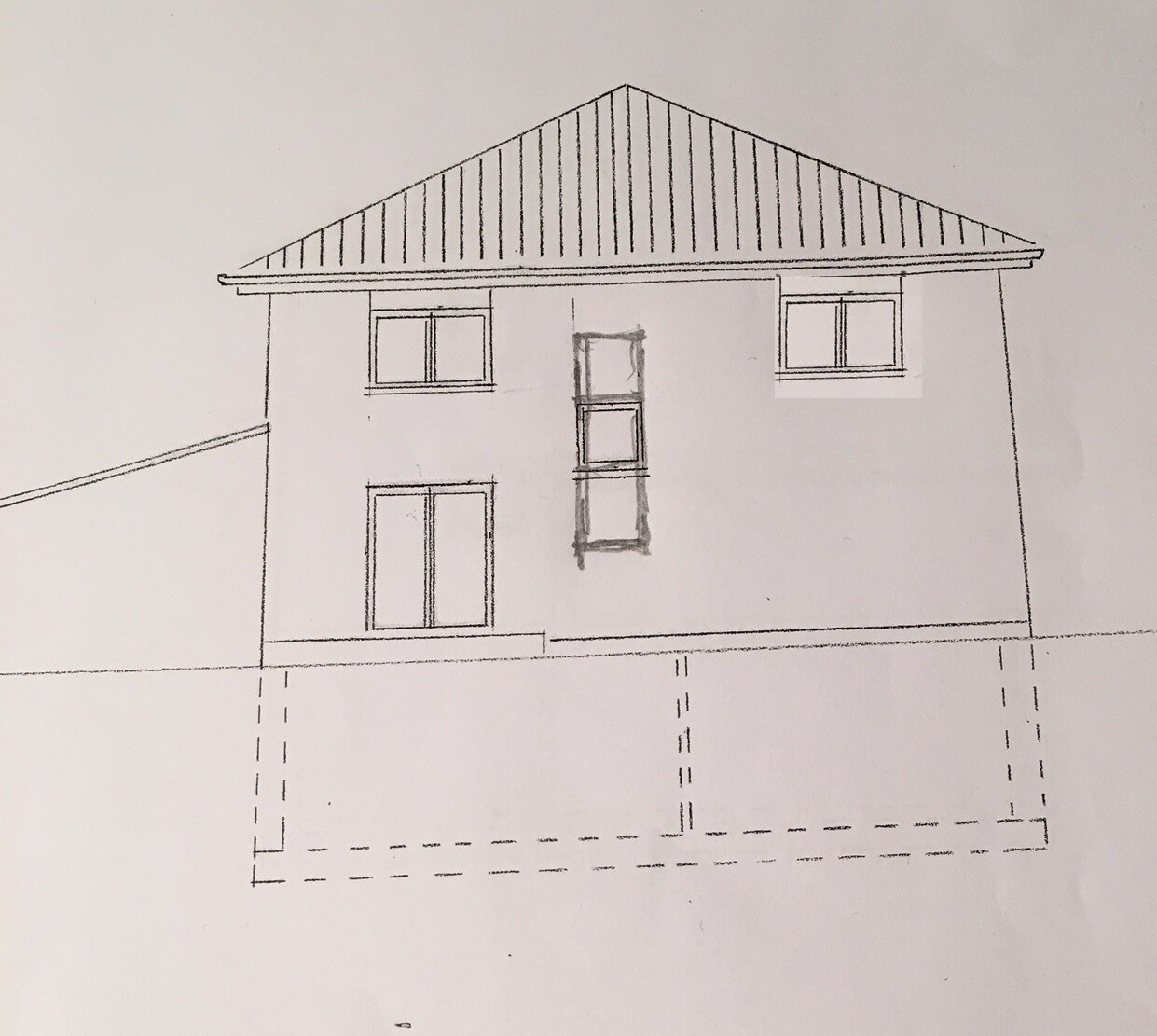

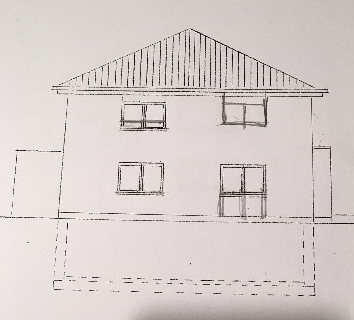

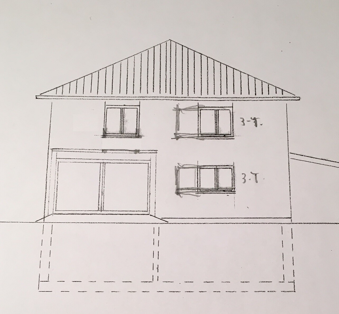

I’ve spent some time considering our window issue.
What are your thoughts?
There are no exact measurements yet, and the windows are only roughly sketched in.
Furthermore, I’ve reconsidered the bedroom and walk-in closet layout. I think we’ll keep it as is, since otherwise the bedroom would become smaller, which we want to avoid. Instead, I thought it might make sense to simply close off an additional passage to the bathroom.
