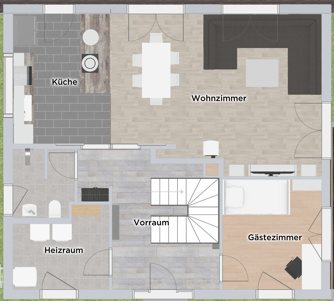

Hello everyone, now it’s our turn. We’ve read a lot and heard much about circulation paths and related topics. Now we would like to know what the experienced but also critical community thinks about our floor plan. So please type away and give us feedback on the layout. Thank you very much.

What do you think of the floor plan? How do you find the number and arrangement of windows? What is good and what could be improved? How could the fireplace flue (by the way room-air-independent) be solved? And anything else we might have missed

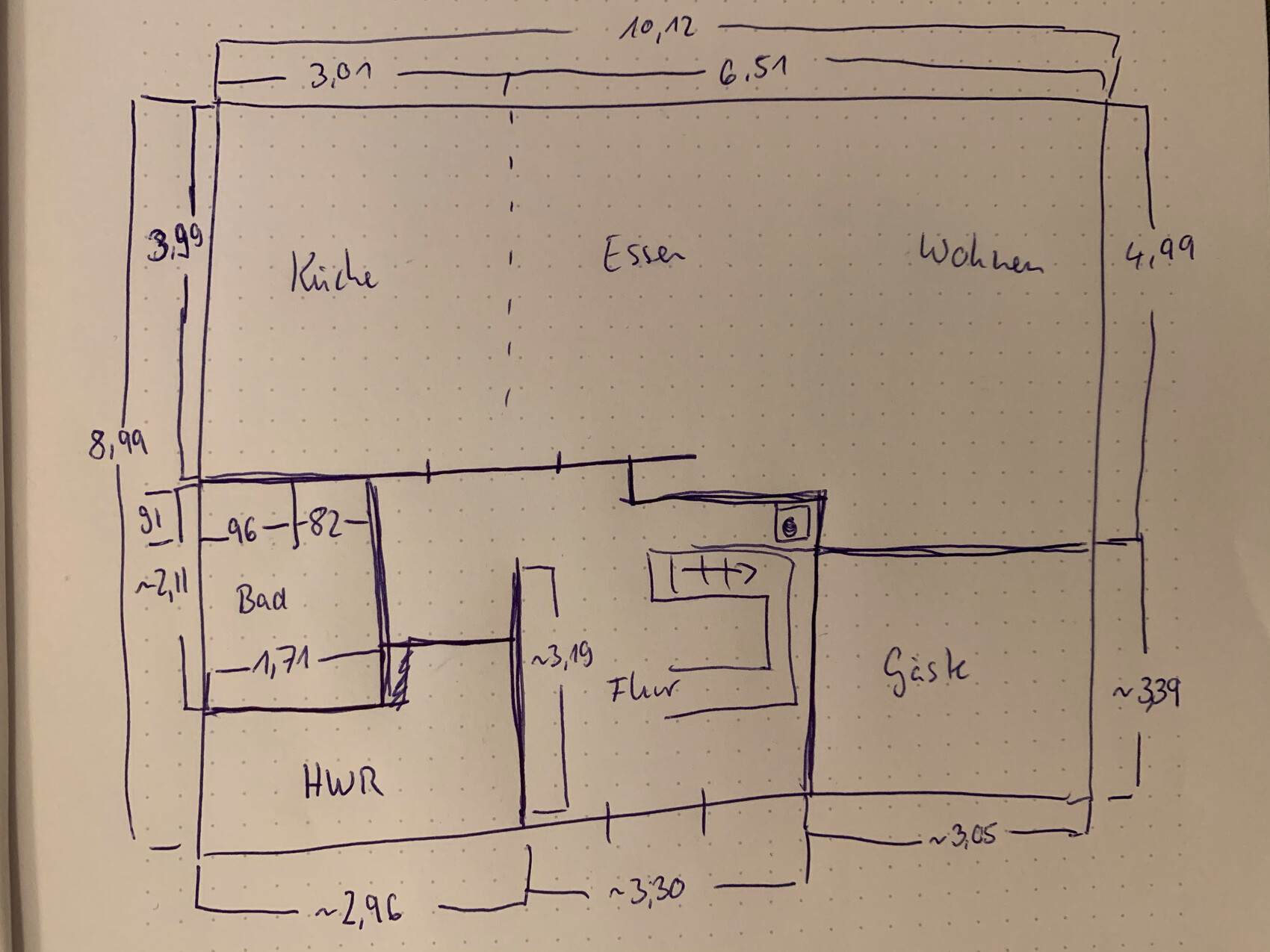

House dimensions 10.12m x 8.99m (33.2 ft x 29.5 ft)

Friends advised us not to make the utility room/laundry room too small. So it should be a bit larger. I was really expecting at least 12m² (130 sq ft). But then...
Well, we’ll wait for the exact measurements.
Draw your existing or desired furniture to scale once.
The dining area might be a bit tight.
I don’t like the entrance area including the stairs and the nasty gap between the wall and the stairs.
The utility room including laundry and storage is very small. I expected it to be larger.
Is there no bathtub in the bathroom?

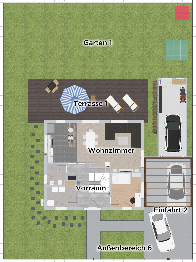

Where is south?
I must have missed it.

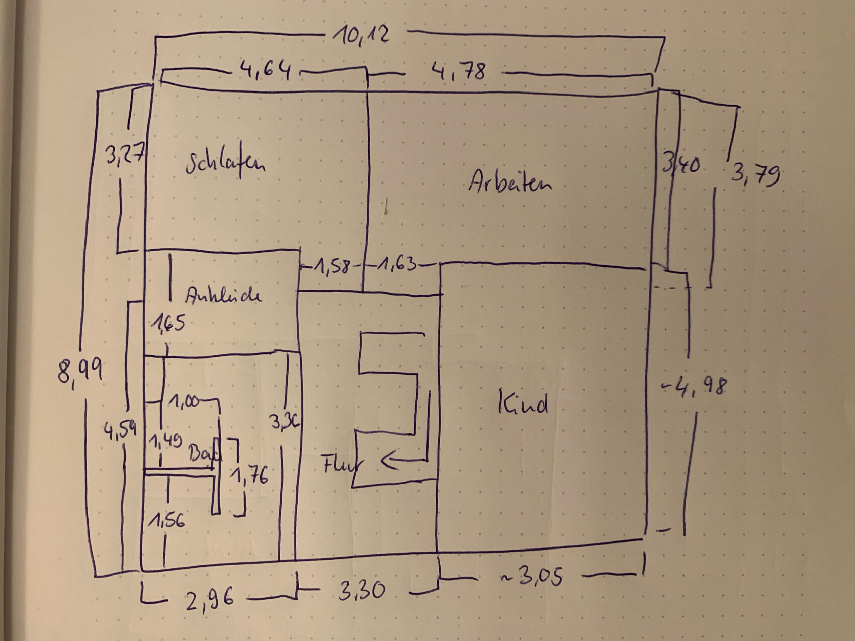

I also don’t like the stairs on the upper floor.
Where is south?
