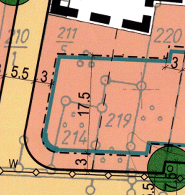

We are currently in the initial planning phase to build an urban villa with a double garage on the following plot (we will receive 500 sqm (approximately 5,382 sq ft) from the two parcels).
We plan to build the double garage ourselves, and starting next week, we will have first discussions with prefabricated house companies (Streif Haus, Hanse Haus, and Schwabenhaus) as well as solid construction companies (Elbe-Haus, etc.) regarding the villa. At this point, we are very open and looking at where we can contribute our own work. For example, my brother-in-law is a certified electrician.
So far, we have created the following drawing as a first draft. The terrace is naturally planned to receive sun during the day and in the evening. However, this means sitting almost directly next to both roads, which would only be avoidable with privacy screens and hedges. We are, of course, open to other ideas. How would you arrange the house and garage (yes, a double garage, since we do not have a basement and need the space)?

we are currently in the initial planning stages for the following plot of land From where will the plot be connected to the utilities?

Indeed, access via Birkenweg is difficult, so the Leeg is a more practical option. It should be noted that there are no parking spaces in either street, and parking on the street is not allowed. With two cars plus children, you already need at least three parking spaces without any visitors. That’s why a large driveway was planned. According to the development plan, at least three parking spaces must be provided. This is becoming quite tight on the 500sqm (5400 sq ft) plot, especially since the garage must have a minimum distance of 2.50m (8 feet) from both streets.

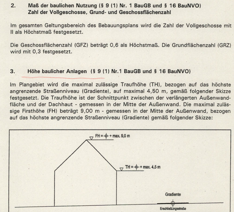

We are generally not tied to the idea of an urban villa. The development plan specifies a gutter height of 4.50m (15 feet) and a ridge height of 9.0m (30 feet), which would mean quite a steep pitch for a gable roof, wouldn’t it?

From where will the plot be connected to the utility services? From In der Leeg; all utility lines are located directly in the street there.

hanghaus202330 Jan 2026 11:15Eaves height of 4.5m (15 feet) and a city villa is not possible. Consider a gable roof and a rectangular floor plan.

e.g. plan for 11.5 x 8 That's already a good idea. Where will the construction take place?
