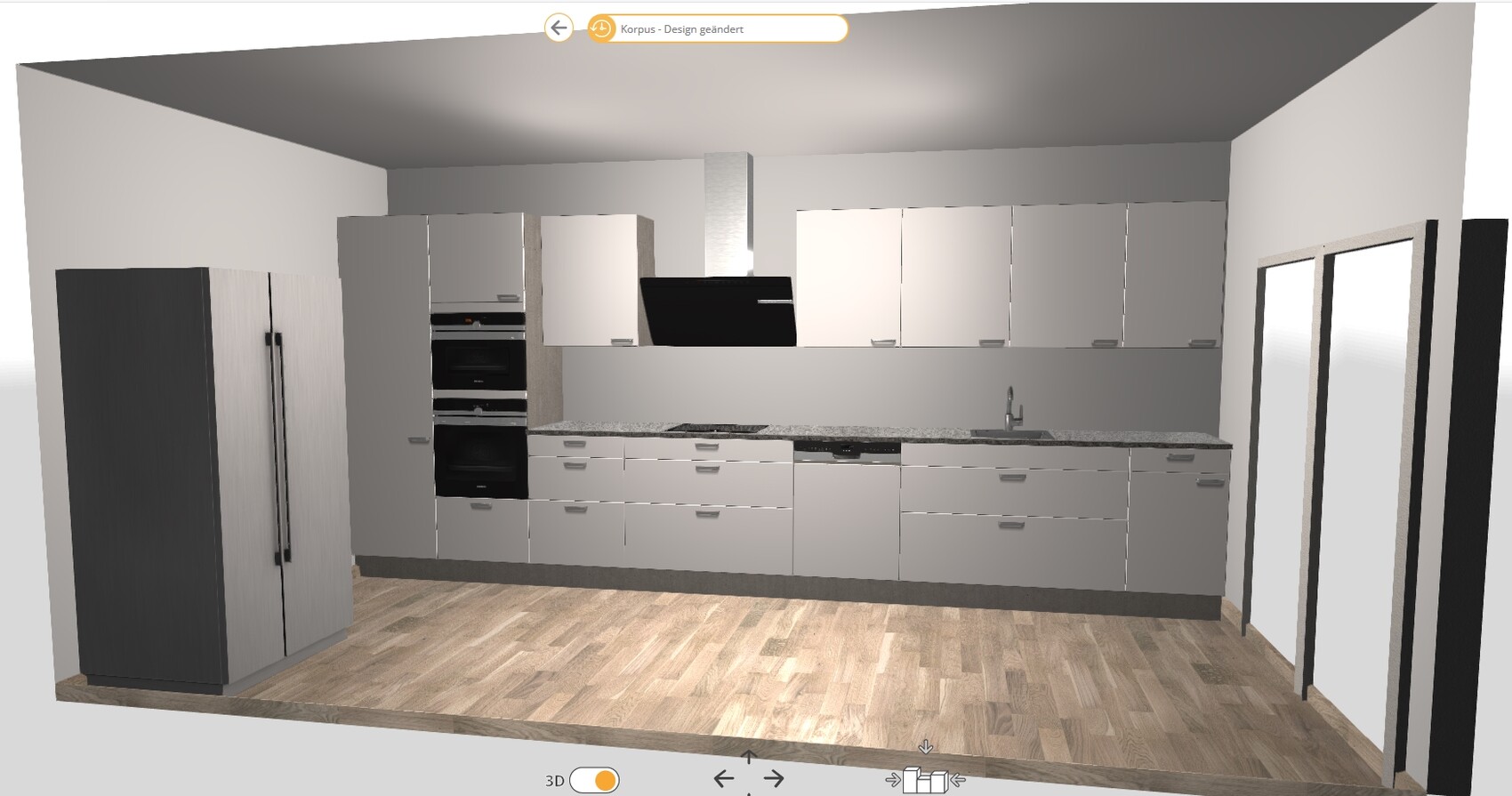

We haven’t drawn the kitchen like that; that was the architect’s “draft” and we don’t like it either.

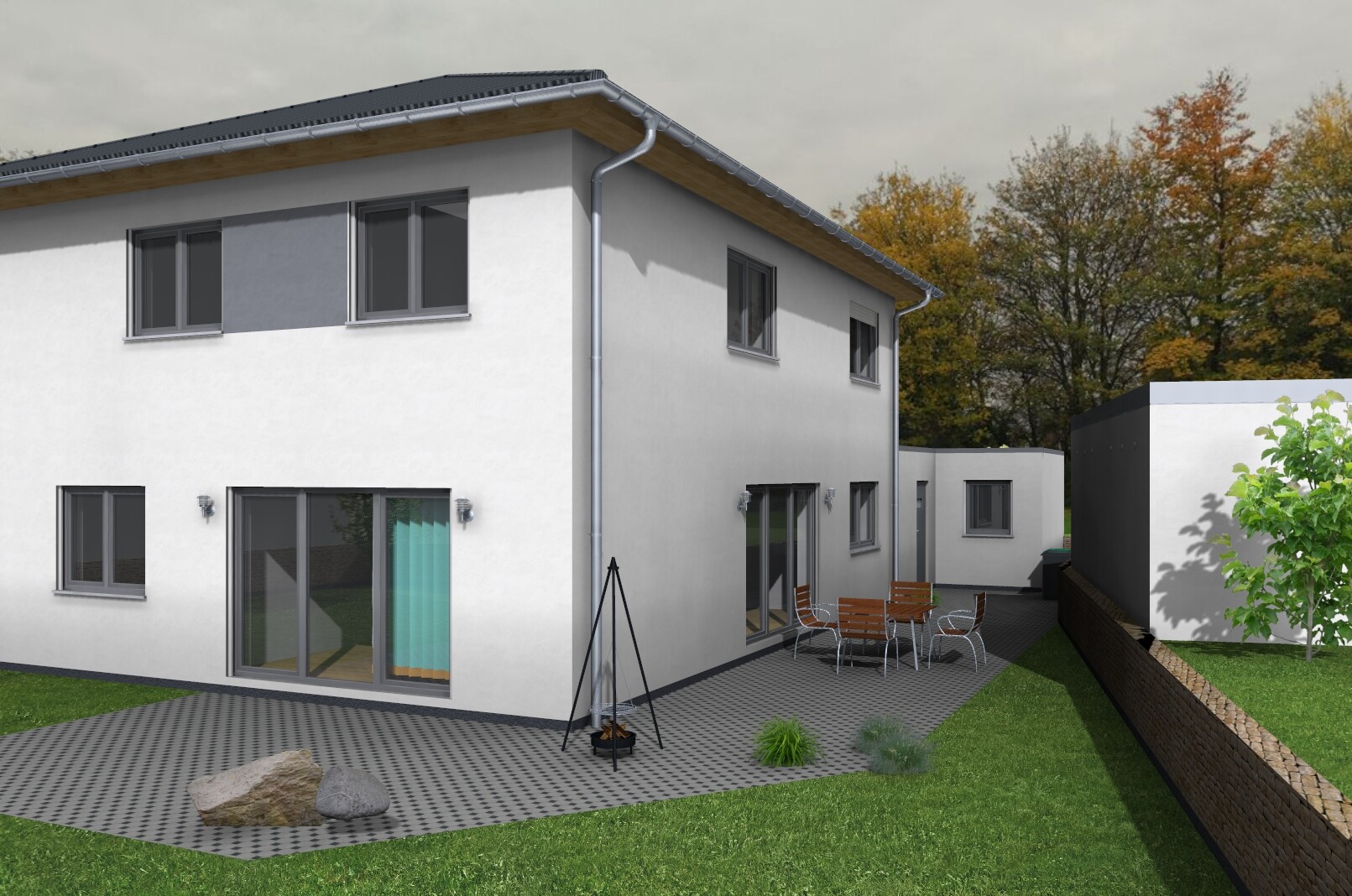

Are you aware that the wall next to the neighbor, shown in the picture as about 60-70cm (24-28 inches) high, is actually 1.50 - 1.80m (59-71 inches) tall? This perspective is quite optimistic...
If the neighbor’s garden on the left side is not attractive, just create a planting strip there and add a nice hedge.
