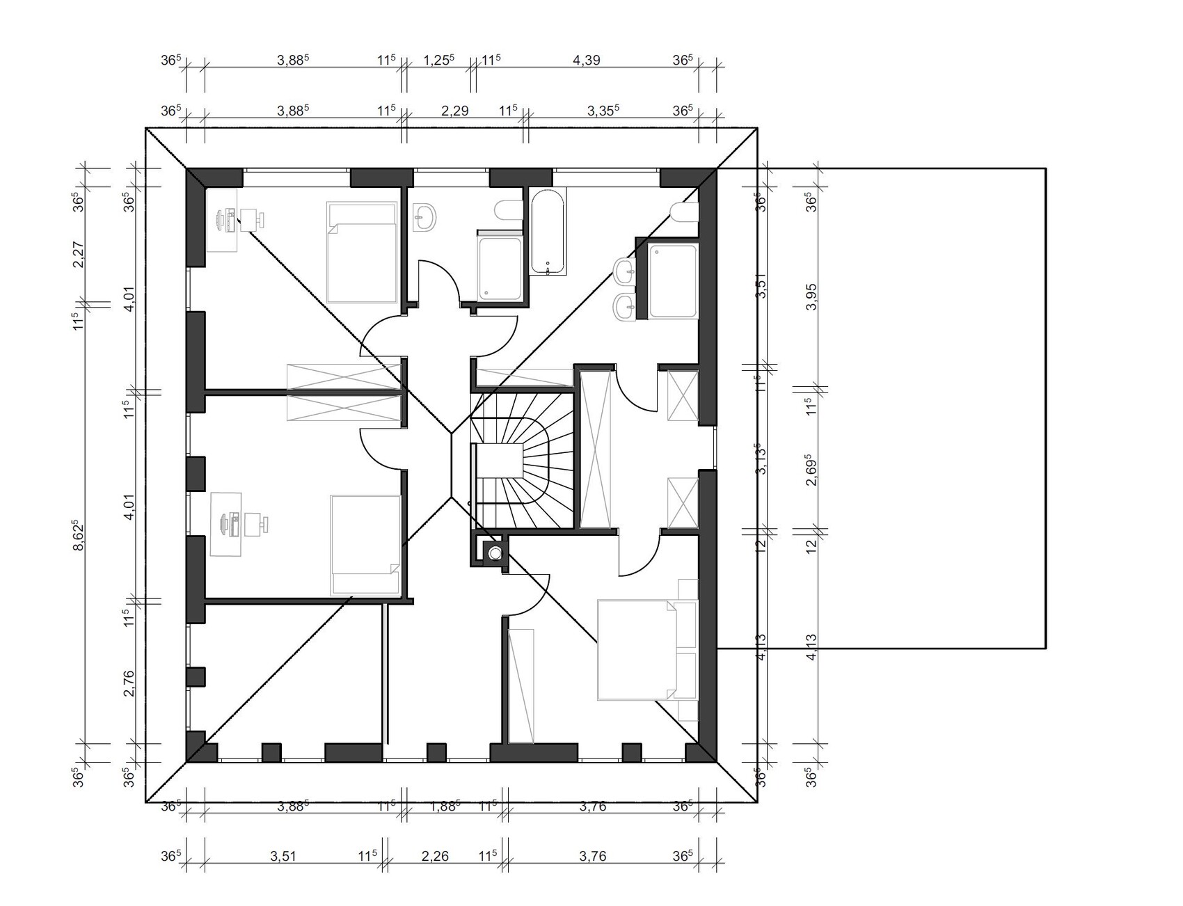

Ground floor: Kitchen, dining, living + office/bathroom + utility/technical room
Upper floor: Master bedroom, 2 children’s rooms, 2 bathrooms, children’s bathroom next to utility room upstairs – against dryer use, laundry will be air-dried, so washing on upper floor is questionable and carefully considered.
Mandatory: Both adults to be able to work 100% from home

- Do-it-yourself: my wife and I, using ArchiCAD software provided by an acquaintance
5.4–6 m (18–20 ft) windows are mandatory. / Ability to separate office + children’s room from living areas.
Use of the full 17 m (56 ft) width
Children’s rooms about 16 sqm (172 sq ft) each + open void and usable circulation space next to them.

What is the most important / fundamental question about the floor plan summarized in 130 characters?
- The upper bathroom(s)? Help with layout including windows
Priority 1!!

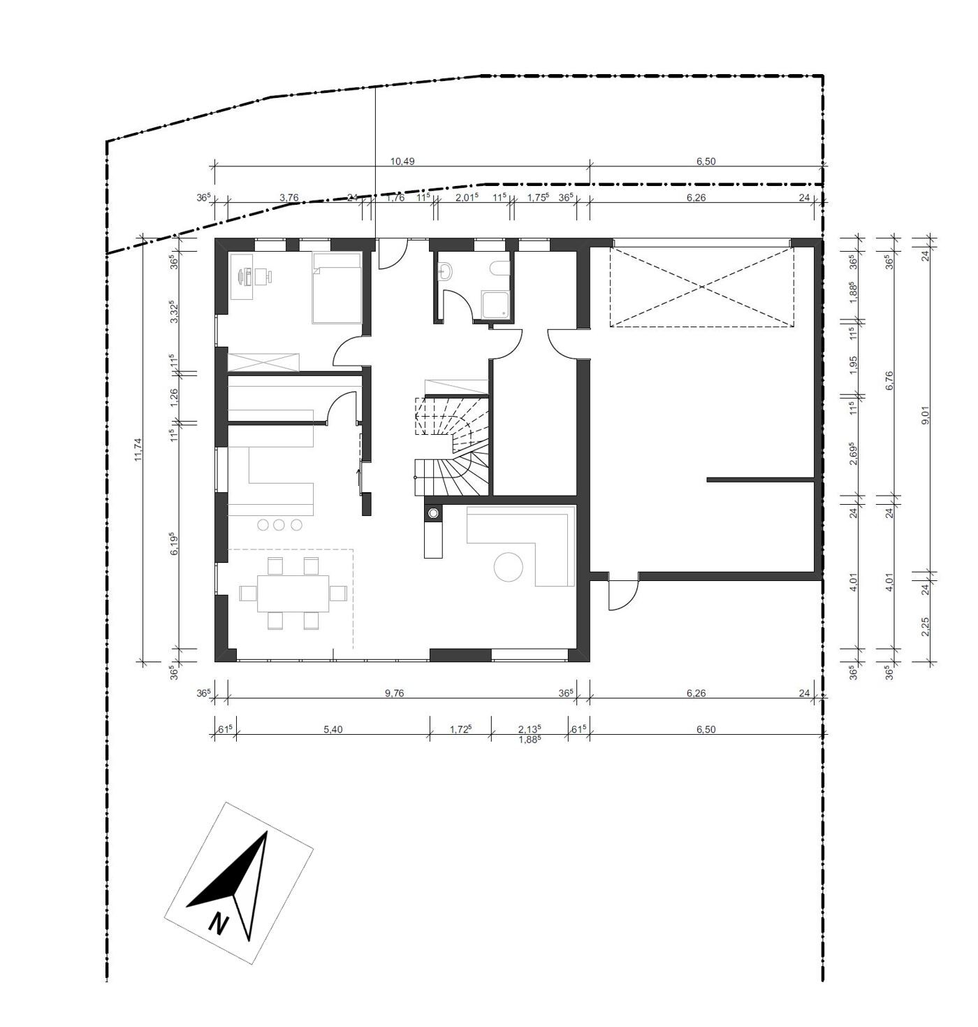

Christobal schrieb:
Are you against using dryers and the laundry is always hung to dry, so doing laundry on the upper floor is pointless and questionable? Do you mean;
We are against dryers and therefore dry laundry outside, so it makes more sense to have the washing machine on the ground floor? Please use full sentences for such complex topics.
Otherwise:

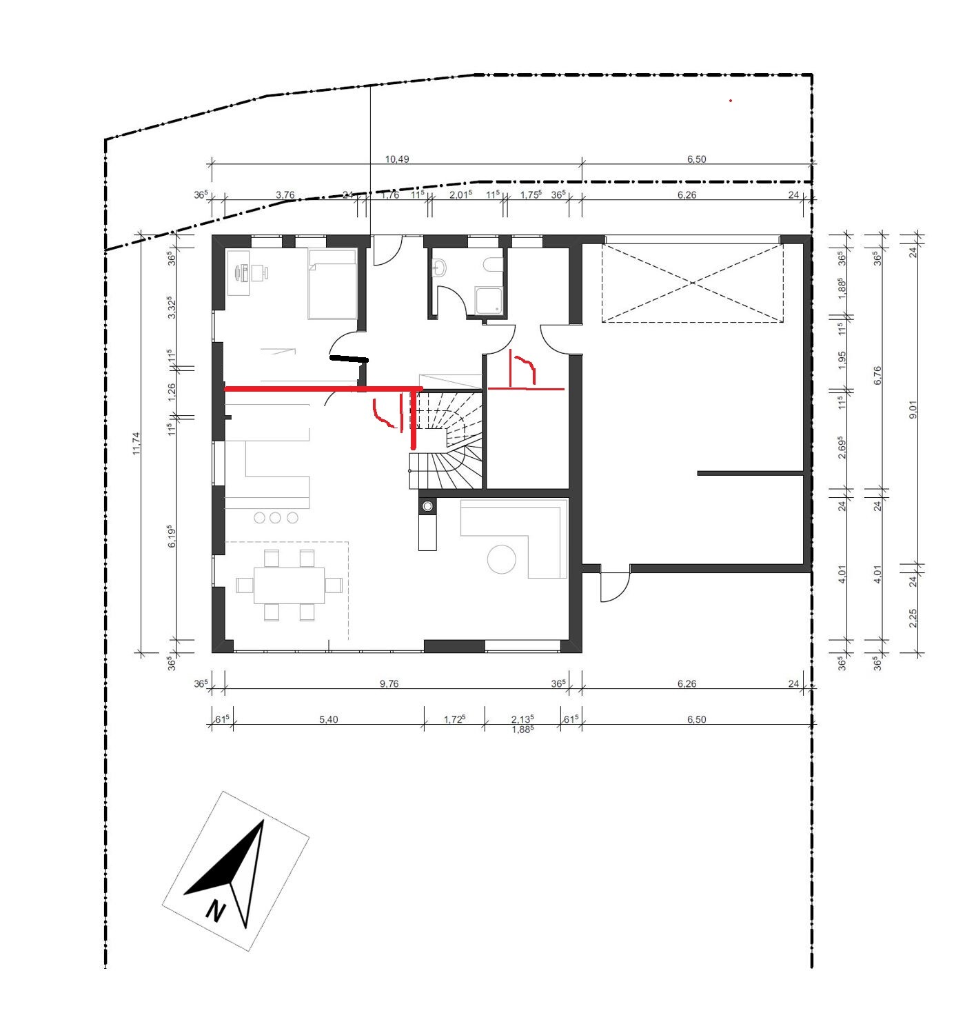

A width of 1.75 meters (5 feet 9 inches) is already very narrow, even for a utility room... and 1.2 meters (3 feet 11 inches) for the pantry is simply a waste of space without benefit. Personally, I don’t like the hallway on both the ground and upper floors at all. In my opinion, the kitchen does not have enough tall cabinets or countertop space.
The kitchen has a lot of circulation area... the 6.10 meters (20 feet) indicate that less usable space is actually available.
Somehow this looks like an unprofessional, makeshift design.
Give the transition between the house and garage facade a shadow edge. Also, take a bit of harshness out of the facades. The spatial effect in the master bathroom suffers from the awkward layout.
I don’t quite understand the priorities (just content-wise). What do you mean by "dark technical area"? Are you referring to the colorful boiler as opposed to the "white goods"?
Not even my psychiatrist has heard of a straight stair phobia yet.
Once again, I’m at a loss for words :-(

- The upper bathroom / bathrooms? Help with the layout including window positioning, priority 1!!
- Structural load capacity above the 5-6m (16-20 ft) sliding window on the ground floor, priority 2

Christobal schrieb:
Can the hallway to the kitchen disappear? Is it even possible to move a wall right up to the stairs?
Christobal9 Aug 2020 00:35Hello everyone,
sorry.
First note: amateurish, because I’m an amateur. I didn’t expect anything else.
About the pantry:
My parents have one about 3m x 1m (10ft x 3ft), so I’m familiar with it, but the question mark is there intentionally.
Omitting it would also allow for tall cabinets facing the hallway.
Is a room width of 3.7m (12ft) acceptable for an L-shaped kitchen?
Regarding the utility/technical room:
It seems the 1.7m (5.5ft) space is only for gaining natural light. Otherwise, the guest bathroom could take the full width, and the utility room could be without daylight.
When I say “technical room in the dark,” I mean that this room currently has about 14sqm (150 sq ft), but depending on how space under the stairs can be used, it might be an option to place the technical equipment behind the stairs and possibly add a partition wall between the passage doors to the utility/technical room. That’s what I meant by “putting it in the dark.”
I’m not referring to the major appliances.

Upstairs, the bathroom layout is still rather undefined within a roughly square area. The hallway turns a corner to avoid a trapped bathroom layout. We don’t want to have to go through the bedroom again to get out.
As I said myself, these bathrooms are still annoying.

About the pantry:
I understand your concerns about corridors. Downstairs, it’s a closet workaround, although I personally doubt the purpose of the corridor leading to the staircase.
Thanks.

A quick sketch again to explain what I mean by separating the technical area and what it means:
"Extending the wall from the kitchen to in front of the stairs"
However, I don’t want to distract from my priority topics hallway/bathroom.
I also find the house facade too plain. The garage will be moved closer to the house. In addition, a canopy will be added, extending from the garage to the front door. You can see this in many current new housing developments. We have only been working on this for days/weeks, not months.
Thanks for any advice.
