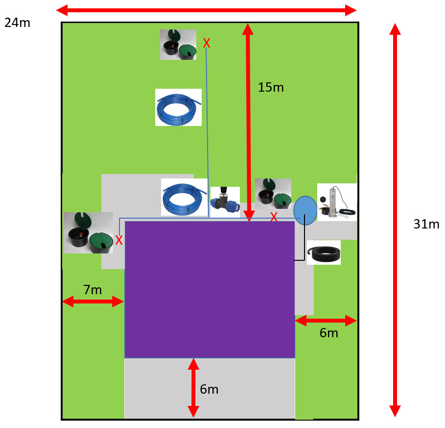

Greetings!
I am gradually starting to plan the garden irrigation for my soon-to-be-completed house. For now, I want to keep it simple and non-smart: a cistern (6,000 liters) is installed underground, and I plan to water the garden conventionally using a pump and garden hose. The farthest lawn area will be reachable with about 35 to 40 meters (115 to 130 feet) of hose length. The cistern is located at the lowest point, about 2.50 meters (8 feet) underground.
Now I am facing a confusing variety of possible pumps: suction pump, dirty water pump, submersible pump, garden pump, deep well pump... several thousand liters per hour, various pressure ratings in bar... Does anyone have good advice?

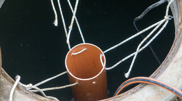

Stefan2.845 May 2021 08:28I’ve now installed a few components and understand the basics. The water pipes will simply be underground up to the desired locations. I can decide later whether to use underground boxes or pedestal-mounted outlets. I’m still a bit unsure about how to connect the pump. What does the weather protection housing look like, and how is it fixed inside the cistern?
Does the pump stand on the bottom of the cistern?

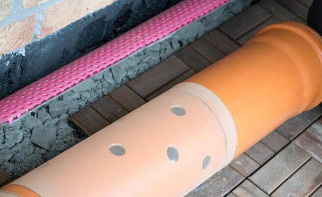

I also found something: someone created a kind of filter using a KG pipe and submerged the pump inside it to prevent debris from being sucked in. Is that a good idea?

Pull the HDPE pipe to the desired location. What you connect afterwards doesn’t really matter.
The pump should be positioned just above ground level. A filter is not strictly necessary.
Hang the pump either from chains or ropes.
A weatherproof enclosure could be, for example, FLT 300200130 TR wall enclosure IP65, 200 x 300 x 130 mm (8 x 12 x 5 inches), transparent.
Just check Google for more. Attach the enclosure either with strong mounting adhesive or, preferably, secure it to the cistern with anchors.
