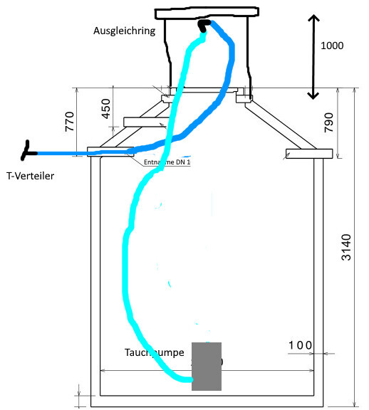

immermehr schrieb:
Thank you for your reply.
Originally, I wanted to implement it like my first plan (see attachment). However, in that case, I have to climb down with a ladder every time for maintenance or repairs. I would prefer to avoid that.
Thanks to your suggestion, I think the second plan is better. But with this solution, I need 3 fittings instead of 2 as mentioned in your text. With this setup, I will probably lose a lot of pressure.
Did I make any mistakes in my thinking here?
Maybe you have a better idea?
How did you eventually set it up in the cistern? And what are your experiences? Thanks

world-e schrieb:
How did you eventually do it with the cistern? And what are the experiences? Thanks
I bent both pipes "with force" and then used a 90° fitting. It was cold, and the pipes were hard to bend, but I managed it.

immermehr schrieb:
I bent both pipes "with force" and then used a 90° connector. It was cold, and the pipes were difficult to bend. But I managed it.
Which of the sketches did you end up using?
I
immermehr
9 Apr 2021 10:14
world-e schrieb:
Which of the sketches did you end up implementing?
None of them, but Plan 3 instead (see attachment)
Schematic diagram of a tank with a T-distributor, submersible pump at the bottom, and blue hose.
