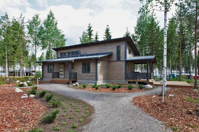

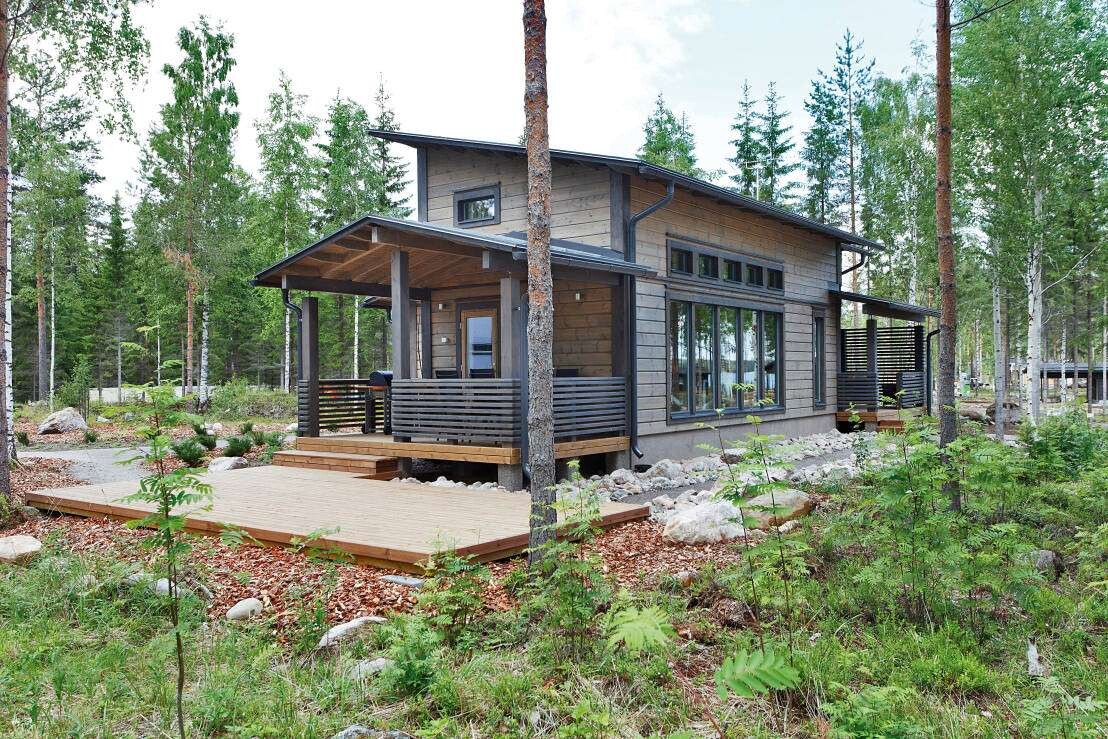

der_andyHello forum, I’m Andy and I plan to build a small weekend house in 2019. Since I will retire next year, I want to build it entirely by myself because I won’t be under any time pressure and I enjoy working on projects as a hobby.
For simplicity, it will be a small shed roof house. Completely rectangular, about 60–70 m² (650–750 sq ft) of living space, no upper floor, no basement... just a simple small house. Originally, I thought I would just pour a slab foundation, then build the four walls with bricks, put a ring beam on top, then the shed roof... and the shell would be done.
Lately, however, I’ve been wondering if I should rather build it with a timber frame construction. I spent several years in the USA and I’m not opposed to timber framing. My problem now is in the planning phase. I’m trying to compare the costs of both construction methods but haven’t made much progress. Can anyone tell me which building method is cheaper? Where can I find software to estimate construction costs? Best regards, Andy
