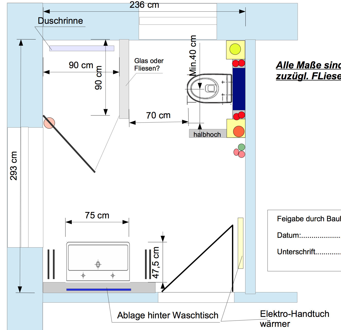

Lassemann4 Aug 2015 23:13
Hi Panama,
We also have enough space for a 1.20-meter (4 feet) basin, but we decided on a 75 cm (30 inches) basin so that there is still comfortable space on both sides for towel holders.
Mediano furniture washbasin. Available in many widths.
Floor plan of a bathroom with shower (shower channel), toilet, washbasin, glass partition, and heated towel rail.
