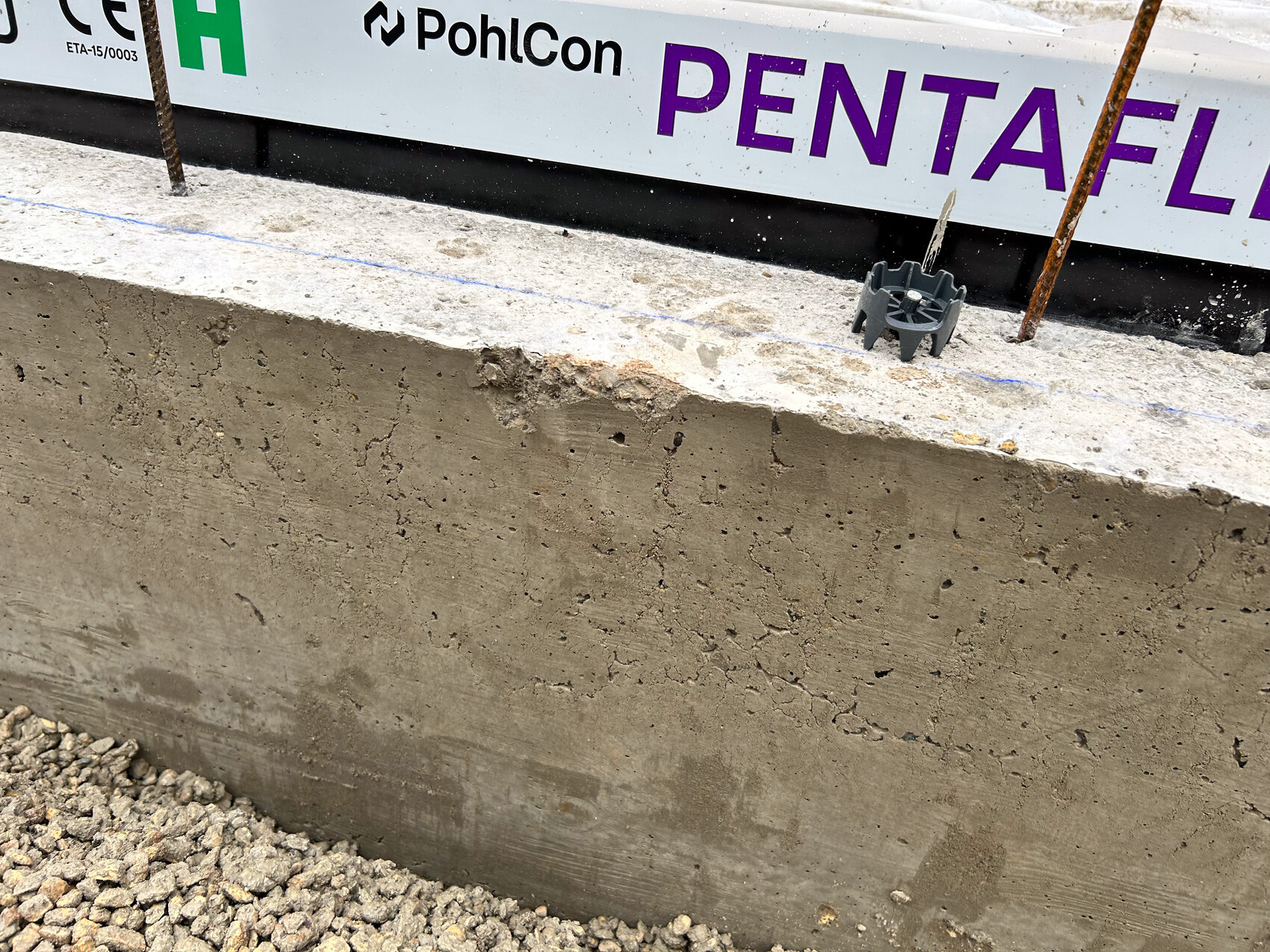

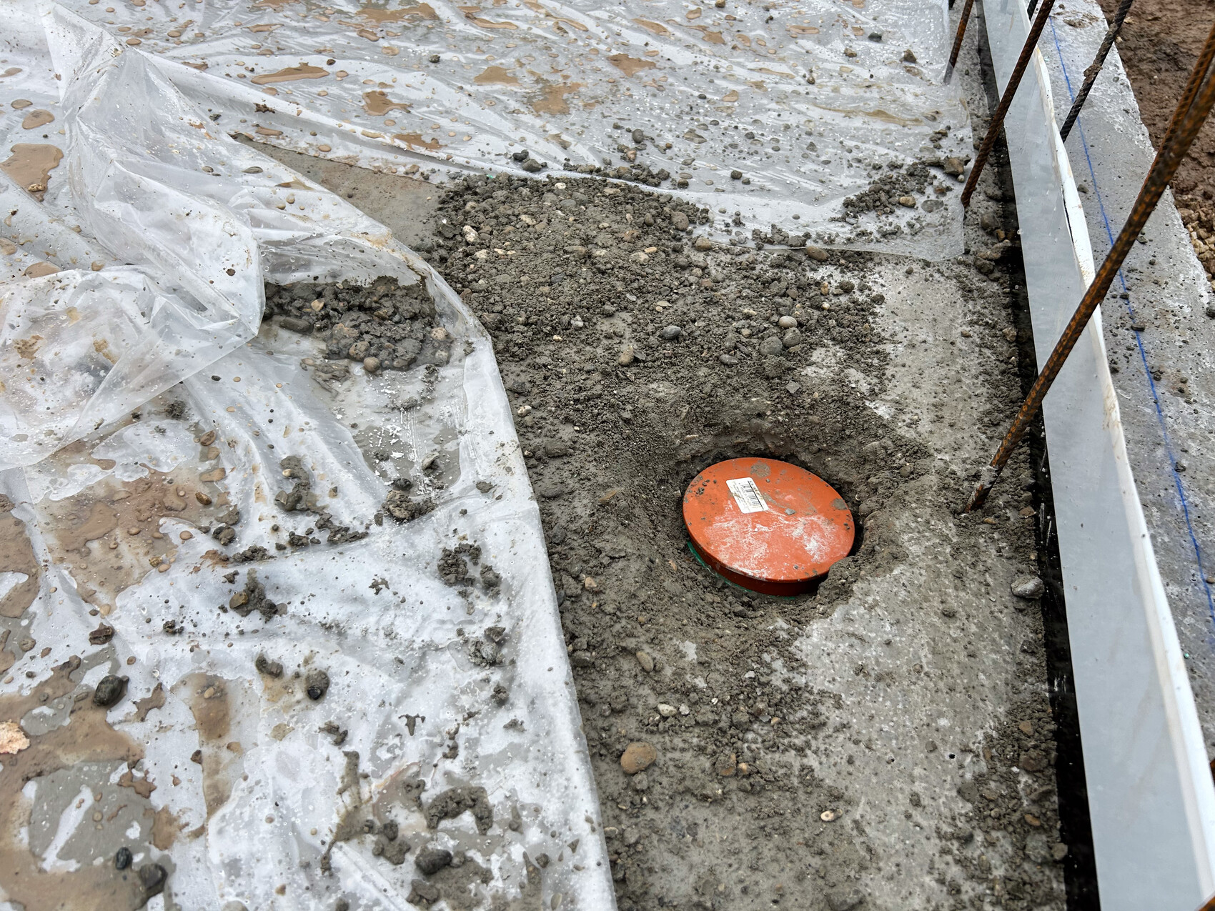

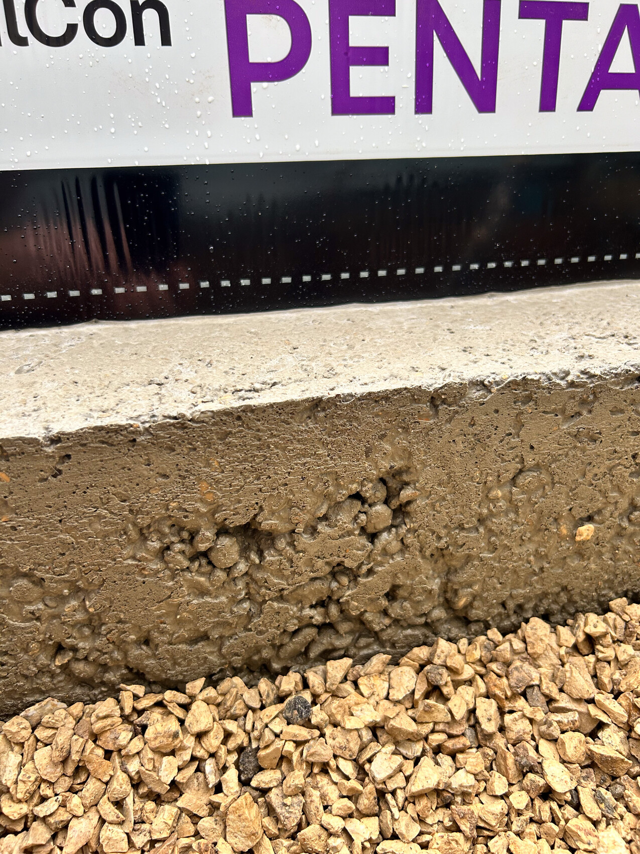

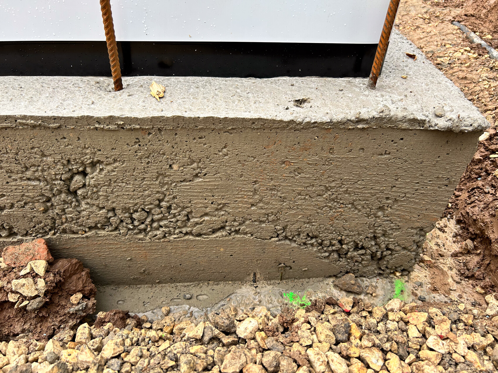

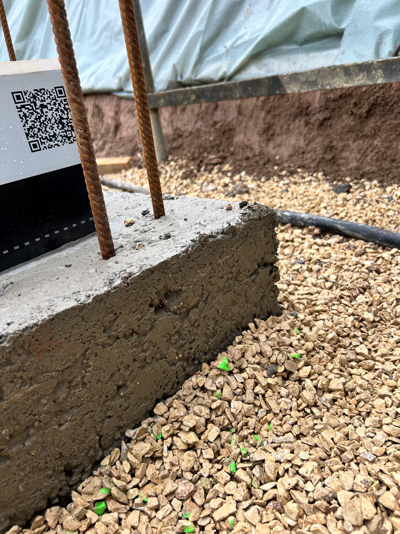

Yesterday, the concrete slab for the basement of our single-family house was poured (not waterproof concrete), and today the formwork was removed.
I noticed that in some areas the concrete is very smooth, while in other places there are larger gravel pockets.
Additionally, some pipes were apparently installed a bit too deep and had to be "exposed," and in one spot a piece of wire is sticking out from the side of the slab.
I would appreciate your assessment whether these are just cosmetic issues or if there are technical concerns.

MachsSelbst6 Dec 2025 10:58Since it’s not waterproof concrete, extensive waterproofing will have to be done anyway. Of course, this would also be done with waterproof concrete. But why not just pour the basement with waterproof concrete from the start? It saves a lot of trouble in the future.
It’s unfortunate that the connections were chiseled out, but the main thing is that the reinforcement was neither damaged nor exposed.
