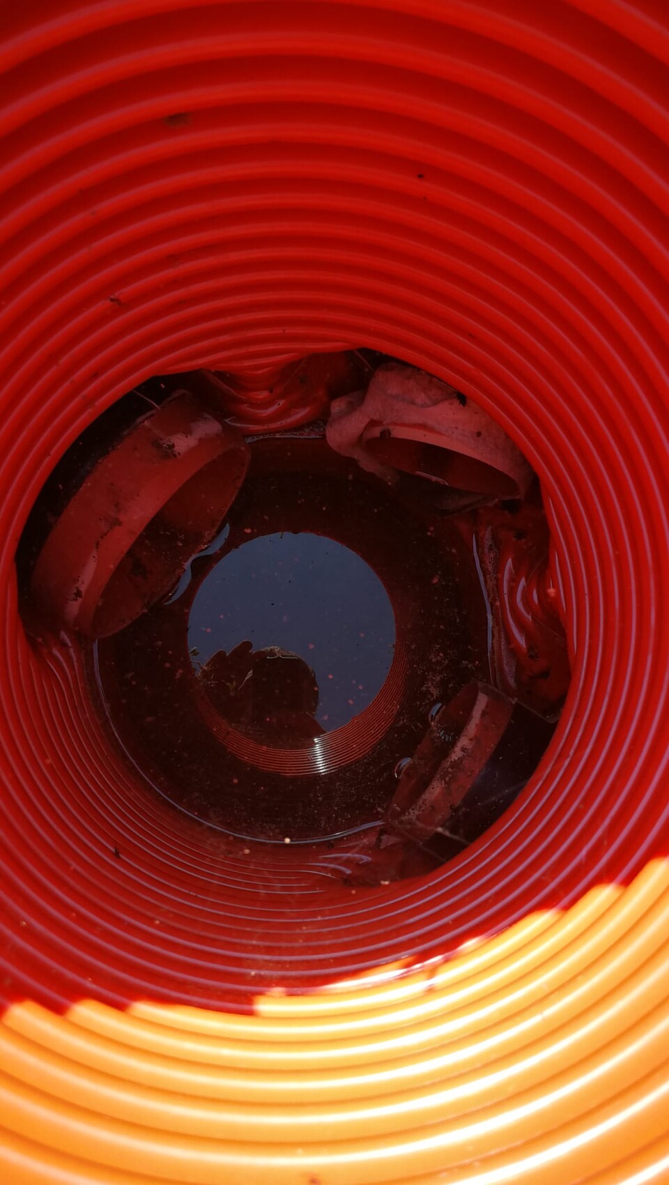

Also, our inspection chambers are different. The neighbors’ chambers basically look directly into the infiltration trench. Mine does not. Here, you see two pipes coming from the house, and the infiltration pipe starts slightly higher up.
So my questions are: Has something been done improperly with mine? Is a vent necessary?

Coletrickle_780819 May 2022 09:09Okay, I’m no expert, but this seems off to me.
1. To me, this is not a soakaway but rather an infiltration shaft. From your description, I understand that the rainwater from your house roof first flows into this shaft, and then, if the volume exceeds the shaft’s capacity, it flows into a soakaway?
2. In my opinion, the supply pipes should be positioned higher to prevent backflow. The pipe leading to the soakaway should be the lowest, so that any water exceeding the shaft’s capacity flows into the soakaway.
But honestly, I’m not an expert on this, so others should provide the final answer.
Coletrickle_780819 May 2022 09:26There are three pipes in this shaft. The two smaller ones come from the house. The larger one then leads into the soakaway.
WilderSueden19 May 2022 09:34So this is simply an access shaft for your drainage system?
