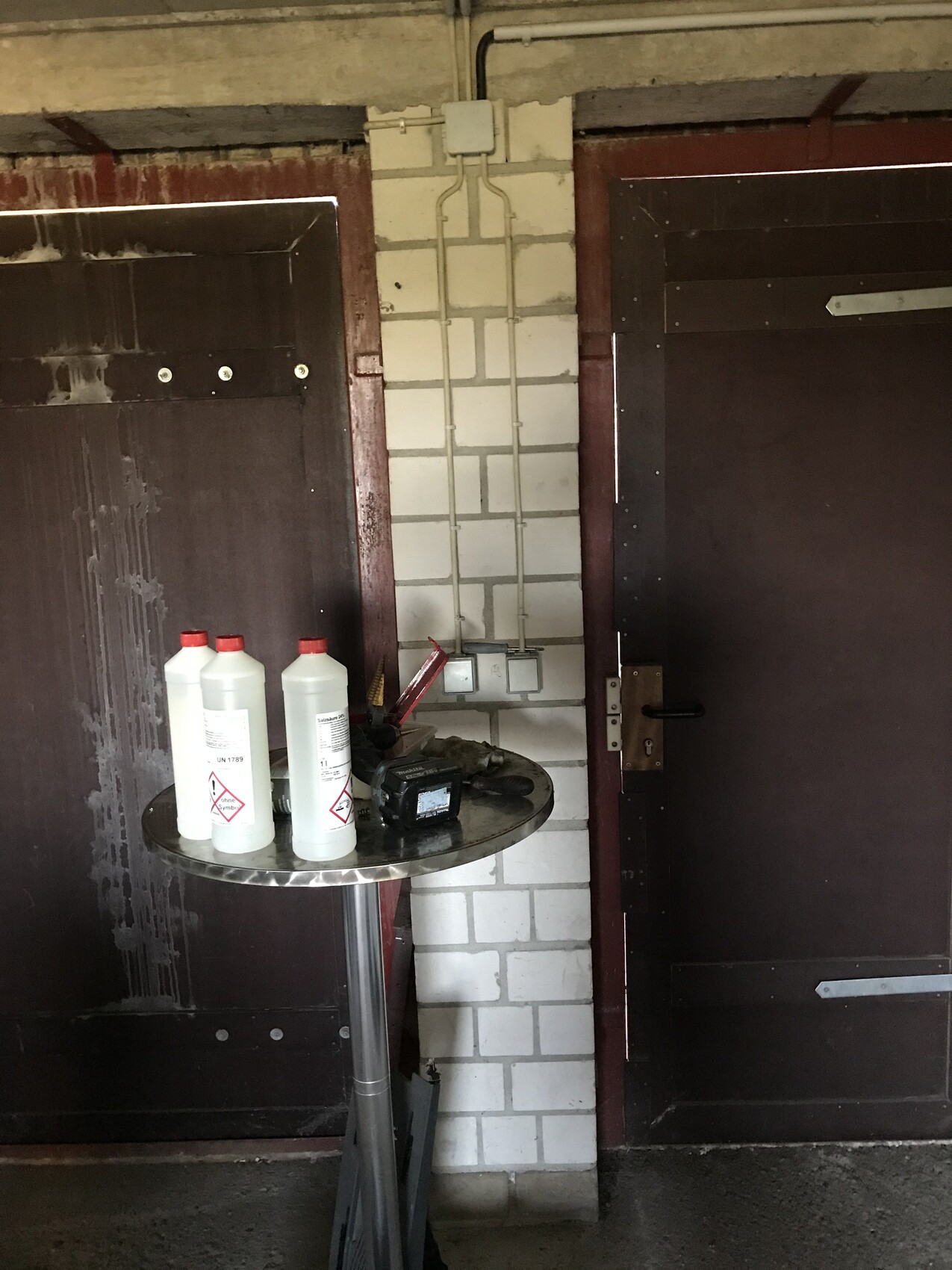

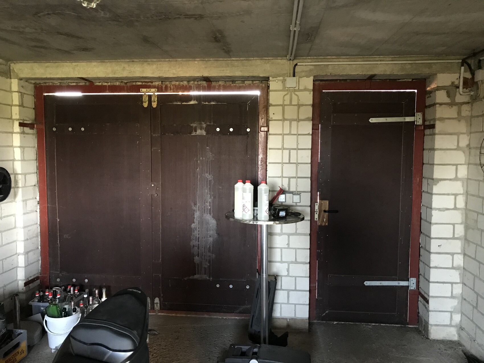

I am currently considering modifying my garage, specifically the garage door. The issue I have right now is that the garage door is too narrow for today’s vehicles. It is 2.29 meters (7 ft 6 in) wide and 2.25 meters (7 ft 5 in) high. Next to the garage door, there is a pedestrian door. The door and the garage door are separated by a narrow pillar that I would like to remove (see attachments).
Do you think it is possible to remove the pillar without major effort? Or is there anything I should keep in mind?
I appreciate any help.

Hello, please spend some money and consult a structural engineer!!!!!! From a distance, I would say it might work if you add support and move the column to the right, at the expense of the door. It looks like the support would continue through and carry the load. But would and could .... It’s very difficult to judge here in the forum.

The pillar can be chiseled out in a few minutes with a good tool; it’s not a big deal. However, I would feel uncomfortable doing this without expert advice. The load changes significantly.

Please consult a structural engineer. I suspect that you will need to install a beam at the top.
